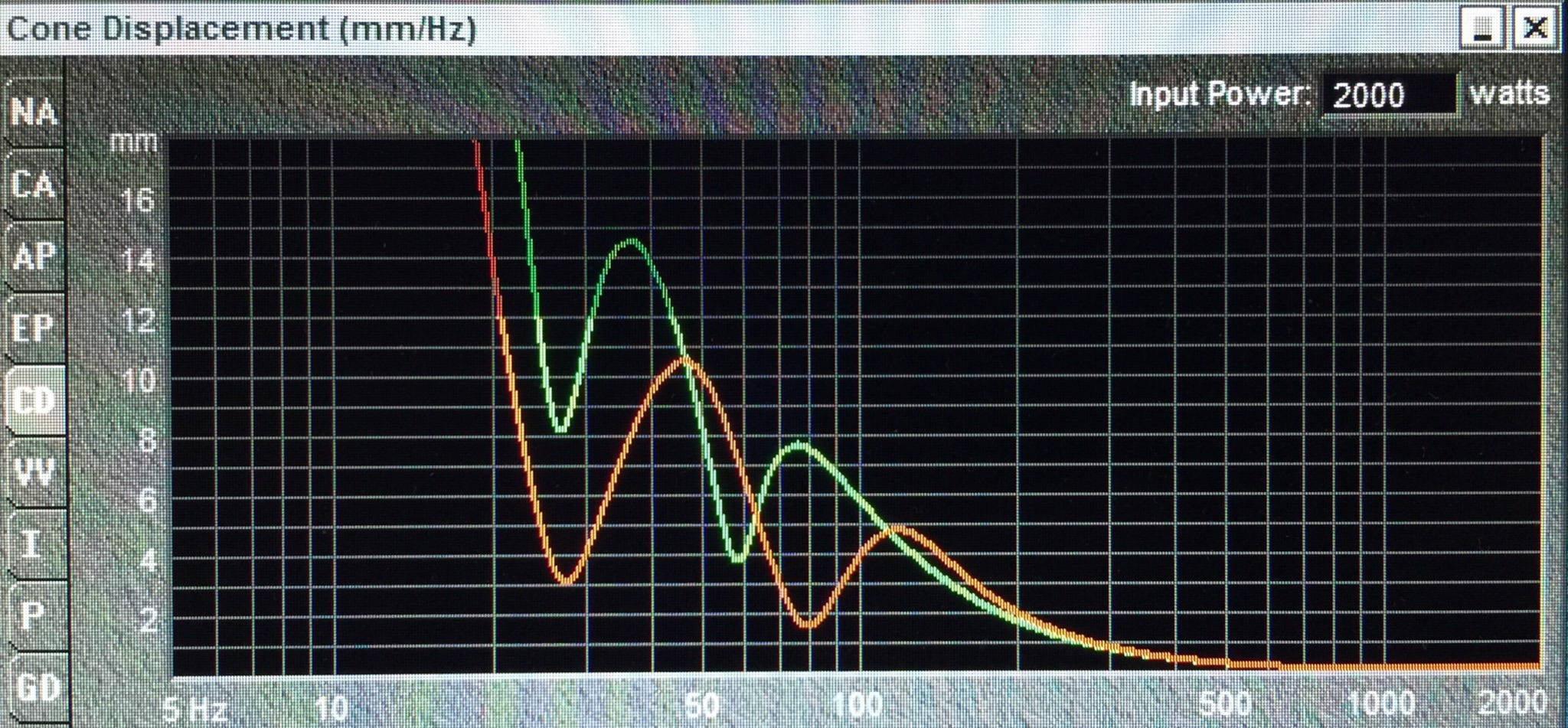

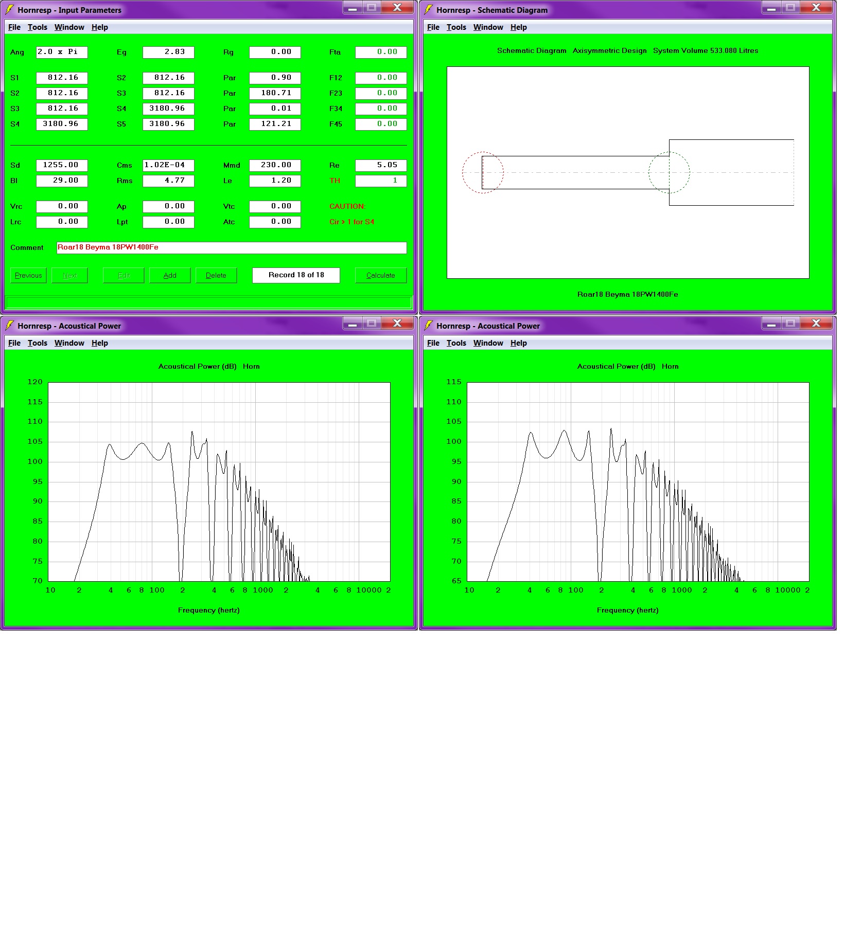

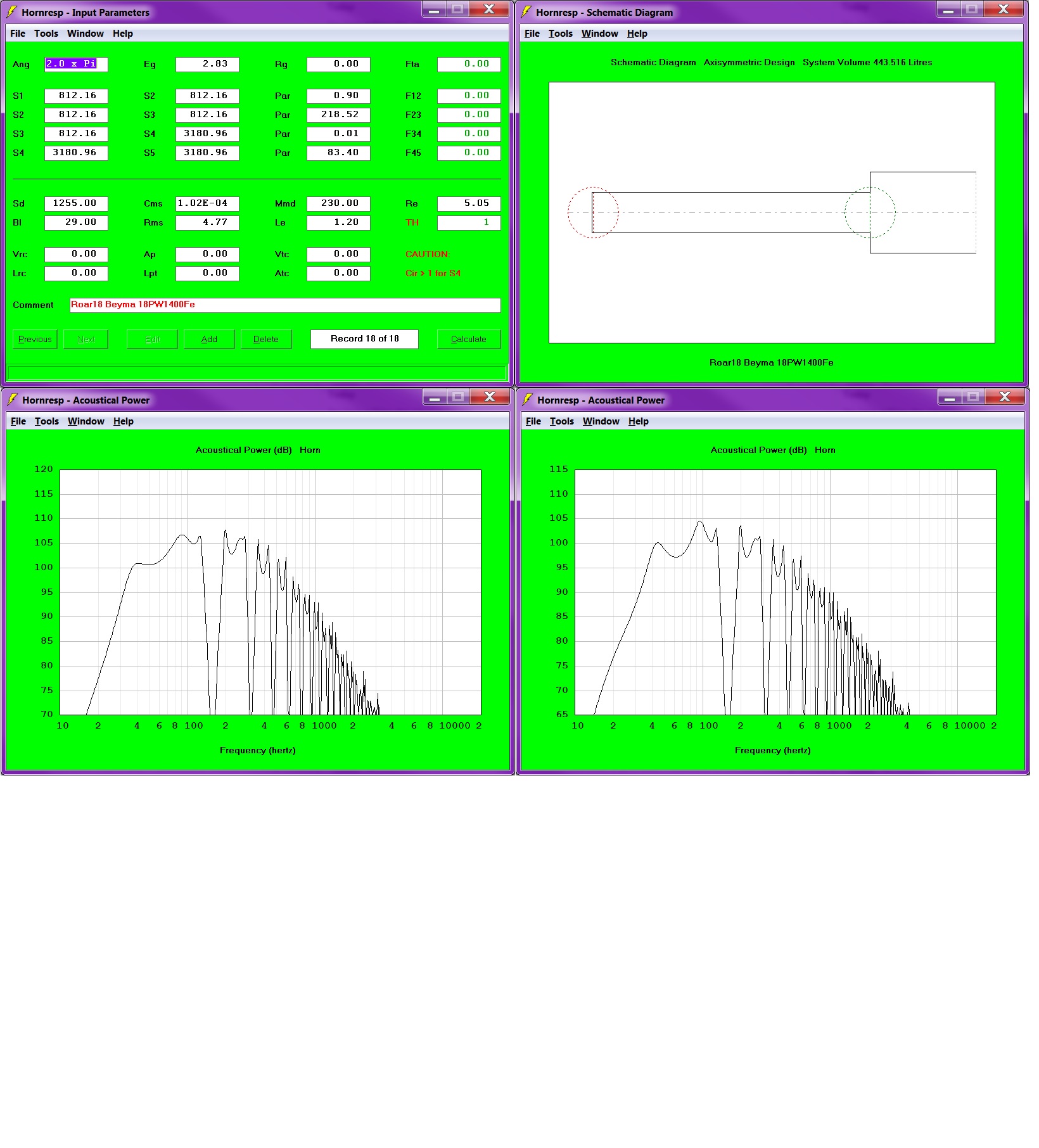

I see L34 as a "rubbery/flexible" section. The sim does not change much with a shorter or longer L34. I use the distance from the end of the tapped pipe section to the center of the cone/voicecoil as a guesstimate length. It is not an issue in real life. You don't create a great design by creating a perfect match between a theoretical and greatly simplified mathematical simulation and a measured response.
I judge my designs based on real life performance.
Johannes
L34 does have to be set to 0.01.
YOUR S3-S4 volume needs to be added to S2-S3 or S4-S5.
I cheated and added YOUR L34 to L23 in pic 1 and to L45 in pic 2.
I doubled Re from 5.05 to 10.10 in both 2nd graphs.
Great to see someone brave enough to make some sawdust instead of endless theoretical bickering!

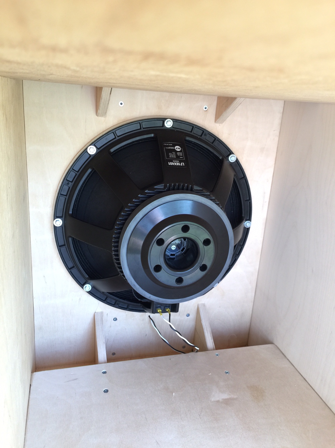

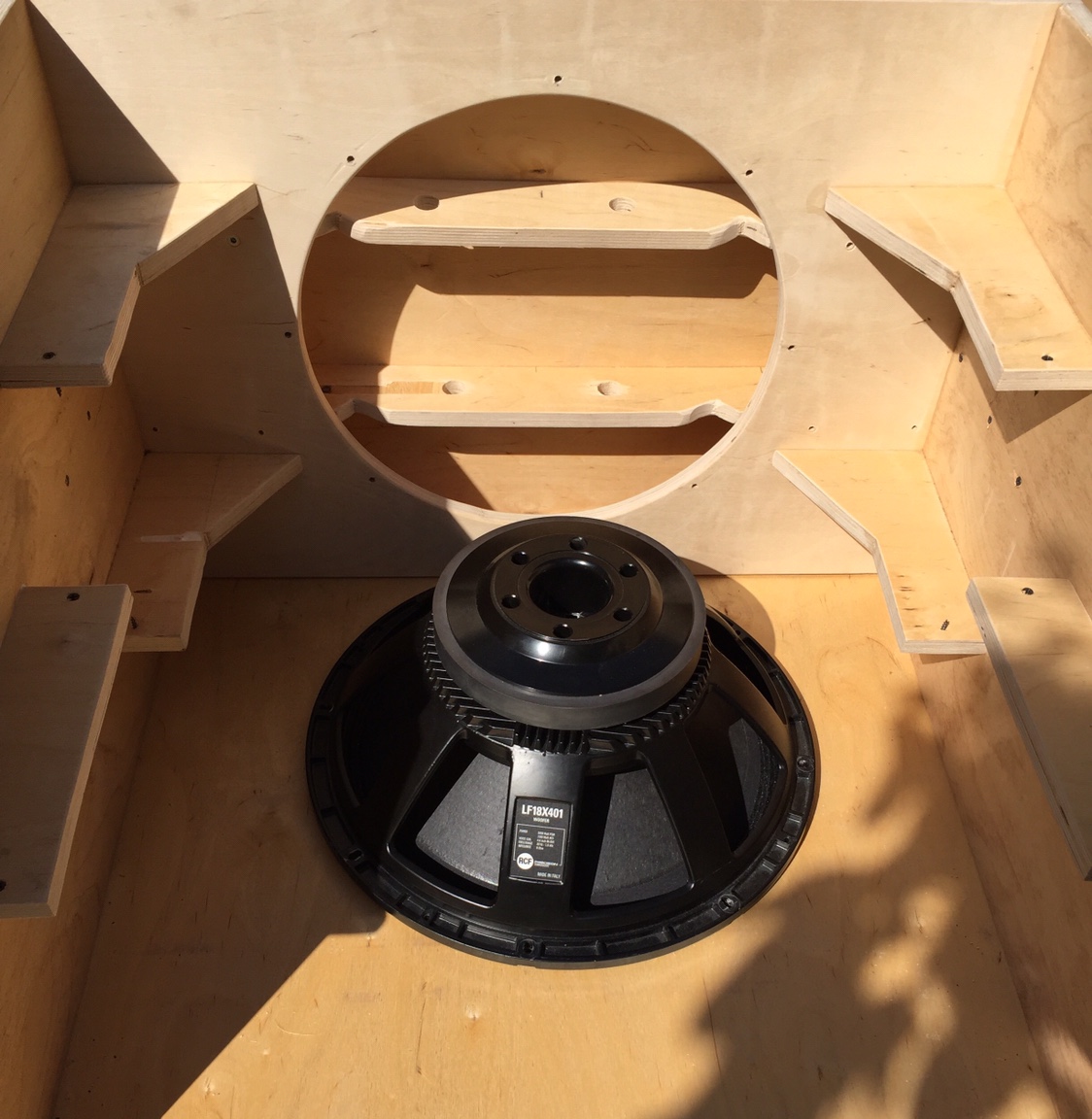

If you still have the possibility I would suggest making the holes in the two braces bigger in diameter and perhaps increase the number of holes to increase the air flow, this is only a suggestion and I'm not sure it is necessary, you decide, and I'm very grateful that you share your work, looks good, thank you!
The transition from the tapped pipe to the front-resonator is a quite complex area. If you measure the distance on the plans or in a real ROAR you will see that there is a real physical distance from the end of the tapped pipe to the center of the driver. Due to the quite intense pressure from the front-resonator the exit of the tapped pipe section "sees" a more narrow angle then the physical 90 degree corners where it exits into the front-resonator.
I have found it equally wrong to use 0.1 cm as 25 cm as L34 in the ROAR12.
Real world measurements tend to show something in the middle of the two. Since Hornresp uses very simplified mathematical models I don't see the need to obsess over the exact correlation between the sims and the real world results.

I did a lot of tests with FLH and TH prototypes using large holes in braces or no holes at all.
Holes are only needed if braces are blocking the soundwave direction or are so huge that it does damage to the required internal volume.
In this case I see no problem because the soundwaves are being directed horizontally anyway. Braces placed in 'flow' with the soundwave direction.
Hi, Mr. Martinsson!
There are a 20-50-70 mm free space between the brackets and the driver cone, so i choosed to pick up most of the available stiffness. Little V-shaped cutouts in the brackets are needed in the case of long-throw drivers.
If you saw i also choosed to use slightly modified bracketing matrix, the driver panel are clamped by four perpendicular brackets.

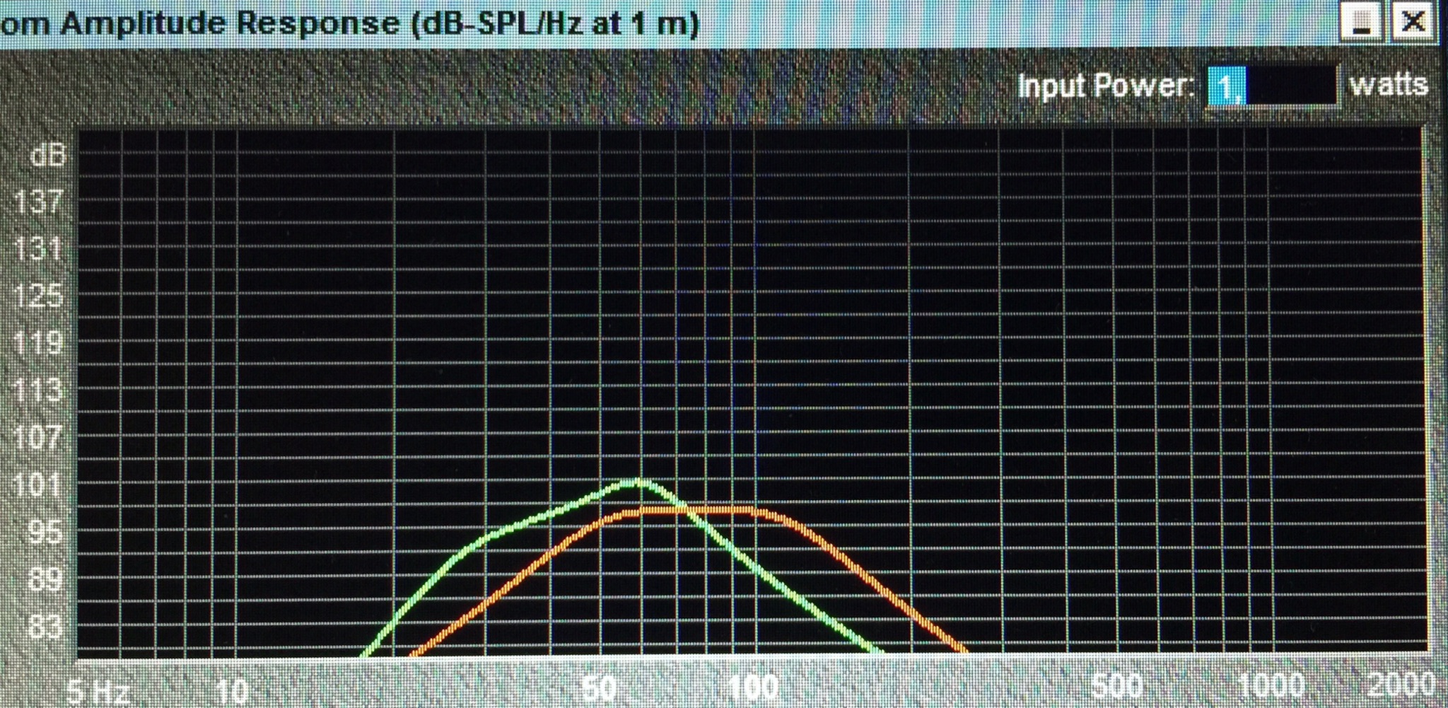

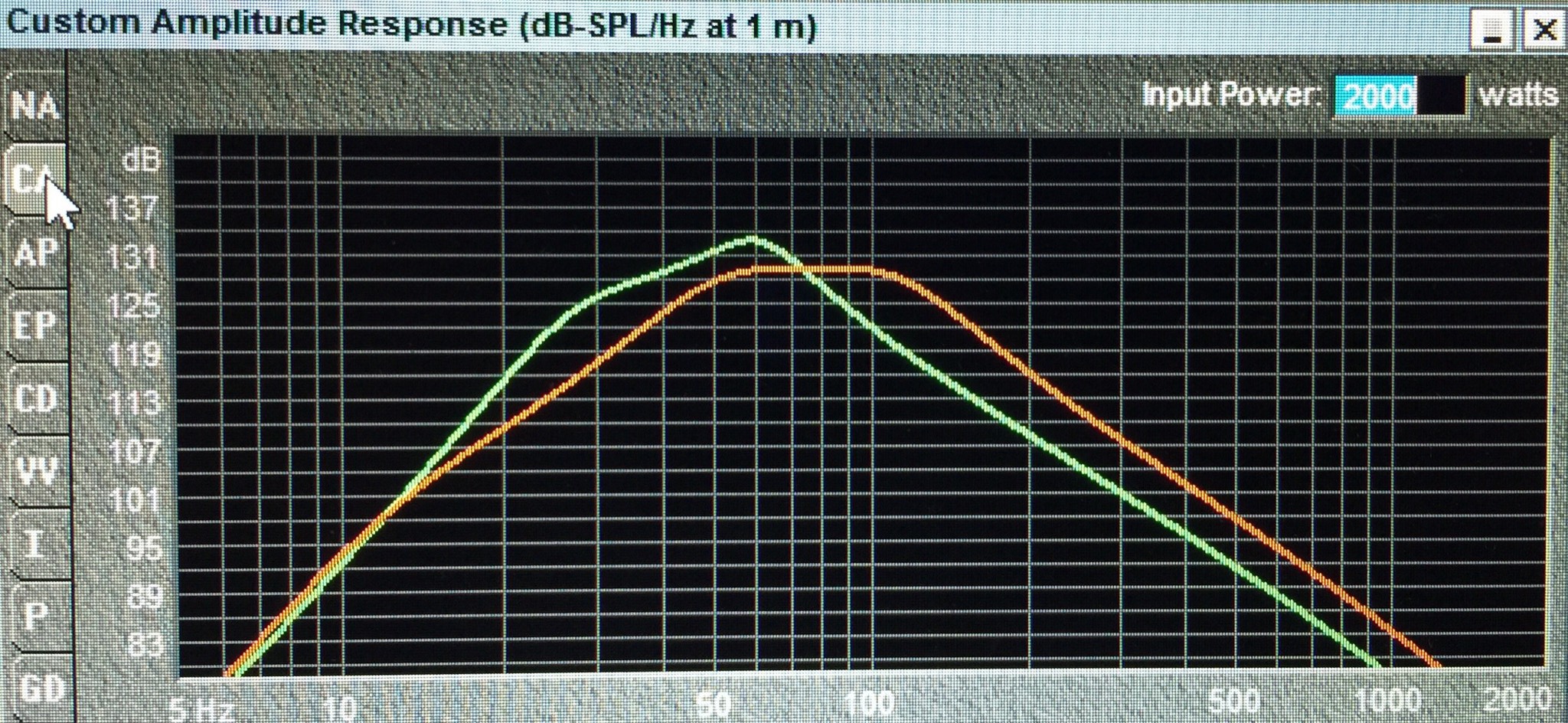

But why different sims shows different results?
For example, this 6-order series box can be calculated in BassBox with that results:
Green colour - ROAR18, red colour - suggested BassBox optimum.

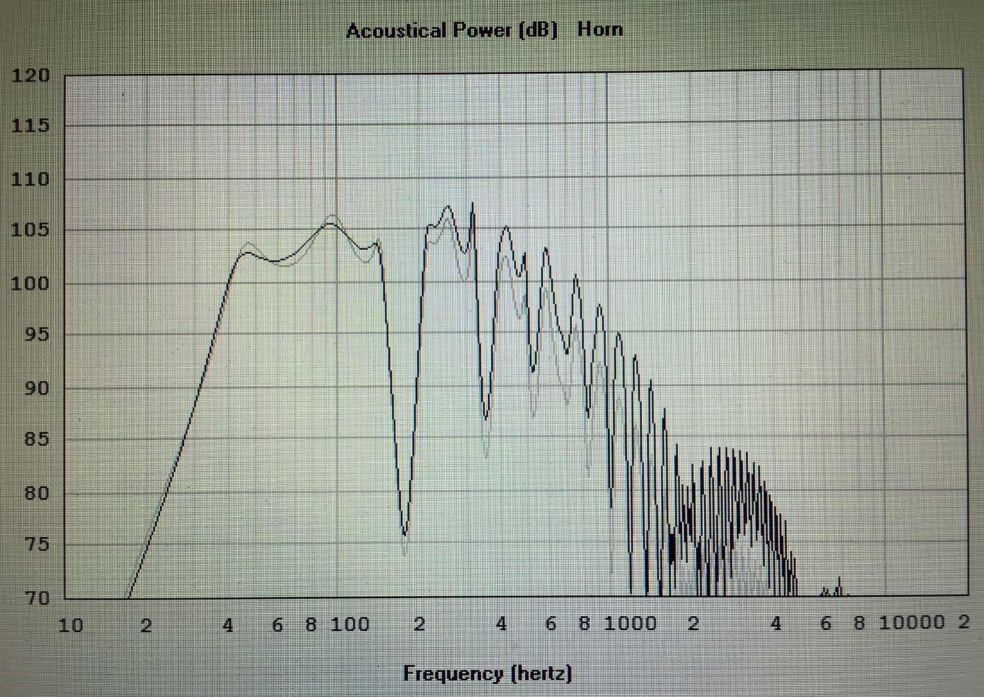

I remodelled the "Roar18" and used the volume per segment method, advanced centre-line and cone-volume to increase accuracy. Used also a slightly different method for the symmetric split-path, that gave me better results in previous projects.
Djim

Thank you for taking the time and efforts to dive deeper into the design, it's greatly appreciated.I remodelled the "Roar18" and used the volume per segment method, advanced centre-line and cone-volume to increase accuracy. Used also a slightly different method for the symmetric split-path, that gave me better results in previous projects.
A couple of questions.
Regarding the front resonator length, this is a tricky area, how do we best describe the resonator function? to my mind (not saying that I'm right) is to look at the length of the volume establishing the resonance, that would be distance between the driver baffle and the aperture, 83,4cm.
If one shortens the front resonator length in the simulation the sensitivity would shift to the upper end of the passband, as per you simulation.
Personally I'm not sure which of these interpretations is correct, maybe the truth is somewhere in between the two.
Another interesting take in you interpretation is the S1-S2 distance (L12) that goes from the center of the driver to the edge, this is also a bit of a tricky area, and again I'm not sure which way is the correct one, but it is good to see other was of looking at the system.
I will have a closer look at the work you have done within short, very interesting, thank you, br / Anders

Looking at the layout of the ROAR, I don't think that S1-S2 length is correct in your sim - should be more like 0.1cm as per the alternate suggestion, as the center of the driver is right over the start of the path. The cone volume can be modeled using Atc and Vtc (set Atc to be the driver's Sd). The baffle cutout for the driver can also be modelled by setting Ap1 and Lp (Lp=baffle thickness and Ap1=Sd of the cutout).
I also think that the "advanced centerline" method loses some accuracy when you have rapid expansions around a corner as is the case here with that last corner before the driver, but it's better than nothing here. To be honest, if I was doing this design, I wouldn't use so many non-expanding sections - looking at it, it should only take a few minor tweaks to convert it to a single-expansion TH with a smooth expansion from S1 to S4, by mounting the internal panels at a slight angle to the path and adjusting their lengths accordingly. And then I'd be pretty sure that what I sim is what I get. In fact, looking even closer at it, it should be possible to convert it to a dual expansion TH with the driver at S3 instead of S4, but a bit more path length would be lost in the process.

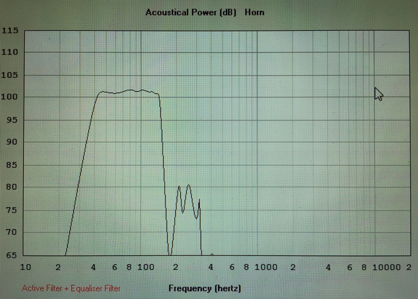

Second impression was taken after DBX AutoEQ with RTA Mic. Fast, deep, uncoloured bass, true without long wooooofff like some bandpasses do.
I've checked DBX parametric EQ settings in Hornresp and found this:
Without EQ'ing bass was track-dependant, some tracks bass fell into dips, some tracks hits the peak.
Saying in different words, some tracks has pressed guts out and the eggs shrank from fear, some tracks sounded unconvinced and poorly.
The one of the best i've found is this:
Master of Tides - Lindsey Stirling - YouTube
What were the DBX parametric EQ settings used to flatten the response?
The response at the upper end of the passband drops like a rock. I've tried using EQ settings that resulted in a response like that between 100 Hz and 200 Hz for my subwoofers. I didn't like the results at all.
