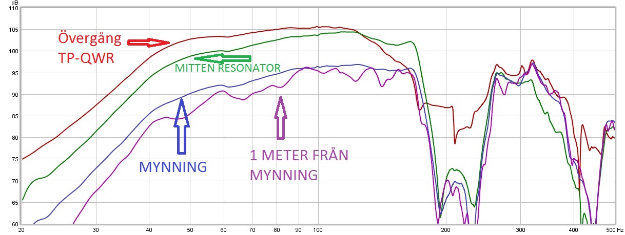

The blue line is with the microphone in the mouth of the ROAR12.
The red line is with the microphone at the exit of the tapped pipe section at the bottom of the front-resonator.
If the measurement was taken with the microphone in the mouth of the horn, that could tend to exaggerate its LF performance. I'm guessing that the purple line is a 1M measurement of the same horn? If so, the faster drop-off in FR is noticeable when you compare both lines on the graph. For my TH measurements, I've found that backing the mike off a bit so that it's about the same distance from the mouth as the effective radius of the mouth gives results that are a little more realistic without letting too much of the room get into the measurement. Some experimentation is required to get the best results though.
Measuring FR at various points *inside* the horn can be a illuminating exercise. I did the same thing with my THAM-like build, and the results eventually led to the "dogfood duct" "fix" I came up with to deal with the midbass notch in the THAM's response.
The ROAR12's "notch" is a pretty sharp one, but it's up @200 Hz, so it's a likely a bit less problematic than other alignments that have such a notch appearing considerably lower.
Interesting point on the symmetrical loading of the driver, BTW. I find it curious though that apparently none of the techniques used in car audio drivers to strengthen the driver's cone all the way up to its edge (where asymmetrical loading IMO will most likely lead to failure) haven't found their way to the pro audio subwoofer world. These include flattening the edge (Image Dynamics) or folding it back (JBL, Infinity), or even changing the entire geometry of the cone (Kicker Comp series). Maybe the problem isn't that significant?
What's the lowest resonant frequency of the ROAR12? What about its impedance curve? Comparing those two against the HornResp sim for it should give a pretty good idea of how close the sim matches the built system.
Yes, the purple line is at one meter from the mouth.
The driver is brand new and raw and I expect more LF performance once the driver has a few hours of a few hundred watts of workout. My neighbors protest whenever I fire up my old trusty QSC-amp for some nice punchy bass, so it might take a while before I can do proper measurements.

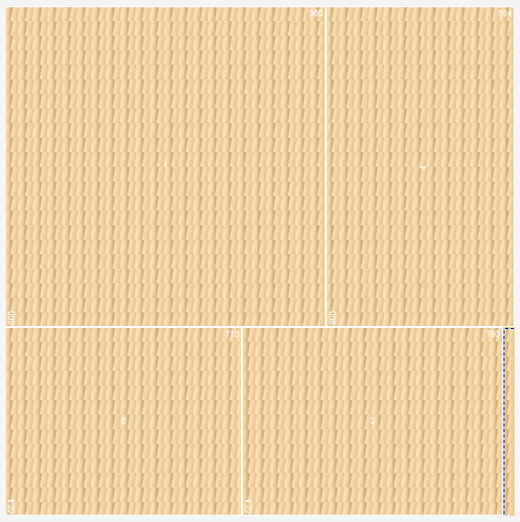

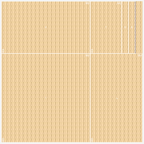

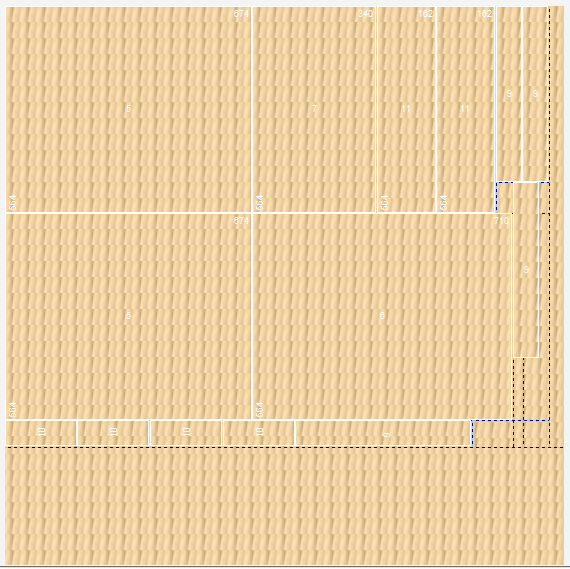

Hi, martinsson, am i right suggesting this kind of cutting for 1,5x1,5 meter sheets?

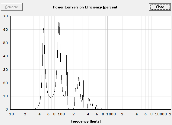

With my 18" drivers this bin could provide very good power conversion efficiency.

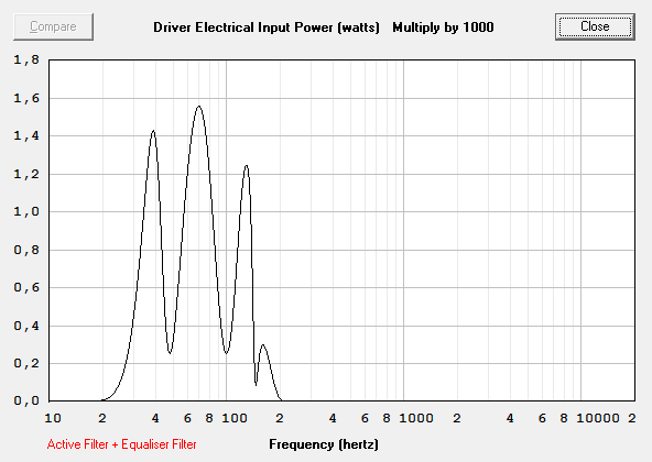

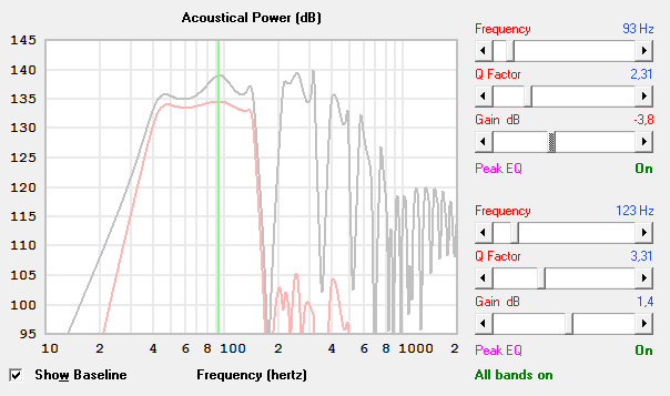

Frequency response can be easily corrected with Driverack PA. First parametric filter tuned up to -3,8 dB at 93 Hz, so there are a plenty of headroom for bass tweak.

It's a bit difficult to make out the numbers in your cut sheet images
Yup... That's very simple cutting software, so let's check with school arithmetics.
960 mm (height of outer panels) + 564 mm (internal panels width) = 1524 mm
We just need cutting table with 1-1,5 mm thick saw, one cut and we're in.
Assume ply sheets are really square and precisely cutted at the factory.

It has been stated in this discussion that the response which these cabinets produce is more smooth than what is shown in the Hornresp simulation ... Johannes from post#14 believes that this is related to frictional losses ....
If we take a look at the graph from post#20 we can see that there is a purple 1m trace of the ROAR12 .... We would expect to recognize the 3 peaks which form the W shaped curve shown in the Hornresp model but for some reason those peaks are absent in the measured curve .... The real world response is indeed more smooth than what we see in Hornresp, just as the gentlemen in Sweden have observed ...................
In the simulation it is those dips in the W shaped curve that become exaggerated when the model's "Re" value is raised to emulate thermal power compression right?
Ok .... So here is the question we should be asking then:
If in the real world we are not starting off with any W shaped curve at all, will we still end up with the exaggerated W shape in the curve that Hornresp suggests when the driver is pushed hard enough to heat up the voicecoil??? I would assume not, considering the smooth curve that we are starting off with in the measurements, but who knows(?) ..... I imagine that the result would be less peaky and less exaggerated than what Hornresp is suggesting with power compression ...
In order to answer this question it would be great to see someone take measurements at very low power (1w-ish) and then overlay another measurement at very high power with the microphone at least 1 meter away for both measurements ....... This way we can see what sort of changes take place in the curve at the different power levels ..
Circlomanen, Martinsson, BesPav, do you guys think it might be possible to get someone to take such a measurement? It would be very helpful ....
This cab has NEVER been measured. The 12 inch version that was measured was not simulated properly AND not measured properly. I would consider a proper measurement to be an outside measurement at a distance of at least 2 meters. So any discussion of the frequency response or the measurements or the sims of either this cab or the 12 inch version are completely moot. They will continue to be so until the cab is properly simulated and measured.
I'm not sure that simply adding Re to the sim is a completely accurate way to estimate power compression - but it's the only tool we have available. When you add Re the same thing ALWAYS happens - the frequency response "melts" away leaving spikes where the impedance peaks are. If you add enough Re the frequency response will look a lot like the impedance curve.
It's not enough to have a low compression ratio and claim that a design is going to excel at high power levels. There's a lot more to it than that.
Brian is correct that due to the fanlike cooling of the motor in tapped horns that power compression won't be as much of an issue as with other designs. But Danley designs for an underdamped response for a reason - it WILL stand up to abuse much better than an overdamped design, and he is in the business of making products that are routinely abused. If you don't intend to abuse the design you don't need it to be all that underdamped at all. BUT in this case the designers are making the claim specifically that their cab is meant to be abused at high power levels and claiming it will excel. It won't.
It's not completely accurate (I suspect compliance is also affected as the soft parts like the spider heat up), but it does get the sim a bit closer to what response would be like when power compression is happening, so it's better than NOT doing it. The trick here is determining how much additional Re needs to be added to sim what you're tryin to sim, which would mean knowing what the voice coil temperature would be like under the "high power" conditions you expect the system to see.

The start/bottom of the front quarter-wave resonator is a very interesting area. There seems to be a lof of different things going on there that Hornresp does not simulate properly. The L34 is just another crude simplified mathematical approximation of a much more complex real life series of interdependent events.

The ROAR is a series-tuned 6th order bandpass design. It exchanges Helmholtz-resonators for quarter-wave resonators to increase radiating surface and the bandwidth of the resonators. I have been following your thread "New sub design? Constricted Transflex, simple build (series tuned 6th order)" for some time, and I must thank you for a lot if interesting ideas and simulations.

The front-resonator is sized and tuned to give a small peak in the midbass response (70 - 100 Hz). I really don't like the dip many tapped horns have in this region. This is partly why we (me and Anders Martinsson) tuned the THAM series of tapped horns slightly higher then normal.
