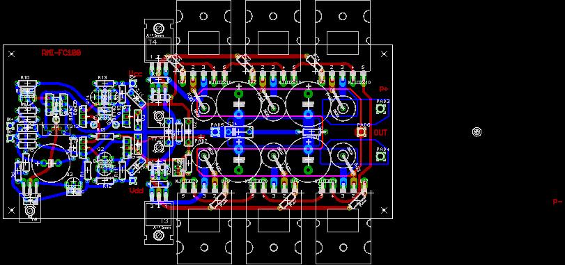

Here's my latest layout.
Due to the size and orientation of my heatsinks, I have to remove the big filter caps from the amp board. Also, I left more room for C21.
Mihai, or anyone else, please let me know if you see anything wrong.
I'm not sure if I make PCB myself, or I send it out to have the board made professionally.
