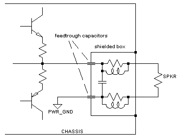

For power amps, one can split the output L//R in two halves, one at each line (wether it be GND or not) with small caps (a few pF) right at both points to the metal chassis, after the L//R (viewn from speaker side). This keeps common mode speaker line EMI away from the output.
- Klaus
Hello Klaus,
Can you be more specific please?
Thanks,
Mihai

Spkr line RFI filter
Mihai, pls see attachment. The importing thing is that it must be RF-proof, one needs to build the output L//R into a shielded box and one must use feedtrough-capacitors (like these), otherwise it's not completely efficient. This also implies a completely RF-proof metal case in general, and also similar input filtering (signal inputs and mains input). To really make it RF-proof is a lot of work, and not everybody will need this level of protection.
The amp must be able to handle the load capacitance, of course.
- Klaus

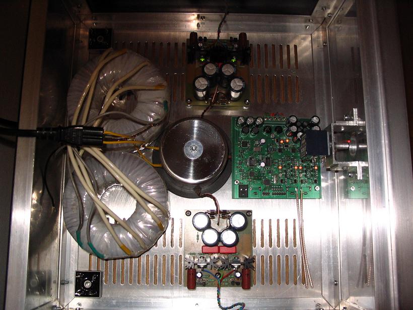

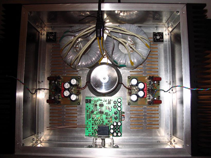

Roender, Have you thought about mouning them vertical on the front wall. Also, On one of the transformer websites they discuss using epoxy to partially mount the screw to the toroid. It is a very nice arrangement. You could also mount the bridge rectifiers to the front and have plenty of space for isolation from the board components. Tad
