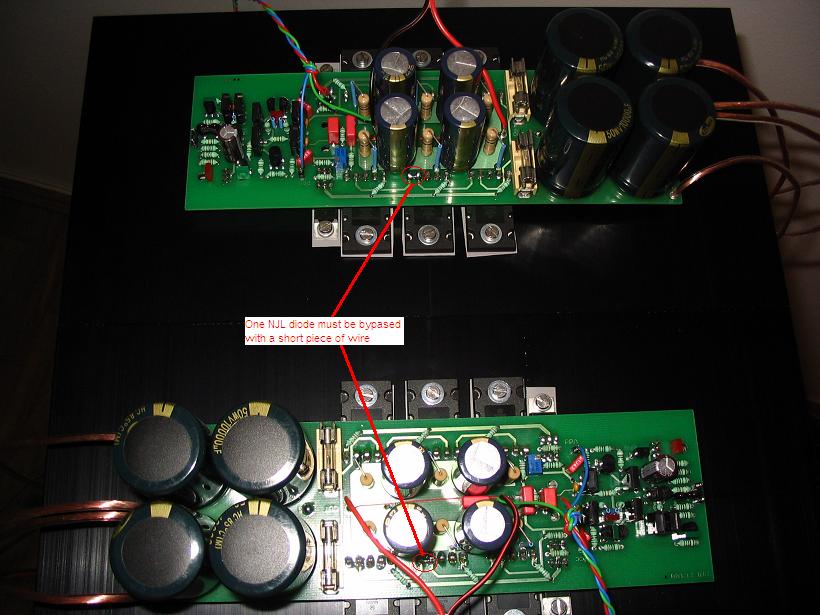

Roender, The original schematic at the beginning of the post only shows 5 of the thermal trac diodes connected in the diode string. Where is the sixth thermal trac diode connected? Tad
Roender, what's the spec for D7 and D8 in your front end power supply?

niner said:Roender, what's the spec for D7 and D8 in your front end power supply?

Hi niner,
I make a little mistake in the frontend PSU BOM, it is a 36V zener diode, not 39V.
Thanks,
Mihai

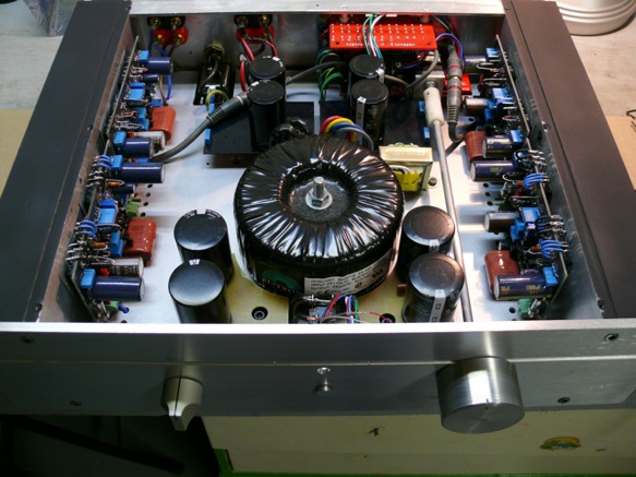

I have most of parts in my procession. Only things I need is PCBs and transformers. Hopefully I can start the build in a week.

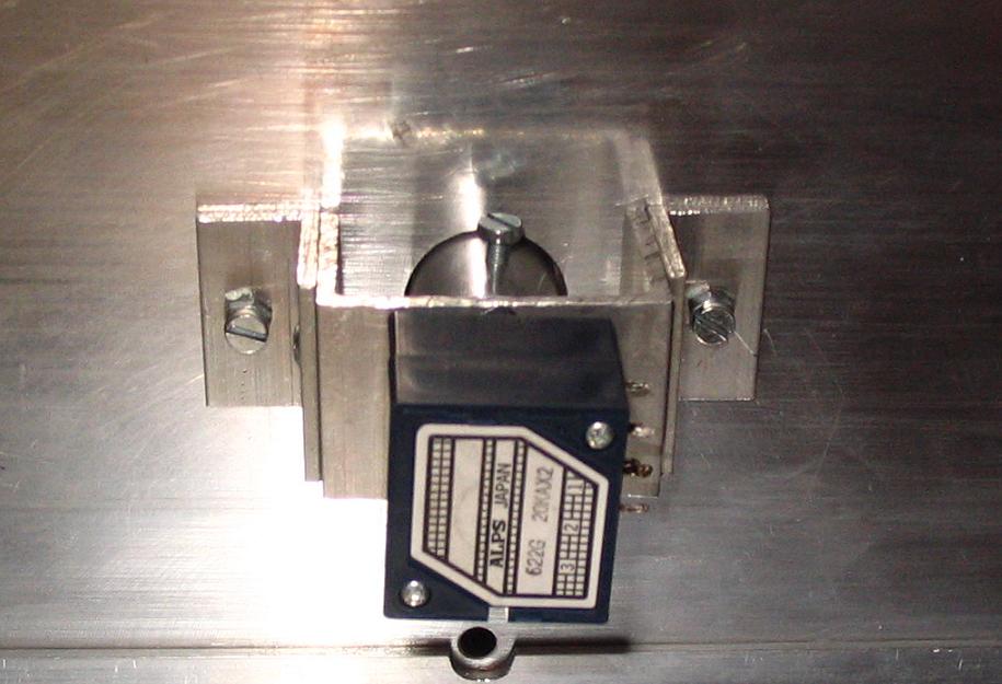

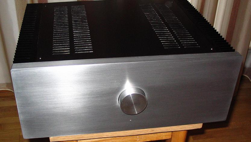

DRZ1 said:Roender , very good job.
why not mounting the pot at the back and use a extention rod ? I do it like that with my Symasym.
Personaly i prefer black.
Thank you Denis
Your case is very nice too.
I will put a DAC inside, monted in front of the case and very close to the volume pot.
This amplifier will have digital inputs only.
Mihai
