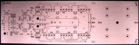

loek said:
I made this board with a millingmachine.
Now collecting parts.Happy 2008,
Loek
Hello Loek,
Don't worry about outside PCB dimensions holes. Two of them are from drivers, mje15034/mje15035, and are not in use.
I'm not sure if it is safe to implement ground plane. In the first stage, when you start the amplifier, try to not connect the plane to ground. See how it works and after that try to find a good point to connect such a huge plane to GND, maybe in main starground. Use a scope to track possible oscillations
Good luck and
Happy New Year!
Mihai

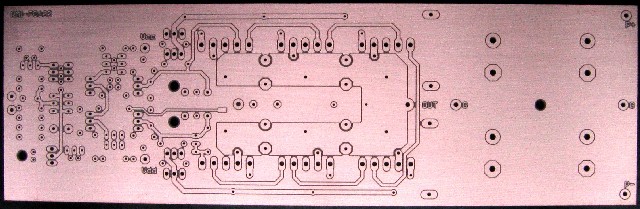

After many hours of hard work, I've build another one for a friend of mine.
Transistors are not very well matched as in my versions - Carlos was wright about matching, offset is -2mV but sound the same as mine.
