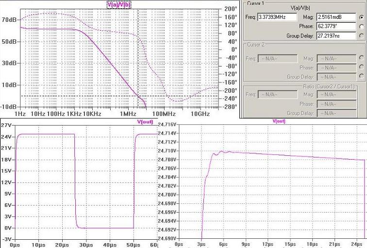

Sparkle,
Don't worry, it is rock stable.
Look at the Bode diagram, more than 60grd phase margin!
In real world, I've tested with sin 10khz 10Wrms in 8ohm||1uF. No smoke at all!
Mihai
ps. Did you receive the LTspice project and library files? You could simulate it extensively and learn a lot of things.
Mihai

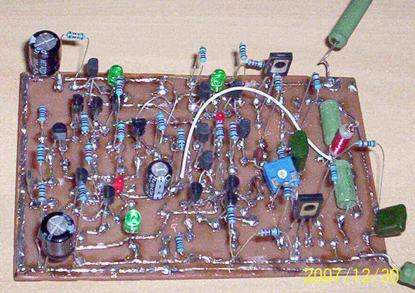

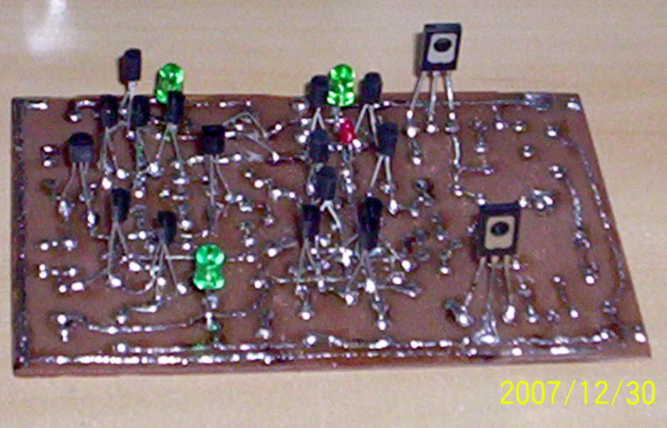

I have made my fast board for Mihai amplifier
The output is not the same...it is mine output.
Yes, i know Roender output is much more linear than the others, superior...i know that...but also i know how much better it is.
What i really want to know, to listen, to feel, is his input...the differences of his input.
Because of that, i am keeping an output i already know, that will sacrifice linearity and dinamics...i know that...will not let the input give all it can make.... but i want to see the input into my own output.... Mihai input advantages will be perceived.
Latter.... after conclude things (confirm the better quality and knowing HOW MUCH is better) i will try Roender hiper Linear output.
The input Linearity is what i wanna feel for a while in my first step.
The board has a lot of jumpers....not pretty, not perfect, but for sure will work and have small connections, length is small..capacitances between lines not big too (distance is big from one copper line to the one runs near) and i will check for shorts in advance the construction.
Soon i will have, the special pleasure, to listen this excelent design.
I suggest you to do the same.... folks...move your "s" and hands on work!
Do not be waiting for me to post evaluations... will tell Mihai directly...because i cannot post things with the modifications i have made..if you wanna know how this amplifier sounds..MOVE!
Mihai...i will follow your instructions.

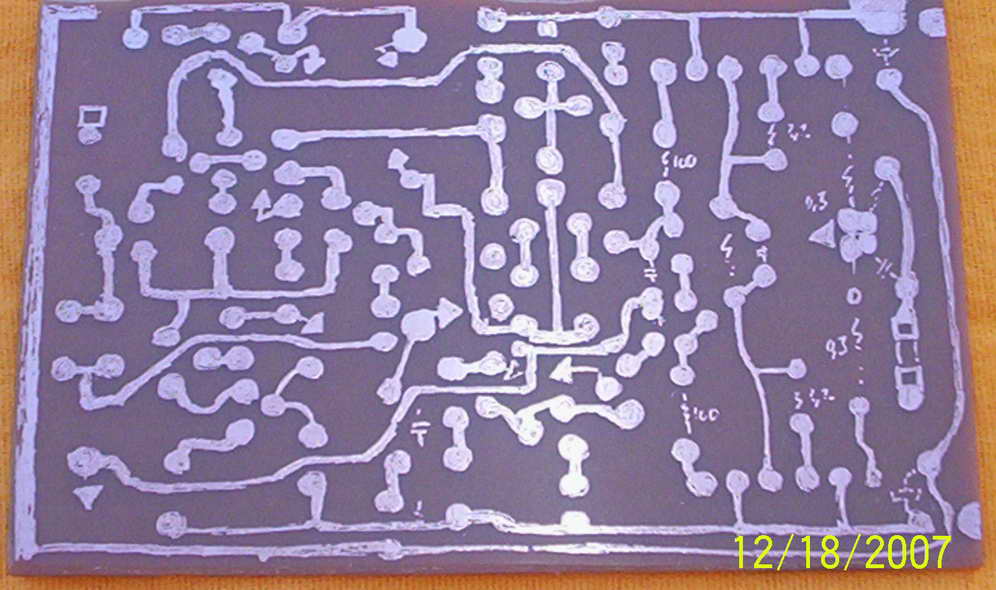

Yes, there are always errors, more will appear during the construction
During the construction i use to go following the schematic and drawing in red over the connections made.... the moment of construction is also the moment when i face problems with the board.... all errors use to appear during that moment.
To go covering parts and connection lines allows me to check all connections if made and if rigth or wrong... and this is the advantage to construct into the copper side...as you could see, the amplifier interconnection lines are all there.... some missed are made using wire jumpers and you will see arrows showing those points.
Do not worry, at the end everything will be correctly connected.... i am doing this way, and always facing my errors during those last 46 years..... and the errors happens because i use to produce (to paint) the copper boards spending 10 or 15 minutes....a fast work, the way i like to make, and because fast, dirty and not precise...and i do not bother because during the construction, the assemble...everything will be fixed and will receive double check, or tripple check...will receive ohms measurement, resistance measurement from plus to minus, from plus to ground and from minus to ground and the same operation repeated with ohmeter probes inverted.
Also i use protective resistances during the set up and i use to check all transistors VBEs during the check up.... this way, wrong things appear showing strange measurements...not usual, no common measurements.
Thanks by your worries and concerns...but my method of work is really strange....not precise...too much fast..very dirty...a little stupid.... non sense...but WORKS!
Man...i do not deserve all your worries.... i will do so big mess with your schematic that you would be very angry with me.

Man!.... this unit really sounds great!!!!
I had some plaft, pow!... puff and pohff.
Have used wrong transistor and error into the board...very normal to me to do that.
But dancing, and singing...and happy....hairs into my arms are stand...feeling good.
What a nice amplifier.
Deep congratulations, double congratulations...great Mihai.
Doctor Roender from now on.
I can imagine how good it will be with the circuit respected into the details..... excelent unit..... very, very, very, very good sonics.
this is not the last image, the amplifier now is playing with output parts and more ugly because my mistakes made some fire on it..ahahahahha...good that.... even after fire it sounds excelent!
Remembers me the Symassym.... a little bit better, but the dinamics is the same (using class AB and 39 volts each rail..output is classical, very simple)
Yeah!...i know it can sound better than that...of course....but you know?... i am satisfied.
