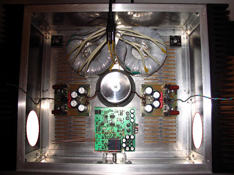

Roender, Have you thought about mouning them vertical on the front wall.
You could also mount the bridge rectifiers to the front and have plenty of space for isolation from the board components. Tad
Thank you Tad,
All the low signal components are in the front of the case(please see the attached picture).
The only suitable position for power transformers is in the back of the case, but how should I put them, in vertical or in horizontal position?
Mihai

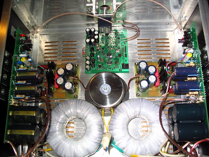

roender said:
Thank you Tad,
Mihai
Neither - right now. Build it up and test to make sure you can adjust to a position that doesn't introduce any noise from leakage. Toroid leakage is supposed to be mainly aligned with the center of the toroid, but also comes from gaps in the windings where the wires exit.
Sheldon
Hi Roender
Regarding position for transformers:
Keep them horizontal and move to the front.
Regarding volume pot:
Mount the pot at the back and use a extension rod (like DRZ1).
Use the same mounting support, just rotate pot for 180º.
After this the pot will be "inside" mounting support.

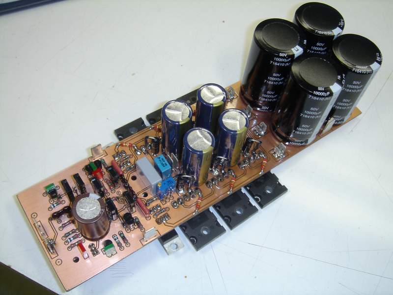

Mihai, it's up and running 😀
Look good at first attempt.
Offset < 2mv , Rise time > 30V uS , Square Wave at 10Khz = superb compensation look very good.
It just running at 25 V on the front end.
Now the Power Supply, I have a good Plitron 400VA 30-30 , is it to high For the PA ? I thing yes and i imagine that the front end must be raised to in the same order, what the limit ? so .....

Bravo Denis!
I'm glad that your amp is up and running.
Well, 42V DC seems to high for RMI-FC100 output stage, at least for 1W class A bias current but can be done if you have a big heatsink. There is enough SOA margin for 42V output voltage.
The front stage was tested for 38V only and if you want to increase the voltage you must add 5V over output stage voltage but I think it is to high (47V) and you need to add small heatsinks on cascode LTP transistors.
Please tell me how it sound?

Re: Hi Roender
MaxS said:
Hello,
I remember in DPA ( a.k.a. Upupa Epops here ) design the use of two transformers . Because It is your case too, I 'll propose you this solution. The example is in the following image.
http://www.hometheaterhifi.com/volume_6_4/images/feature-article-czech-republic-dp-amplifier.jpg

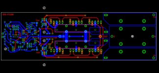

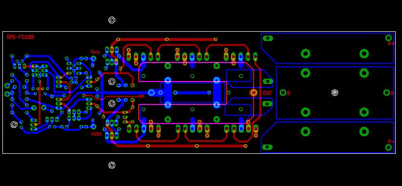

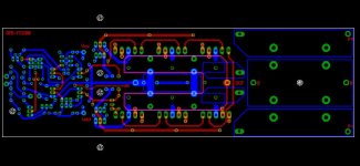

Hi Mihai,
For the moment i only have one channel built. I must build the Power Supply first. Have problem to find 35-0-35 small Transfo. I think i will take two 17-0-17 in serie to feed the two channel frontend reg.
Fun , because i have copied all your stuff in Altium and redraw the PCB completly in Altium to. Seem to be 100% functionnal. I have respected your design integrity, just make some small change to accomodate components footprints (WIMA caps are really rare here! ) and managed area to use input cap if needed, if someone want it i can post it. It can be more adapted to friends this side of Ocean and our parts suppliers.
