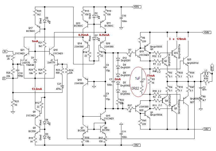

I've made a small design mod, as suggested by AKSA, with a very positive impact on bass control at high program levels.
C1 is now 1uF ERO MKT1813 (axial type)
The 0R82/0.6W, metal film resistor, in series with c1 is for avoiding ringing in driver transistors.
Thank you Hugh!
Mihai
Thank you Hugh!
Mihai

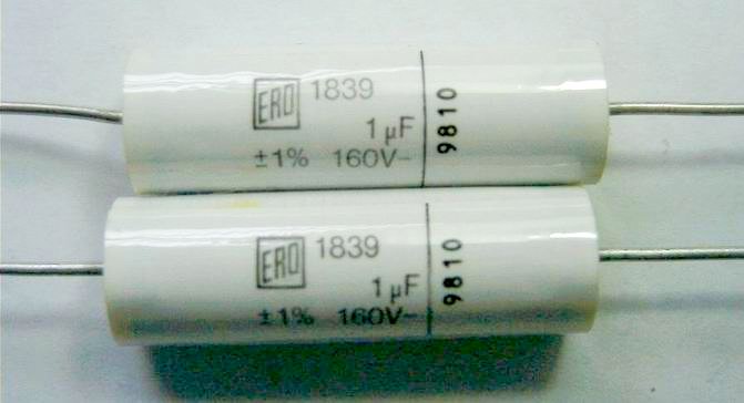

I'm looking for Hugh's comment, where should I look?roender said:Thank you Hugh!
What can I say?
You should use a foil, instead of metallised, polyprop in this position, very low dielectric absorption is important. Like the use of damping resistor, clever.....

AKSA said:What can I say?
Sorry, regarding capacitor type, it was a mistake. The right capacitor series is Vishay Roedestein mkp1839.
The DA is only 0.05% (according to IEC 60384-1).
I'm at the office now, but when I'll get back home I will take and present hire a picture of the capacitor
Am I wrong in thinking MKT is metallized polyester, MKP is metallized polypropylene, and FKT/FKP are the film/foil types of these?
..Todd
..Todd
many manufacturers break the marking rules, or don't even use them.taj said:Am I wrong in thinking MKT is metallized polyester, MKP is metallized polypropylene, and FKT/FKP are the film/foil types of these?
..Todd
driver currents
Mihai,
Is it true to say that majority of the 77mA is coming from Q19 instead of Q3? Looks like Q3 only draws about 3-4mA?
Thanks,
Richard

the CFP forces Vbe across R6 and this effectively operates Q19 at near constant current of just under 3mA.
All the remainder flows through Q3.
But, some current also flows to the output bases, possibly around 10mA.
Q3 will flow around 77+10-3~=84mA and dissipate ~2.8W. Keep them cool.

AndrewT said:... Q19 at near constant current of just under 3mA.
...Q3 will flow around 77+10-3~=84mA and dissipate ~2.8W.
True!
Thanks Andrew

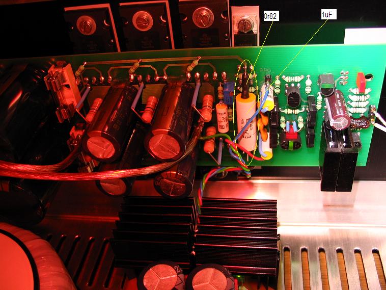

Mihai,
I particularly like the way you've inserted a rectangular green LED between two transistors, and then surrounded all with heatshrink to keep all at the same temperature.
A very neat, creative arrangement.... layout is IMPORTANT.
Hugh
Hugh
Mihai,
is it a material like heat shrink tubing or else you seem to use for the to-92 transistors so they are in close contact with each other?
fab said:Mihai,
is it a material like heat shrink tubing?
Yes, there is nothing special ...
