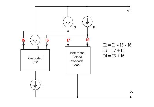

I am trying to understand some design issues of the amp 🙂 could someone explain me the reason for choosing 13.5mA current value in the diff amp at the input ?

One of the reasons for high LTP current is related with topology chosen, folded cascode, where the gain is highly dependent by the transconductance of the first stage.

and what about lowering the CCS current to , say, 10mA ? One would have ca. 4.5mA per JFET (against 6.25 now). Having Idss around 7mA one would be in the safe area. Are there any trade offs ??

Take a look at the attached picture and do yourself the math if you want I1=10mA.
I will suggest you to keep FC VAS current at the designed value, I7=I8=2mA.
