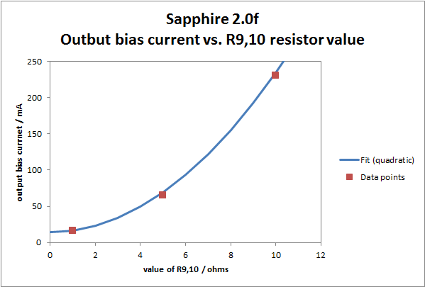

I have reduced R9,10 fom 5 ohms to 1 ohm, bias current falling from 70 mA to just 16 mA. Initial impression is it doesn't change much. Sound is very slightly lighter, rougher, and less well defined.
rjm
Joined 2004
In which we learn how the output bias can be controlled by the value of R9,10.
If we are aiming for 30 mA, 3.3 ohms.
For the original design point of 100 mA, 6.2 ohms.

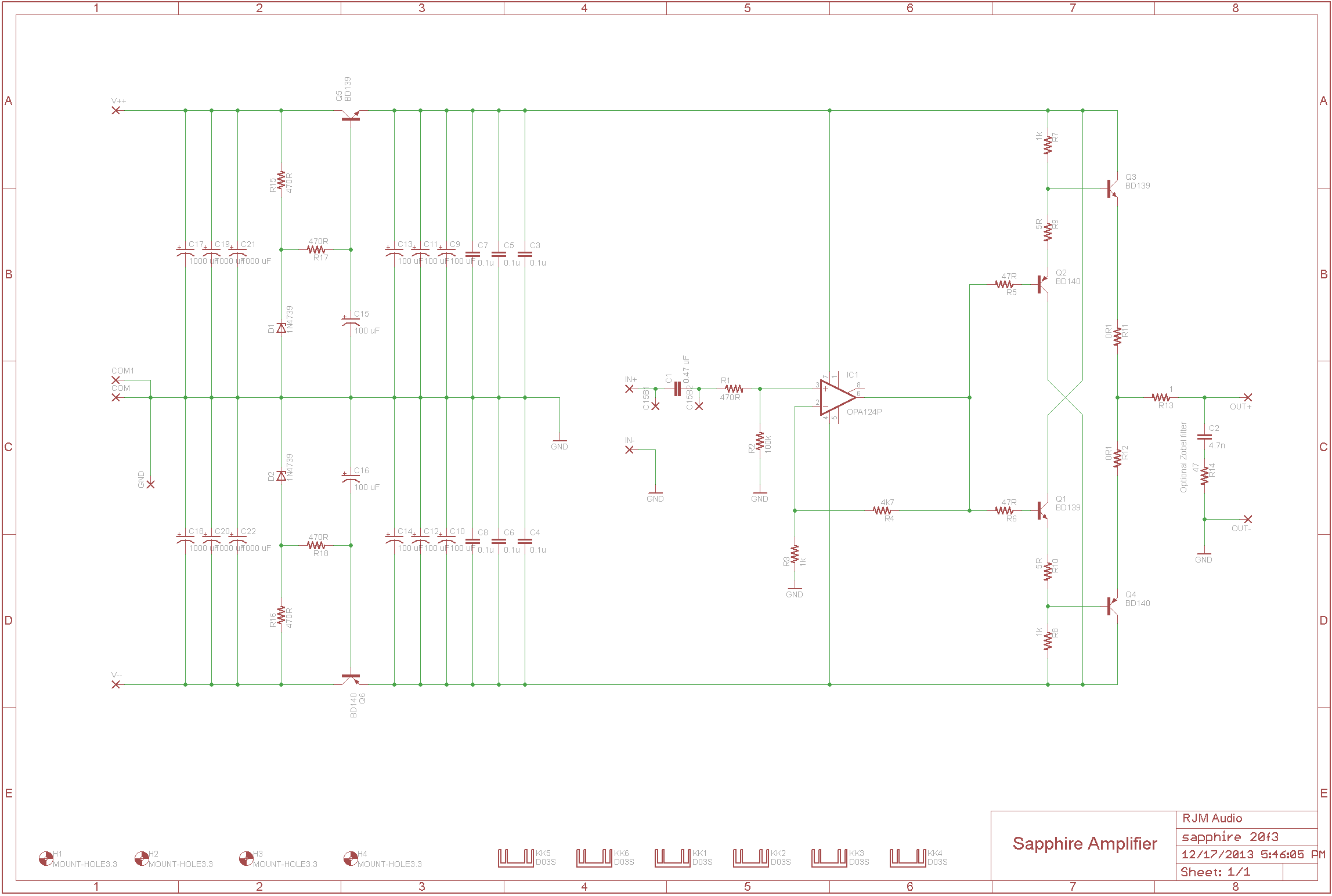

(schematic is two posts up)
The way the values work themselves out is as follows:
Chose the bias current. Practical values range from 20 to 120 mA. Anything above 20 mA will ensure the amp runs in class A for 99.9% of all headphones and usage cases.
The emitter resistors R11 and R12 are equal to 26/(bias current in mA). Thanks to AndrewT for letting me know that little fact.
Then, the bias resistors R9 and R10 have to chosen to get the desired bias current. There is no quick and easy formula for that, so I will list a few setpoint examples. These are calculated, and may be off by as much as 20%, so just as a guide only:
Bias current ------ R9,10 --------- R11,12
30 0.84 4.6
50 0.69 6.0
80 0.33 7.4
100 0.25 8.2
120 0.22 8.7
If R11,12 is slightly higher than listed, increasing R9,10 slightly will compensate.

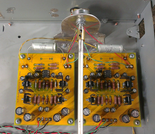

Today I got to go back and experiment a little.
I removed the j-mo from the same chassis as the sapphire to allow me a little more room to work. Annoyingly, I had earmarked a couple of 12V tx for this build, but when I had them in hand I realised they were a single secondary only. Grr.
So I added in a new gigawork type pot with very short signal wiring - the pot is mounted at the back of the chassis right at the input RCAs. There is quite a bit of improvment with these pots over the alps blue that had been serving in that role. At ~$12 each thye are great value.
Next easiest thing to do is to experiment a little with the input cap - I swapped in a 2.2uF Russian K75-16 cap. To my ears there is greater detail - not massive, but cleaner I think.
Richard, perhaps you would send on the mods to go from my 1.4 to v2?
Also - the zobel - I can't find a low value cap in my stash, is the 4n7 value critical?
Fran

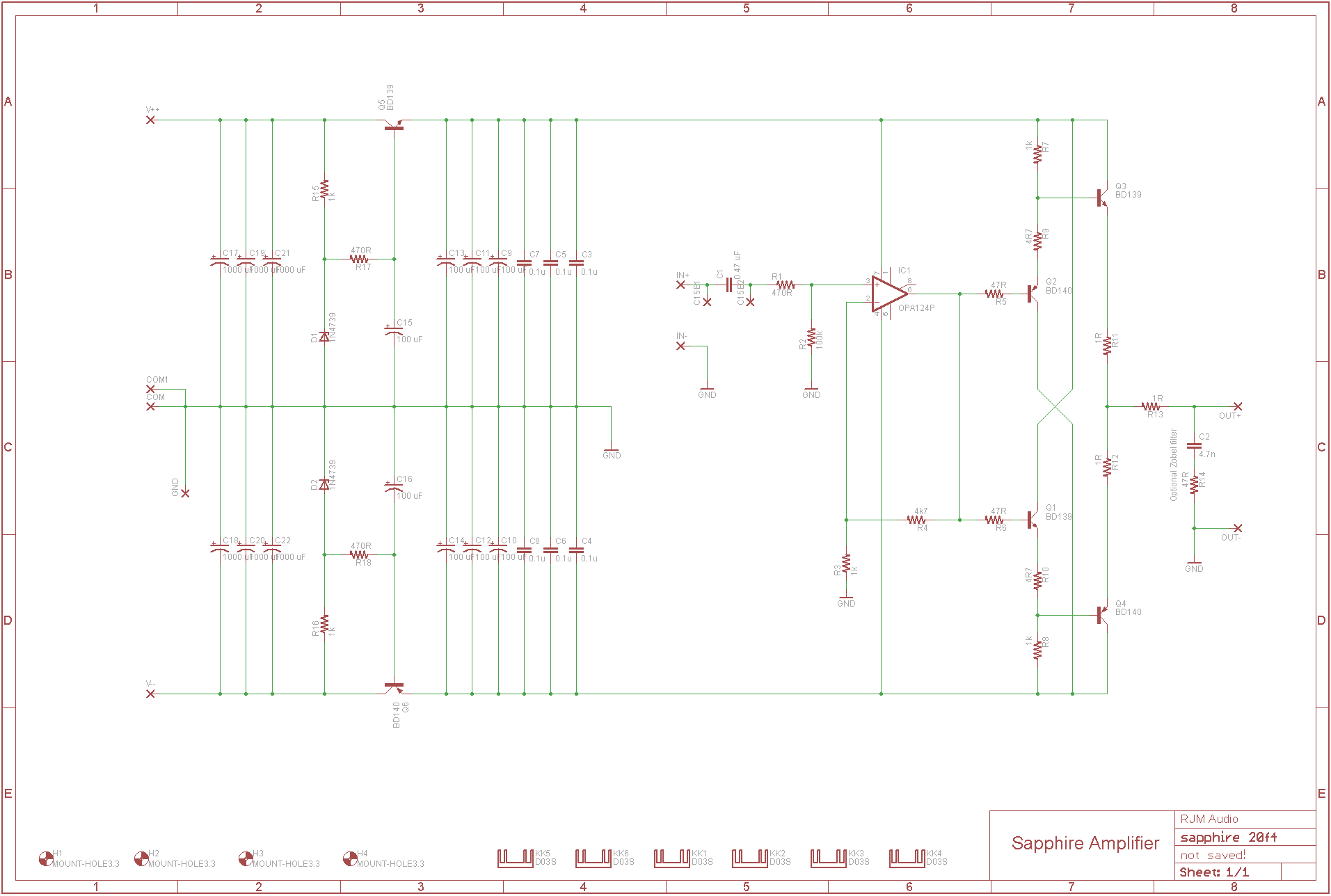

R9,10 = 4.7 ohms, R11 12 = 1 ohm gives a bias current of 28.5 mA and a sound that gets the balance of power and agility just right, and the additional advantage of a moderate power draw and heat signature, <4 W idle for the stereo circuit.
The schematic and BOM have been updated accordingly, with the additional change making R15,16 = 1k, reducing the Zener current a little to match the lower bias currents.
(Internally I give circuit revisions that do not change the board layout a number suffix, so 20f, 20f2, 20f3 etc. This is "f4" and I've uploaded to the new files to the web page also.)
