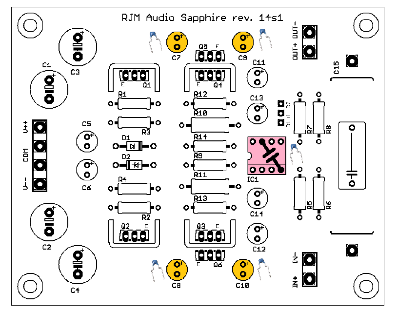

''Be careful not to get the transistors mixed up or soldered in the wrong orientation. Q1, 4 and 5 are npn (BD135), Q2, 3 and 6 are pnp (BD136). on the diagram above Q2, 3 and 5 face printed side up. Q1, 4 and 6 face printed side down.''
its my (comprehension) dyslexia that read that to mean the backs were to the front and it's my fault for not understanding properly.

Yeah, that's how I worded the instructions for rev. 14s. That's not the clearest, is it? I re-worked the wording in the instructions for the new version.

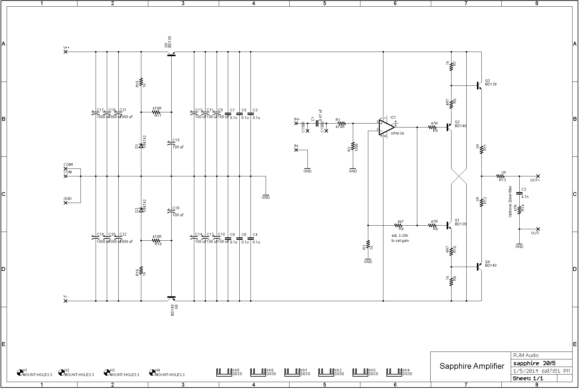

i looked at your gain calculator for the Sapphire which leads me to be a little confused as it states to change the value of R4, should that not read R14 or is the calculator for the new boards?

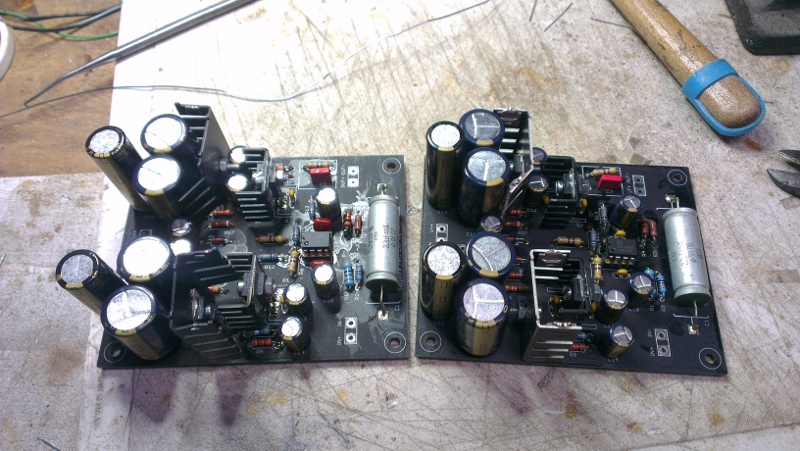

Richard was kind enough to send me out his old Sapphire boards so i duly put some power sockets on and wired it up, stuck it in my casework and what a difference. i now see why he uses the OPA134, this man knows what he is doing. i noticed that he has bridged 2 pins on the opamp sockets underneath with some caps which i failed to do.
how does it sound? ermm beyond my expectations. the weight to the bottom end is sumptuous warm but well controlled and very very quick, it's difficult to get hifi gear that follows the bass guitar notes properly without them sounding 'one note' but fear not they are there in and well defined. mids are just astounding with no hint of grain which i was experiencing with my build. the highs are airy and sparkly. overall sound is open and lush. i was happy with the ones i built but Richards has taken it to the next level. i'm only listening to crappy MP3's threw a creative zen vision m as source and cheap £5 headphones but i'll be hooking it up to the oppo and using the DT-770's in a wee while. Talk Talk - colour of spring oooohhhh yes indeed.

I'm glad it worked out.
It's hard to imagine that the single ceramic cap made the difference. I listened to the boards before and after I soldered them in and the change seemed to me quite small.
The cap between pin 4 and 7 of the op amp is a trick Douglas Self suggested for, iirc, the NE5534. Google is being unhelpful - sorry I can't find the link.

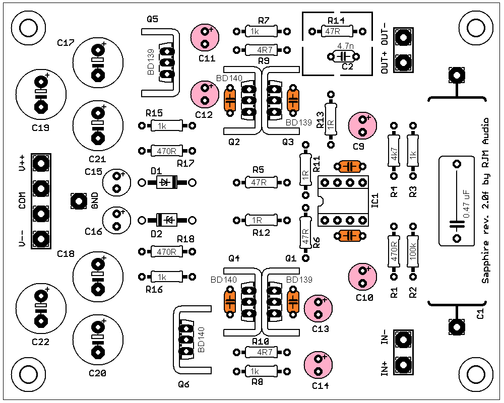

I have almost finished assembling my new black beauty boards.
The build went well so far. I have a few changes based on available parts I had to hand. I used BD137 and BD138, and I shoehorned in some bigger caps: I had a stash of 220uF that I used in place of the 100uF, and I used 1500uF instead of 1000uF elsewhere. Lastly, my zobel is 22n and 10R - I seem to be somewhat short on low value decent film caps! C1 is a russian K73-16 2.2uF which I also used on the rev14 boards to good effect.
On my current 14 rev boards, I'm using a pair of 15V EI transformers through standard 1n4007 diodes. On this one, I sprung for a pair of toroids and MUR120 for the diodes. First up though is just to add in the new rev20 boards and see how they go.

Ok, so I left it powered up for 4 hrs and then listened. Bearing in mind expectation bias etc, to my ears there is a clear improvement over the rev14 boards. Greater soundstage and easier to hear micro details.
Having heard that, I decided to press on and I installed the new toroids and MUR120. Well, another improvement there! Sound is more "well rounded", and more detail and separation. So for example I can hear a saxophonist taking a breath before easiing out a note, or the decay around the reverberation of a note can be heard dying away in the mix.
Overall this is a substantial upgrade from the rev14 I think. Thanks Richard!

Use 20k for the gain set resistor. Re. the distortion, you have me stumped at present. What is your measured values for V++ and V-- again? The only suggestion I can make right now is to move it to a couple of different environments, try it with some different sources just to make completely sure the problem is with the amp itself.
