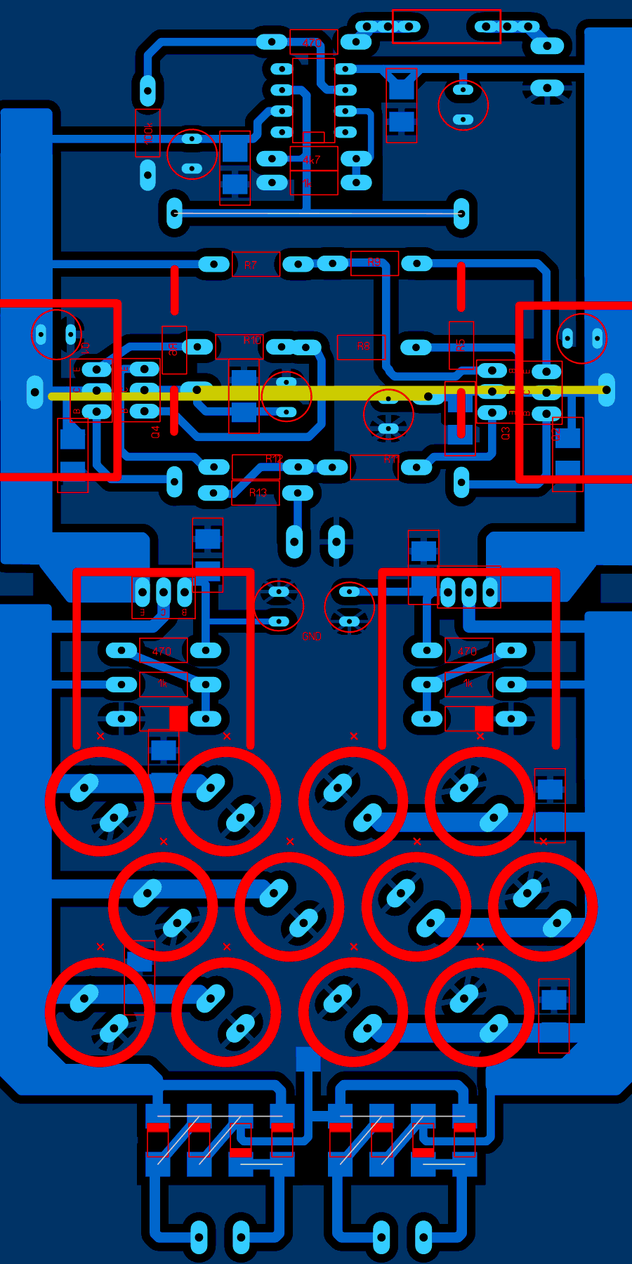

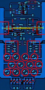

Single Sided board
I used Sprint Layout 6.0 to layout a single sided board. I made a few changes. On board rectifiers are surface mount round barrel type. I think MELF? Anyway, I doubled initial smoothing caps and added a few ceramic caps.
I left out the zobel.
I tried to do it without jumpers but I have two. Otherwise I couldnt find a way to keep ground from being interrupted.
I use large oval pads because they are easier to solder and I always make smt pads larger than they should be for easy soldering.
R5 and R6 are extra long almost like jumpers to reach from the top of the board to the bottom of the 4 transistors.
An MKP4 might not fit by about 2.5mm. I put the .lay file in my post so you can fit in a larger cap if you like.
Also the whole thing had to fit to 3" by 6" to fit my copper clad boards so things look pretty cramped in some areas but I'm looking forward to building it. Dont assume that this works instantly. If you want to use my file then please double check it against the schematic. I might build it this week if I find all the parts. Not sure if I have all the BD140/BD139. I think just 4 of each. So I'll have to order before I will know if this thing works great or not.
The yellow lines are jumpers from the rails. This was just for me to listen to this headamp so perfection is not included on this layout. Its free though

As you've found, a single-sided board necessitates a jumper or two.
By the way, the capacitor banks of 3x1000 uF and 3x100 uF shown on the schematic are not set in stone. It's because I keep a stock of these values common to all my projects, so if I want 3300 uF, for example, I'll just use three 1000 uF in parallel. If I want 2200 uF, I'll use two 1000 uF. Feel free to change the arrangement as you like, a single 3300 uF (or a bit more, or less) will be fine for the filter capacitance before the regulator.

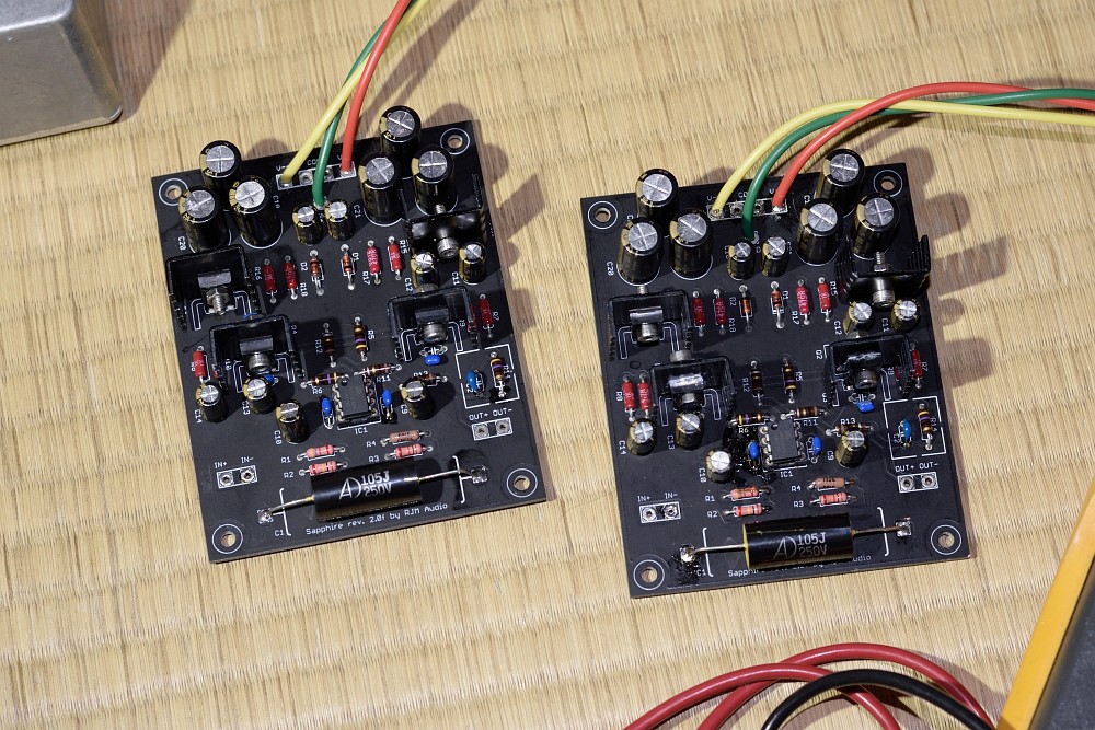

Replaced my first set of 2.0f boards with a new set. This time, I left out the Zobel filter and ceramic bypass caps. C1 reduced from 0.47 to 0.33 uF (Multicap PPFXS). Resistors are PRP metal film, Takman carbon film, and Kayama carbon comp. IC1 is OPA134. Gain is set at 27 dB with R4=22k.
Still breaking in, but it sounds nice. A tad dry, faster than I remember, very nimble actually. I don't think there is any disadvantage to leaving out the bypass caps, none that I can hear at present but I'll put them in later to double check.

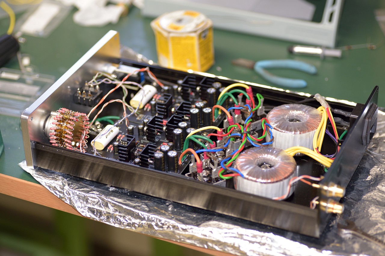

goodbye buzz hello silence
finally got rid of those nasty nasty RS toroids and installed a custom built Toroidy 300-4x12 and it's completely silent.
Have you got any pictures?
just charging the camera battery.
it might be me but i could swear that the noise floor has dropped and everything is sounding a bit smoother. if i had one comment i would say that it has lost a very small amount of soundstage to which i actually like as its brought everything a tiny bit more to the middle of my head. but it could be a placebo.

Test notes:
As planned, I tried adding back the ceramic capacitors I left out of my new set of boards. Did it in steps, as follows:
1. "nude" (no bypass caps, no zobel). Lively, but some roughness or hash obscured the fine details of orchestral works.
2. add Zobel. Surprisingly large effect. Less air/fizz, more weight, general improvement in definition.
3. add Zobel and ceramic bypass caps next to IC only. Maybe more of the same improvement in definition, maybe not. Near or below my detection threshold.
4. Zobel, and add back all the caps. Not a huge difference that I can hear, but any sense of RFI-like hash or haze that was definitely there in the "nude" version has gone. It's smooth, deep, and resolving.
Based on this test, I recommend building the rev. 2.0 boards as listed, with the Zobel and bypass caps in.
