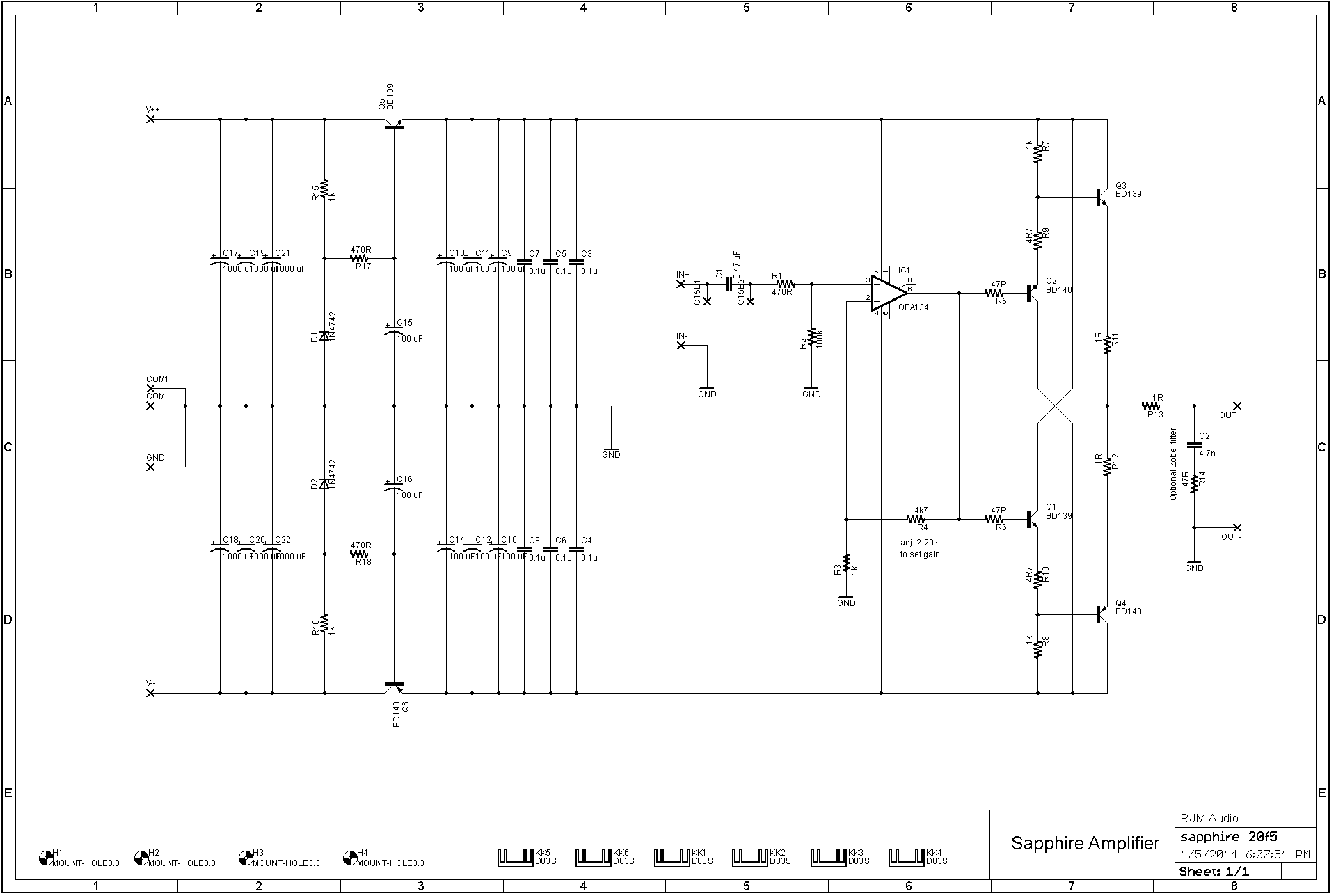

Hi RJm, thanks in advance for making such a great built log.
As an Electrical engineering student and audio enthusiast, I decided to build this amp to power my hd650, which is currently being run from my pc output!
I`ve bought all the components and I`m on the protoboard stage..but I have a doubt: Could you please explain what are the C15b1 and C15b2 on the schematics and what are those X that these caps are connected on?
Also my V+/gnd is 16.50V and V-/gnd is 16.51V, are these acceptable values?

Thanks! Now before you get too far into this, please note that the schematic (reproduced below) is just a guide thats produced in the process of making the board layout. For the actual parts values please download and follow the BOM list.
EagleCAD doesn't always have the exact parts, and sometimes I neglect to keep the values current.
The schematic below is correct as of this post however.
C15b1 and C15b2 are just the alternate pads for connecting the capacitor C1.
D1 and D2 are 12V Zeners. The input voltage V++ and V-- need to be at least +/-14V. +/-18V is the nominal design value. At around 14 V R15 R16 should be lowered to 500 ohms or so to keep enough current flowing through the Zener. Or use a 9 or 10 V Zener instead of 12 V. The circuit can be adapted to run at even lower voltages, just reduce R7, R8 to match.

Thanks rjm,
I`m getting about 17,0V at the bridge rectifier output and 11.67V at the final output (which powers the amp op), those 16,5 v I had before is because i had my q5 and q6 inverted.
+/- 11.5 V at the op amp is exactly right. Should all be running fine now, hopefully. Just double check the output offset voltages before listening.
