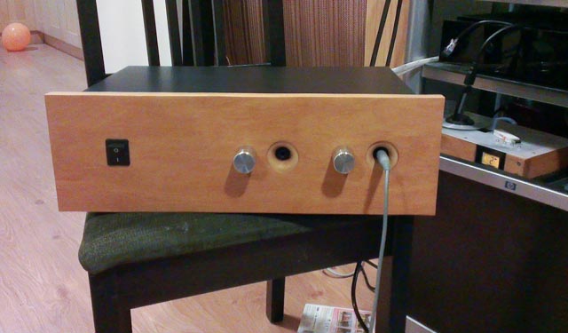

I finished up the front plate on my sapphire/J-Mo combo today. Nothing really changed inside the box except that I tweaked the shunt a little and mounted the heatsink for the shunt outside the box just for a little thermal management.
The chassis came from an old marantz cassette deck that had gone to the great tape tangle in the sky and the front is a bit of aformosia (I think). I like timber fronts on equipment. It still looks DIY but is very presentable and I find it easy to do. I can flick the source between the 2 headphone amps with a switch at the back. If having it at the back is an issue I can remount it at the front. But you can only listen to one set of cans at a time and my tendancy is to spend time with the k701 and then flick back to the HD650 for a while... so direct switching isn't all that big a deal I think.
One bad thing did happen - one of the gigawork pots was a bit gammy to start with, and when I tightened it up to the front plate it wouldn't work right at all. I think that there must be a cold joint in there somewhere as sometimes it would work if you squeezed it a certain way etc. Anyway, I stuck an alps rk27 in there until some new pots arrive from ebay. Not exactly the last word in transparency, but it will do for now.
Poor enough pic, but it gives the idea.

That looks really nice Fran. Are you left handed? I have to say I prefer the volume control to the right of the headphone jack, so the cord doesn't block my hand as I adjust the volume.
The other thought I had was re. the selection switch. Really there's little need to have a switch. The line input can drive both volume pots full time, the only penalty is halving the input impedance seen by the source. If that's going to be acceptable you can just connect the input to both pots in parallel, bypassing the switch.

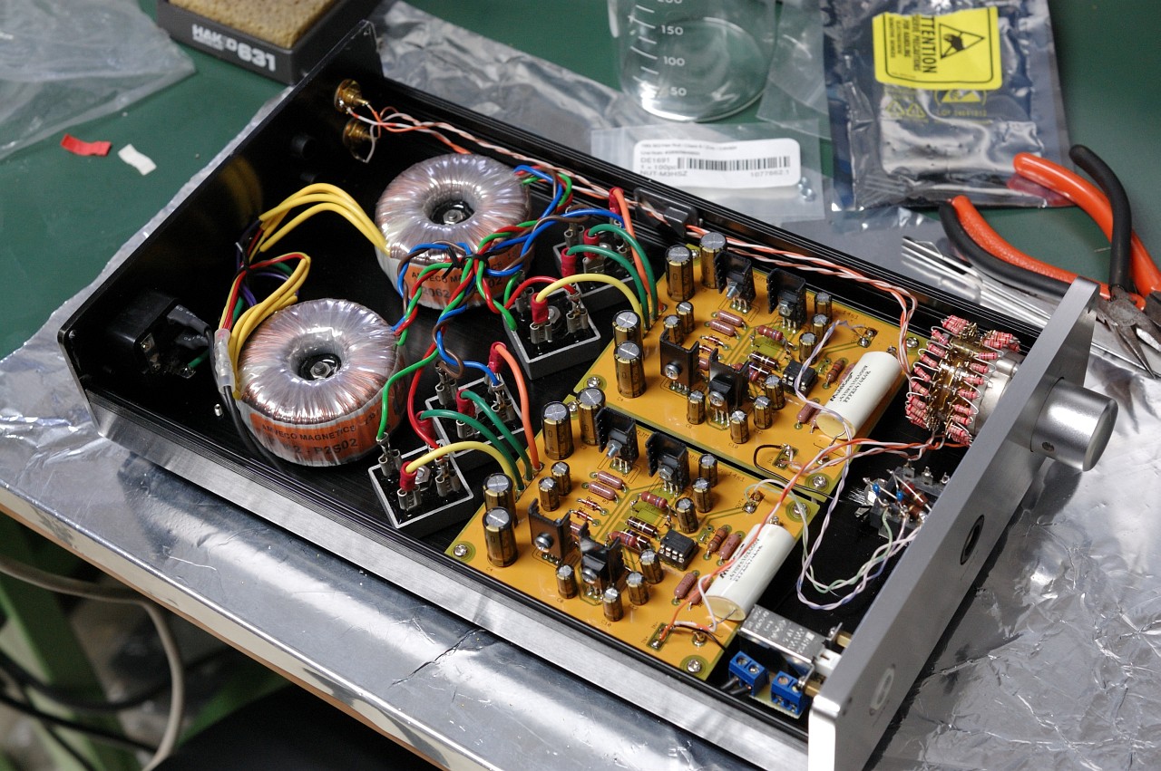

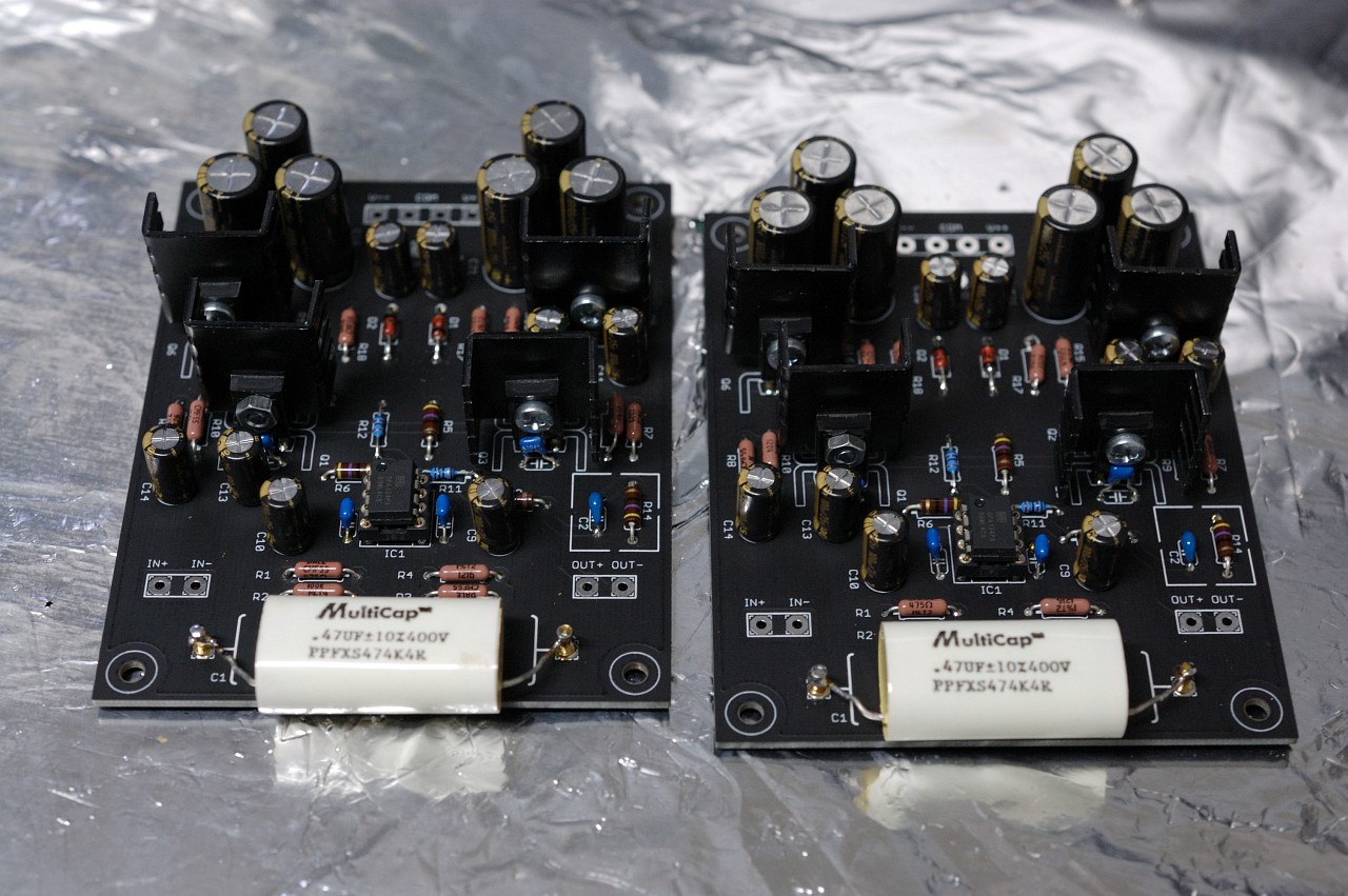

Version two up and running on the bench, transplanted into my original Sapphire chassis. As expected my simulation of the bias currents was a bit off. R9,10 should be reduced from the 10 ohms originally specified (giving 230 mA) to something around 6 ohms (100 mA predicted). At 5 ohms I'm getting 70+/-5 mA through the output transistors, stable.
Photos and listening impressions to follow.

While the 14s1 boards can be modified, it is not trivial: you'd have to cut traces on both the top and bottom of the boards, and wire resistors between pads to connect over the cut traces. If you are up for it I can show you what and where.

Various changes to the "off board" can make substantial improvements, but they tend not to alter the character of the circuit.
Here's how it was for me: I really fell hard for the Sapphire "sound", especially (or more correctly specifically) when connected to a high-end source. The resolution and dynamic energy was phenomenally better than anything I'd yet tried. It could power though even the most intense orchestral music with perfect control. But, if I had to cite a weakness sometimes I could detect a slight "slip" on transients. A tiny moment of distortion on the attack, an excess of emphasis. I wondered maybe it was running out of class A headroom, or perhaps it was simple overshoot. Certainly various improvements I made along the way (higher current, ceramic byapss caps, Zobel) seemed to smooth things over, but I could not say that it (the slip) was completely, 100% eliminated. And it could even be said to be a part of what made the Sapphire sound so good, so lifelike: the transients seemed to have real kick to them that I've only ever heard reproduced before on very, very expensive gear.
This prompted me to look into increasing the bias currents to the practical maximum:
In a nutshell, the modified output stage redistributes the current, reducing the bias in the driving pair by 3 times, and increasing the bias in the output pair 3 times. Overall power consumption / heat dissipation increases only slightly.
