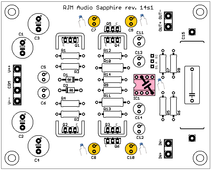

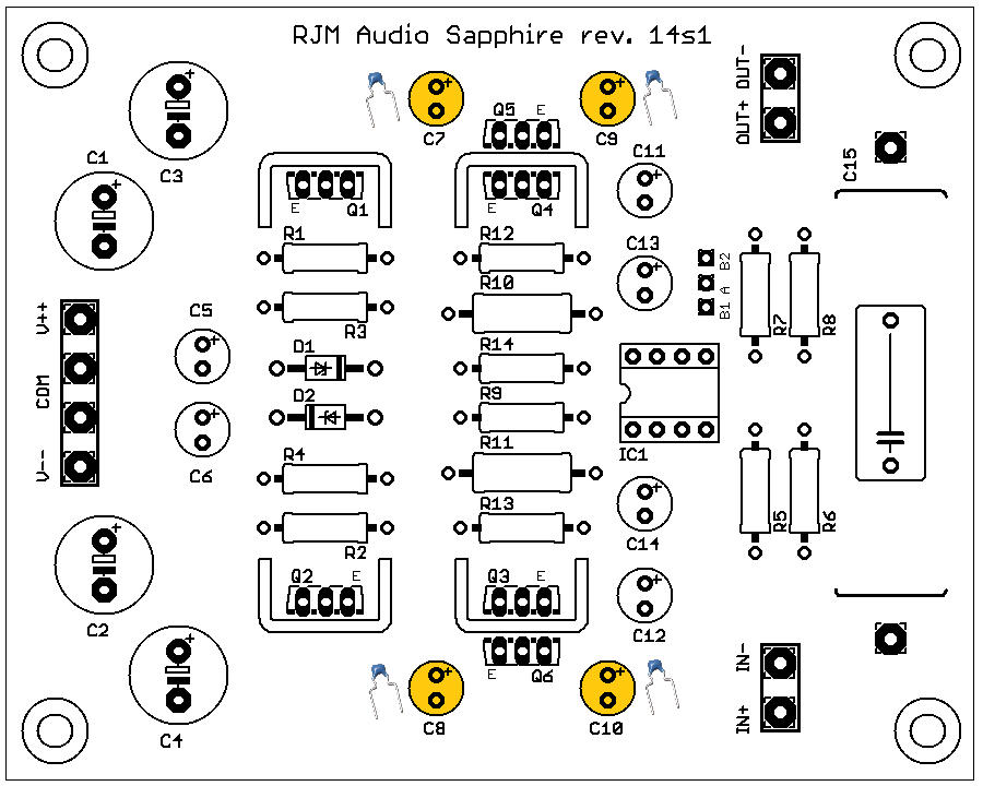

How 'set in stone' is the value of C15 (0.47uF)??? If it were to be changed, would the values of R5 & R6 need to be adjusted??? (I have some very nice 1.5uF Auricaps I'd like to try.)
Thanks,
Thanks,
Hi Ray,
Go ahead and give them a try. No need to change any of the resistors. 0.47 uF goes against R6=100k to form the DC blocking input filter. 0.47 uF is the nominal minimum / sufficient value. Increasing the capacitance further doesn't impact on the audio frequency response significantly. Decreasing it below 0.47 uF starts to roll off the bass frequencies, but you could probably drop to 0.22 uF and not hear anything, while 0.1 uF might be used to deliberately compensate for "boomy" sounding headphones.

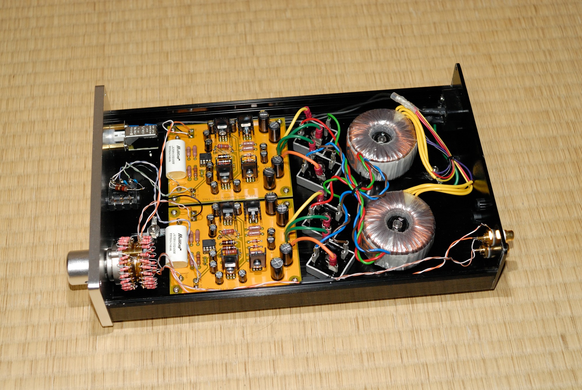

An update.
The Sapphire uses a non-inverting op amp topology; these can be tricky to get absolutely quiet: partly because the front end faces a volume control (high, variable output impedance) and partly because the noninverting input signal, which is the sensitive one that causes positive feedback if it couples to the output, sprawls over the case wiring, where it can easily get too close to the output wires or what not.
It's not too uncommon to run into trouble, even if you are pretty fastidious about shielding and proper dress.
My own build is quiet in most situations, but was acting up a little when attached to my home desktop PC - there's no earth connection, and cheap switching power supplies left, right and center.
Re that situation, the following observations:
Good interconnects help a lot.
The metal faceplate was in poor electrical contact with the main chassis, due to the paint acting as an insulator. Scratching off the paint in places to ensure a good contact helped.
Moving power bricks away from the interconnects helped.
If the PC was turned off, or the interconnects unplugged, the Sapphire was very quiet, just barely audible fussle when the volume control was maxed.
The big breakthough came, however, when I changed the chassis ground connection from the output headphone jack (OUT- -> chassis) to running individual ground wires from the chassis to IN- at the boards, instead.

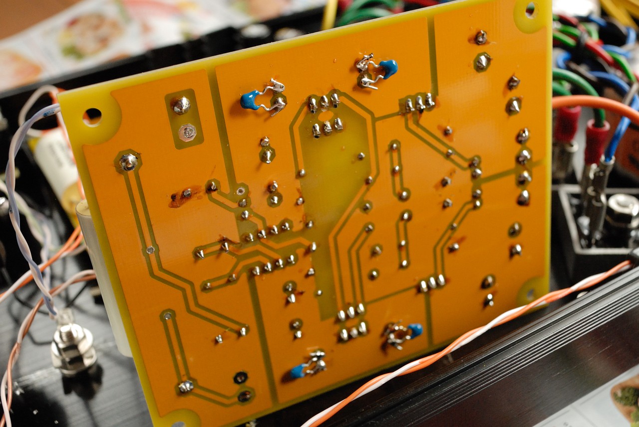

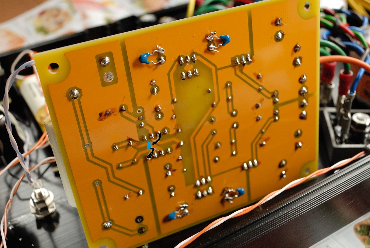

Ceramic bypass capacitors
A significant improvement in sound quality can be obtained by bypassing the electrolytics near the diamond buffer with 0.1 uF ceramics. For more details, see my blog. It applies to both the B-board and Sapphire.
I will send caps to anyone who bought Sapphire (and B-board) boards/kits from me. Please contact me.
Not only does the top end become significantly less "edgy", but overall the background noise seems to be reduced. I had some trouble with RFI interference when I used my Sapphire with my desktop computer. That's gone now.
Why does it make such a difference? Well, I suppose the simple answer is that the diamond buffer has a bandwidth of 4 MHz or more, well in excess of the effective range of electrolytic capacitors. In principle there's no signal out there, but apparently it can pick up HF garbage which gets converted down to treble hash when not properly bypassed. I really not sure of the exact mechanics. I thought I would be safe by keeping the buffer out of the op amp feedback loop. Apparently I was wrong.

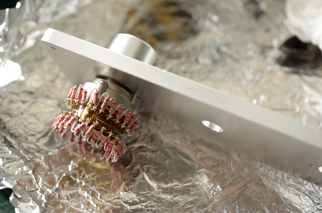

Yesterday I replaced a small SMT-based 24 position attenuator with this Takman 24 position attenuator. Both from eBay. The trick was the faceplate was predrilled for 1/4" while the new attnuator was a 3/8" unit. The lock pin is also further off center.
Some creative work at the drill press and the new attenuator is properly fixed to the faceplate, as shown. It's a bit stiff : the small, smooth volume not means it's hard to to turn, but the sound is excellent. I was not impressed with the SMT unit, though since it was all of $5 I suppose I can't complain too loudly. Muffled and dull. This Takman stack, I'm in love with.
