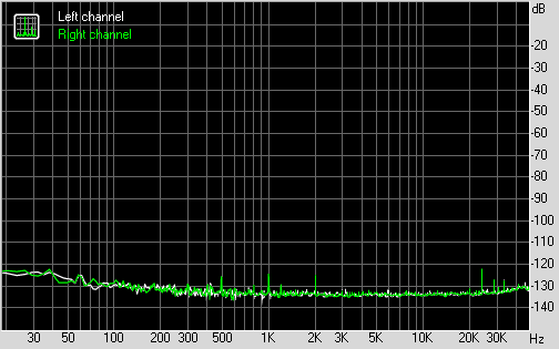

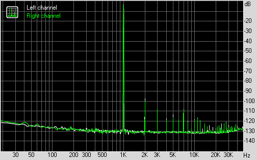

Alright, let's do some measurements!
Measurements are only as good as the measurement tools. Also, measurements are a total PITA.
I'm using my Onkyo SE-200PCI soundcard at 24/96. In-out loopback using a nice set of oyaide interconnects generates the following FT spectrum, for a -1 dB 1kHz sine wave.
2nd harmonic -100 dB. 3rd harmonic -110 dB. Noise floor below -120 dB worst case, typically -130 dB. THD+N is 0.003%.
So far so good. Problems starts happening if the R and L grounds are connected anywhere in the test loop, which of course happens in the case of a headphone amplifier since the headphone jack has only three pins. Then, a lot of switching noise garbage gets injected into the output for some reason... most likely a problem (possibly unavoidable) in the circuit layout of the soundcard.
The investigation, as they say, is continuing.
The images below show the soundcard alone, they are the baseline before I test the amp.

Sapphire 1. Computer 0.
Only significant event tonight was blowing the line input of my motherboard. Not my Onkyo card, thankfully, I was trying the on board chip to see if it made any difference... 1 kHz sine test input through the sapphire and into into the line input at (accidentally) full volume ... and pop goes the audio chip.
I'm kinda impressed (and relieved) that the Sapphire amp was utterly unaffected by the incident.
Testing suspended. Time is better spent listening than testing.

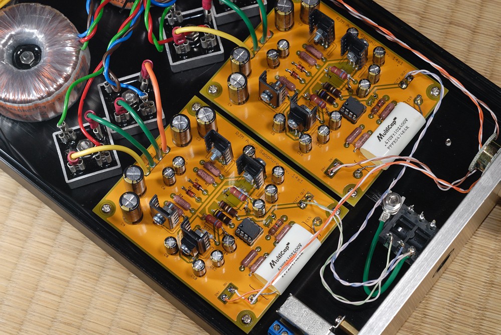

Just finished the wiring of the amp.
I will be making the outboard power supply this week..
Going to mod this one I built before.. outputs dual 15vac with two tordoial with parallel secondaries and the vandal switch circuits
-joe

Btw that's a sweet looking build. If you used that case for the power supply, you could get two larger transformers in there if you removed the relay and extra circuitry. Though I suppose you'd still need room for the rectifiers.
After some dry fitting, etc.. I decided to go with the 1455T (same size as the amp side) for the power supply. It will allow me to use a pair of 25va transformers and have room for the wiring and rectifiers.
