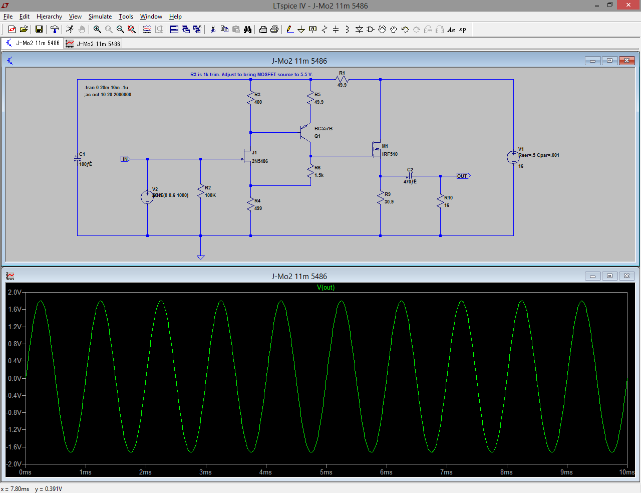

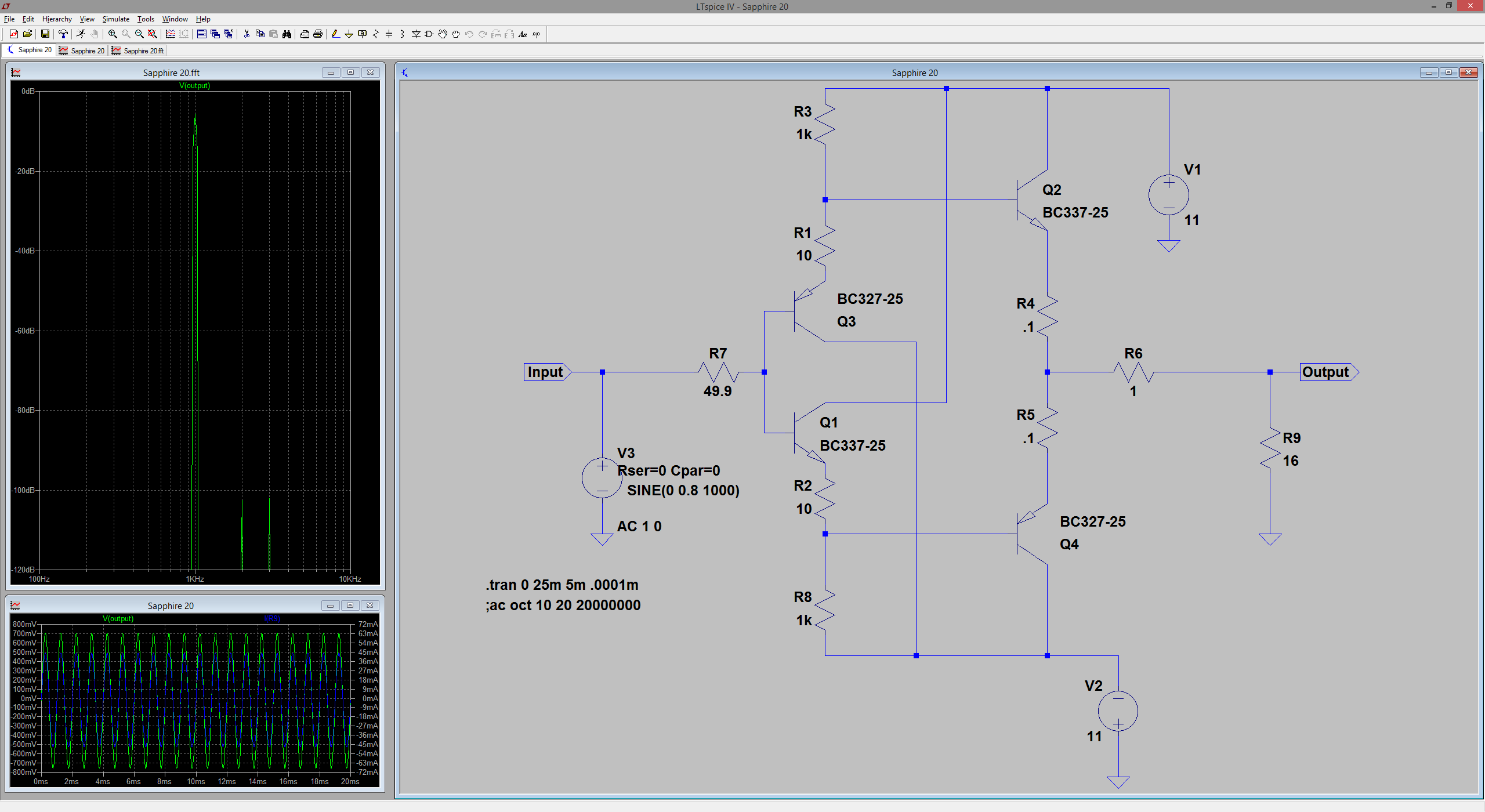

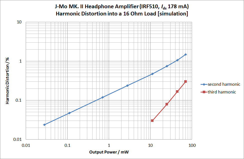

THD simulation for the BOM version of the J-Mo Mk. II, driving a 16 ohm load.
I mistakenly posted this to the wrong thread. It belongs in the J-Mo Mk. II thread instead, as a followup to this post.

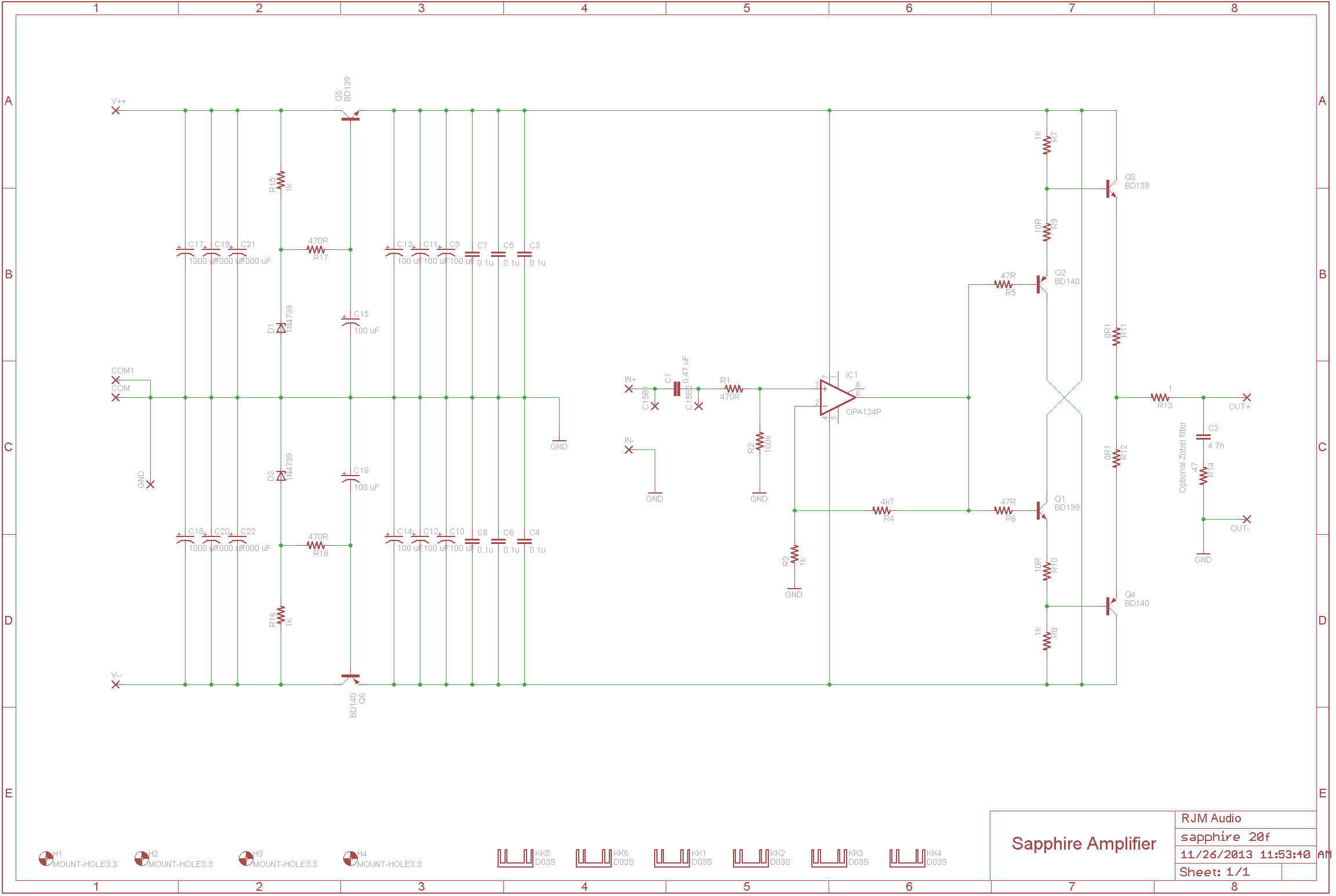

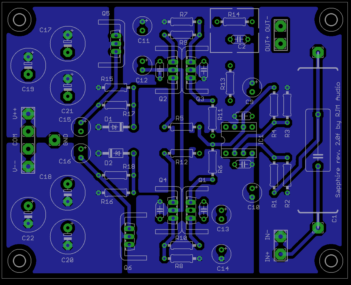

Revision 2.0
This looks to be about the final revision before sending off for fabrication.
The new boards are drop in replacements for rev. 1.4s, and the circuit can default back to the original if desired.
The main changes are the addition of a Zobel network on board, ceramic bypass capacitors on board, and an additional pair of resistors to increase the bias current through the output transistors. The parts numbering has been completely changed, however, and I will be updating the documentation to reflect that.
There will be 9 sets of boards available, and will do a limited edition kit if the interest is there.
Whats the story on the zobel on the output Richard? Have you found it particularly beneficial with any cans in particular or either end of the impedance spectrum?
Fran
Fran
No, I can't say it makes any difference, but maybe it does. It's a comfort blanket, so you can rest secure in the knowledge you have that particular base covered.
