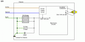

ESP's tutorial on earthing came up in a recent blog post.
It may be, as they say, relevant to our interests. I haven't tried it, though I might give it a shot. I would have though that simply lifting the safety earth would amount to the same thing in terms of noise pickup. So if doing so makes a big improvement then you can achieve the same result and still maintain the safety connection by using the bridge rectifier arrangement illustrated.

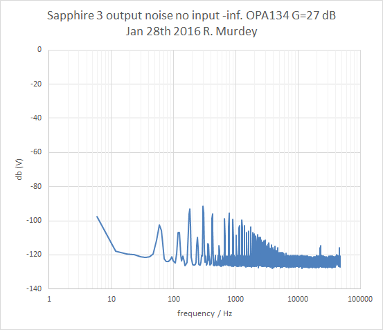

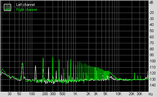

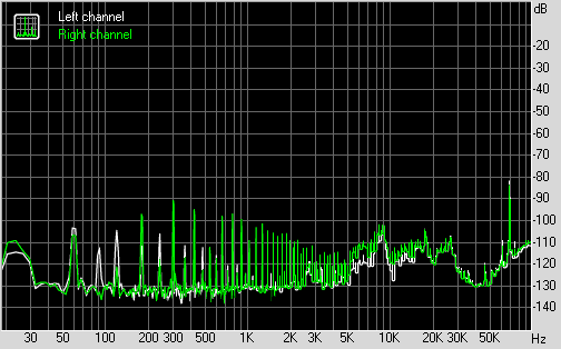

See below for my most recent results. Finally, I can see my enemy.
recent changes:
- removed the AC wiring to the front panel switch, connected the transformer primaries directly to the rear IEC jack.
- added a 0.47 uF film cap across the AC line (if doing this, you should formally use an X or XY type supression capacitor)
- removed bypass cap C22,23 next to the op amp.
The audacity screenshot is after +70dB amplification.
We can see that the residual "frill" of harmonics in the audio spectrum is due to tiny spikes at 120 Hz due to diode conduction. That is the only residual signal above the software imposed 16 bit resolution floor. Rightmark (with the volume turned up and inputs connected) gives the same result, so its clear the interference is internal to the Sapphire circuit, un-associated with the input signal.

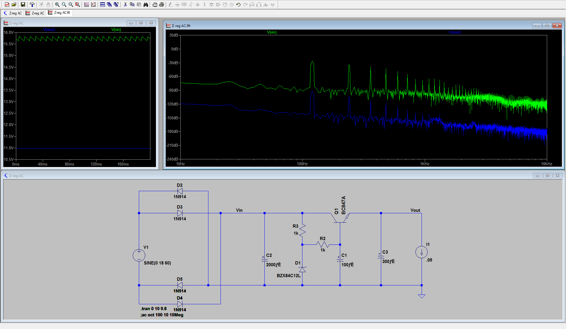

For those who might be interested here is the breakdown of the Sapphire3 power supply and ripple.
12 VAC per rail gets rectified and fed to the Sapphire3 circuit boards where the first thing they see are 2x1000 uF filter caps. The resulting voltage Vin is the V++, about 16 VDC with a 300 mV p-p sawtooth edge riding on top. This would be pretty nasty sounding, but fortunately it is smoothed out into a heavily distorted sinusoidal waveform about 100 microV p-p at the output of the Zener-based voltage regulator (Z-reg) Vout.
The noise on the DC voltage feeding the op amp and buffer circuit, V+, is simulated by the blue trace in the LTSpice screengrab below. The largest peak is less than -80 dB at 120 Hz. That would still be a problem, technically, except that it is mopped up by the PSRR of the op amp (above 60 dB below 10 kHz) and the buffer (also above 60 dB below 10 kHz).
So, typically, the ripple in the output can be expected to be -90 - 60 = <-150dB dB from the buffer, and -90 - 60 + gain 27 dB (in my case) = <-123 dB from the op amp). That's a conservative estimate, as at the lower frequencies where the Z reg noise is highest the circuit PSRR is also better.
It is doubtful any noise spikes would be seen in the output at all.
However, I do see a noise pattern in the output at -100 dB that looks very similar to the noise in the V++ rail. The most likely explanation, therefore, is that the output noise is produced by coupling to the V++ either through free space or through a shared ground trace. The latter is unlikely, as the layout does not make such an error. I'm left with pickup through free space, i.e. a shielding problem. Unfortunately it varies little with volume, meaning it is induced not in the input wires to the RCA but in the section after the volume control which is harder to deal with as it includes the circuit board itself and not just chassis wiring.

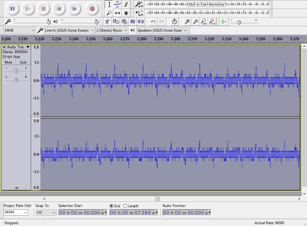

best i can do. recorded with RPi off and recording level at 100. amplified at 50 as thats the max it would allow.
That's progress! Actually you can call the amplifier function again and set the number to less than 50 dB to scale the view further, but what you have there is sufficient. You can try looking at the FFT, or zooming in the time scale to see if there is any 60 Hz hum or ripple noise in the recorded signal above. Interesting that your output signal seems to drift a little over the seconds time scale.

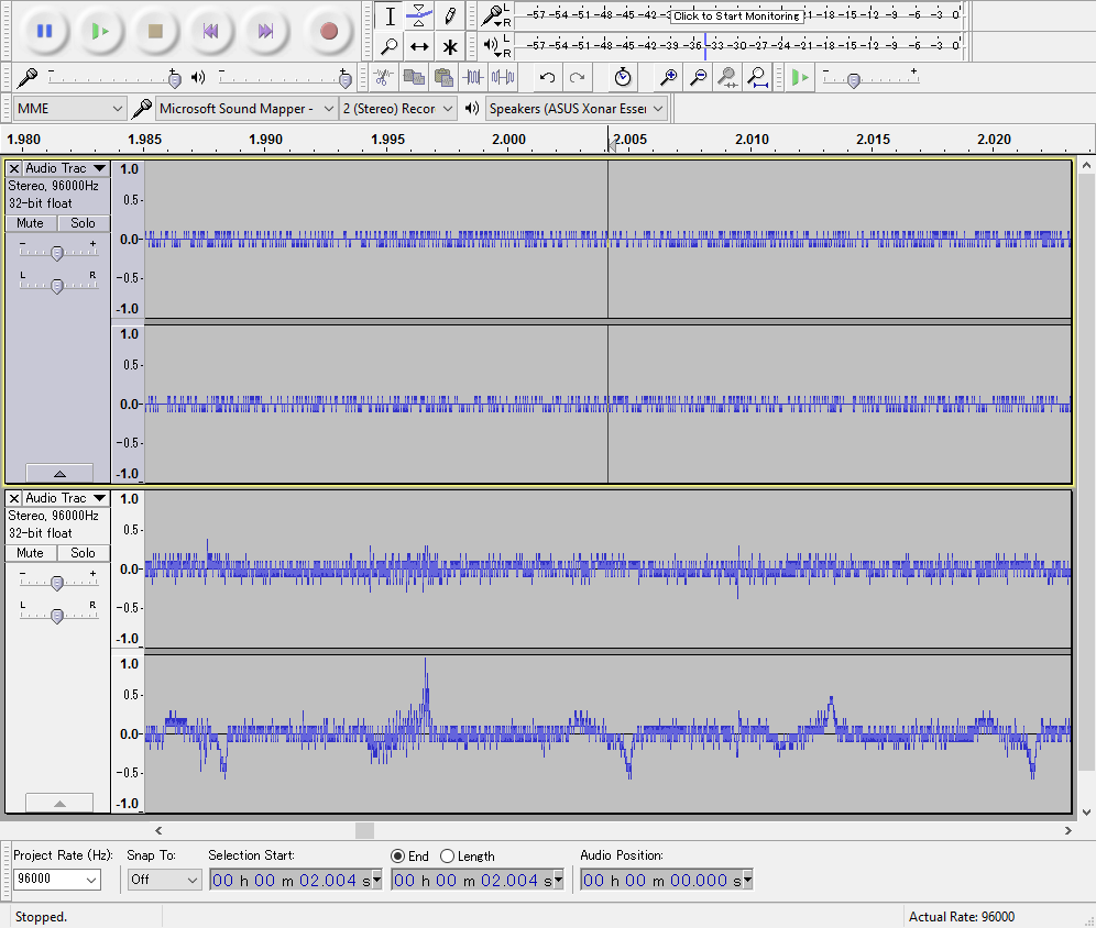

Here's my setup, after applying the same 50 dB amplify to the recorded data, and for 70dB (50+20). Top track is the line input with no connection, bottom track is with the Sapphire3 connected, powered, volume 0. The limited resolution is due to Audacity recording in 16 bit despite the 24 bit ADC in my soundcard due to licensing restrictions.
soundcard plugged into the Sapphire without the Sapphire being on.
i cant take a reading with the cable on the soundcard unplugged, it wont let me.
Sapphire on and RPi on with a silent track playing at 1 on volume.
spectrum, yup a bad 50hz.
