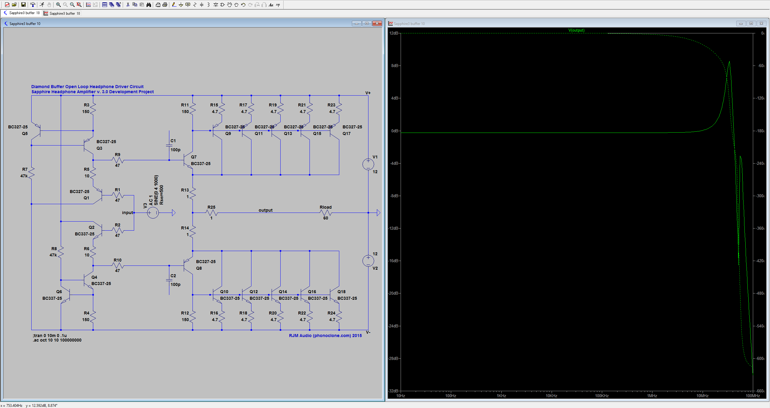

Compensation caps
Thanks. Out of curiosity, what was the peak frequency?
They are added to reduce the HF peaking observed in simulated frequency response.
So the answer is "for stability" though I have not noted any real-world instability and it is just as insurance. They can safely be left out.
@mlackey
Around 40 MHz. Note that any amount of stray input capacitance will also damp that resonance out and the complete circuit bandwidth including the op amp (not shown) is far less, meaning the peak is already not so relevant, but adding the two 100 pF caps as shown settles it definitively.

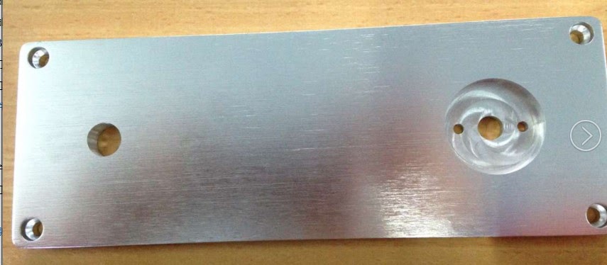

rjm, I saw some photos of your amp housed in a casing similar to this one on Taobao.
https://item.taobao.com/item.htm?id=20846375865
Were you using the same casing?
That one is very similar, but I think it is smaller in all dimensions than the ones I used and does not have enough space to fit both PCBs and the power supply. There are lots of variants from Breeze audio and others.
You want one which is about 180 mm wide, like this one
for example given as 184x301x60mm (ebay link will expire).

This one should be enough for two boards and trafos.
I am planning to use it.
it is actually the shop which sells chassis directly from the plant and quite efficient so far.
They are doing precision drilling and other customization by request.
That's the one for the chip amp LM3886 circuit and similar, so there is no headphone socket drilled in the front panel, an unwanted set of RCA cutouts in the back, and vents that you don't really want either.
The same case as the ebay one can be found on aliexpress (naturally), for example here.
