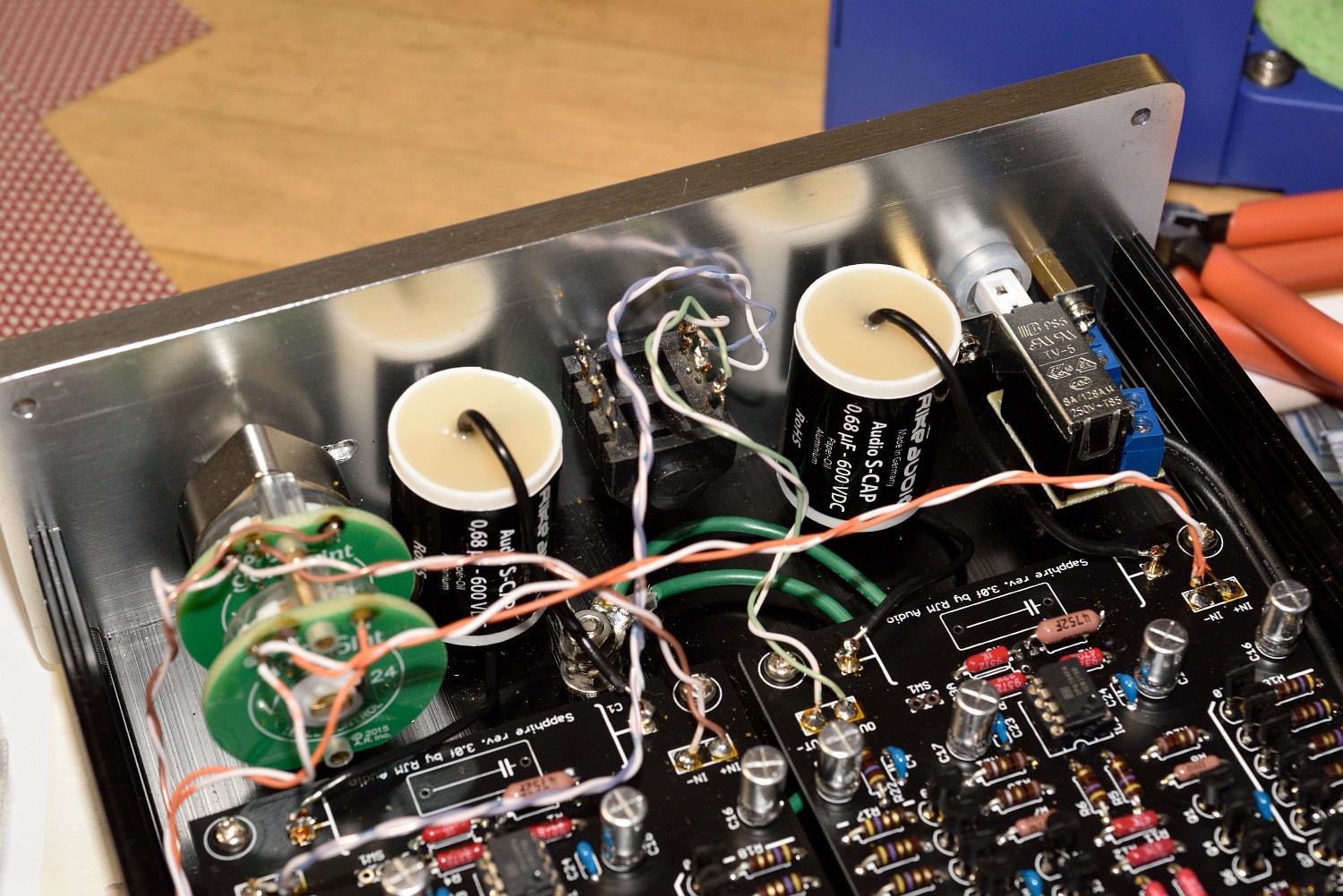

That ... they are really big!
(I've been away for a bit. Had a quick look before I left and realized mounting them in my case was not going to be trivial. I plan to at least connect them up and listen to them this weekend.)

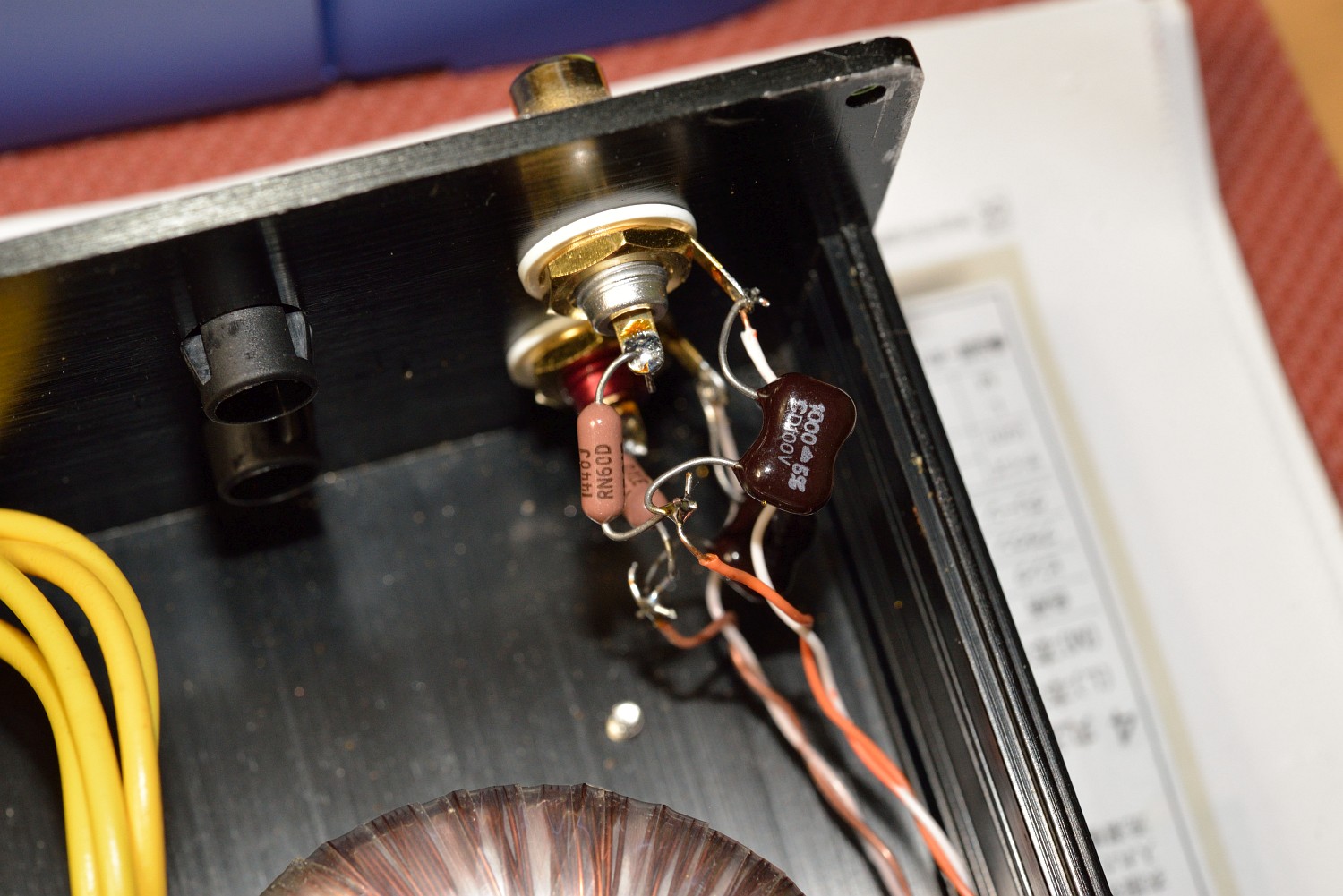

Bench notes:
Put the 100 pF caps C2,3 back on the boards, sound was too raw without them.
Also added an input RC low pass filter at the RCA jacks. This is something I've been meaning to try for a while: 1nF and 1.5k ohms to cut out radio frequency hash from getting to the Sapphire boards. The 3 dB point is about 100k, so anything above 500kHz should be strongly attenuated.
The problem isn't the Sapphire per se. but rather my source, an ASUS Xonar STX soundcard... which compared to Onkyo seemed to have more "dull sheen" that I tend to associate with RFI.
With the filter, the sound is somehow more vivid and distinct so I think it is effective, though the overall difference is slight.
This one's for you, Lance.
(Plasticine was later added to bond the caps to the front panel.)
The RFI is likely (assuming you've a typical PC containing a switching supply) to be common-mode noise. Normal-mode filtering helps but only slightly - use a common-mode choke (or several) or isolate with a transformer. Better still use a balanced connection to a PC but few 'consumer grade' soundcards have those, its more standard on 'pro' models.
I'm just one vote, but I would vote for RF filtering. There is a local FM radio tower/repeater about 1 mile away, line of sight. Filtering is much preferred over hearing that annoying top-10 pop rock during the quiet passages.
@abraxalito
I agree there isn't much that can be reasonably done with common mode noise when the amp is unbalanced and the input signal also. One is at the mercy of the op amp's CMRR, typically 100 dB.
It wasn't an audible as noise anyway. Just a slight greyness to the sound.

I took a look at your pic of the input filtering after I'd posted and I have found that doing the filtering that way isn't particularly effective. Reason being that the screen of the cable has the CM currents on it, so running an RC right at the input socket is using a 'dirty' ground. It'll be noisier than a ground on your PCB due to those noise currents. Try the caps to GND nearer to your star point (assuming you have one).
<edit> The 'greyness to the sound' is also my experience with RF (and also power supply noise) ingress. With no audio present there's no difference (either audible or measurable) in the noise floor. Play music though and the 'smog' descends - I figure its intermodulation that's doing the damage.
I'm really only looking at attenuating differential mode noise aka trash on the signal lines. The return currents for these is back through the input cable shield, so drawing the capacitor to the star ground would only allow these currents to run around the inside of the chassis causing what havoc they may instead of being directly sent out back the way they came.
For common mode noise, my position is I'm screwed regardless by using unbalanced interconnection so I'm not going to worry about it.

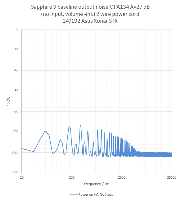

Notes from the bench: noise
In my house there is no earth wire. And that's a problem when you have a sapphire3 amp sharing a circuit with a computer, monitor, wifi access point and router/modem. All the switching power supplies pollute the AC line, and that RFI goes right though into the Sapphire3 amplifier and out the headphone jack.

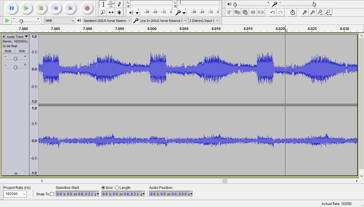

This noise is omnipresent. It is high frequency hash modulated with some 60 Hz signal to produce overtones throughout the lower end of the audio spectrum as well as ultrasonic. Doesn't matter if the inputs are detached, or if the volume control is turned down. As long as the amp is powered up, it is there. Left channel is about 6 dB worse than right channel, likely due to the longer wiring and proximity to the AC power switch and cabling.
The level is low, below -80 dB, and it is not audible except as a subtle degradation of the perceived noise floor, but clearly for maximum performance it needs to be addressed.
1. Use shielded cable for the chassis signal wiring.
2. Shield the AC wires inside the chassis which run up to the front panel mounted power switch and back to the transformers.
3. Rig up an earth connection to the power bar by running a wire to the drain pipe.

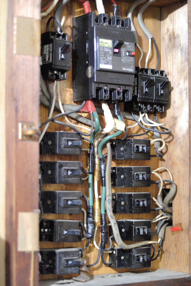

I find it hard to believe that this is building code compliant. Is it common in other parts of the world to have no Earth?In my house there is no earth wire.
Well, it was common in Japan until quite recently. Certainly anything built before ~1975 are just simple 2-wire. In older houses you'll most often see runs of zip cord just stapled to the wall.
For your amusement I'm attaching a photo of the main circuit break out box in my house. I'm in there fairly often, as using the toaster at the same time as the electric kettle trips the kitchen circuit. Dispite being built in the 1970's, the kitchen has no provision for a fridge. You are expected to use the pantry, under a trapdoor in the floor, or the insulated cupboard which I think was used as a small icebox. 😀
