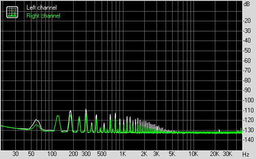

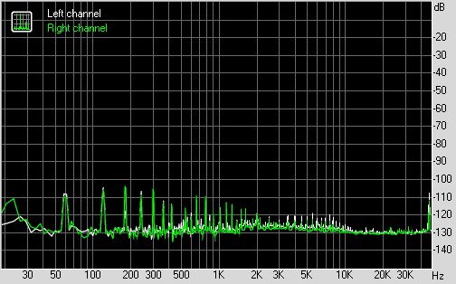

Things are much improved.
First plot is the baseline noise, vol -inf. no input.
Second is at 0 dB net gain, input connected, default RMAA measurement setting.

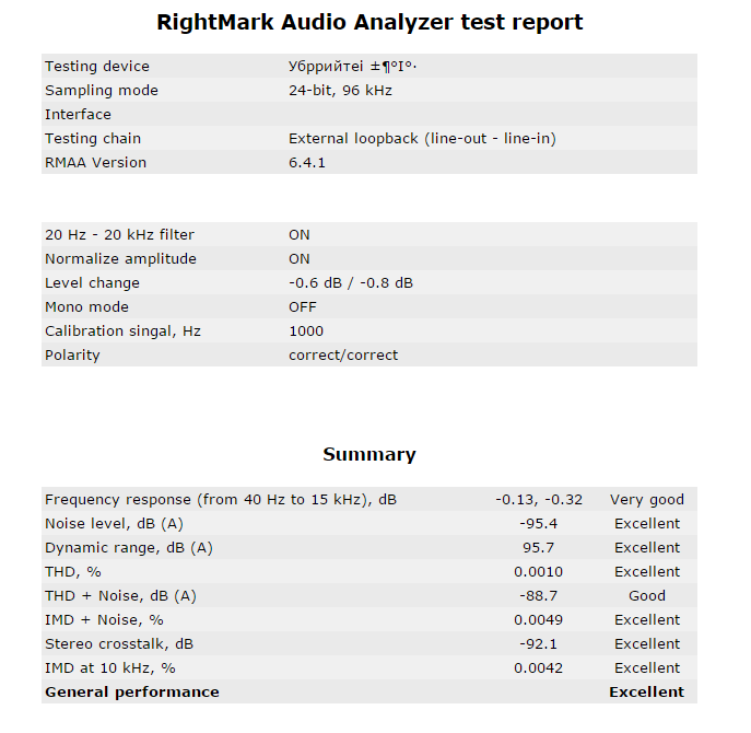

RMAA results posted for reference. Channel imbalance is the input section of the soundcard, nothing to do with the Sapphire3. All measurements were performed with the amp unloaded. ASUS Xonar STX soundcard.
The chassis is connected at the headphone jack, and the transformers shielded. (other changes, new Oyaide cable to connect amp and soundcard input, and fixed a possibly cracked lead on the left channel at the output.)
Despite the peaks in the FFT, the amp is 'is this thing on' silent for all intents and purposes.

that looks superb Richard.
been messing with mine as well 50hz is now around -80db@50hz (with RPi connected).
removed the input resistor and bridged, removed feedback resistors to 1k and 10k (still plenty loud enough) and added a 2.2uf cap (could do with being bigger) to the + output which gives me 0dc at the headphone socket, reduces the bass slightly but cleans the top end up and vocals are much smoother. all in all about the same but cleaner sounding.
