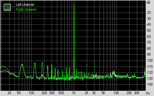

Q. if i took some two core microphone cable and used the two cores for hot/cold then connected the screen to GND on the boards would that screen the cable from interference?
well that worked really well. i got a reduction of around -6db so now sitting around -86db@50hz. i can now touch the input cables and the 50hz does not move where before it would rocket to around -50db@50hz. plot looks a lot cleaner as well with less spikes, i now have no spike at 100hz, -90db@150hz and getting smaller every 50hz till around the 400hz then pretty much nowt all the way up to 20k. 1k-20k i'm getting a pretty flat -120db to -123db.
still getting a really weird ripple though.
next up i'll try taking the daughter boards off the rectifiers and wire them direct.

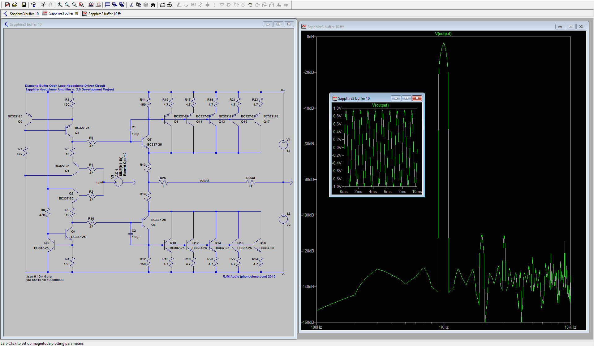

Today I got around to measuring the distortion under a test load. I haven't been too concerned to do it before now as I was pretty confident in the simulation.
The measurements indeed confirm the simulation, within a factor of two.
Test conditions 47 ohms -3dB FS (0.7 Vrms 1 V amplitude). This is 10 mW per channel, about the maximum you would ever apply to a headphone in real life.
Measured THD 0.0016 % (-95 dB). Simulated result gives about -110+6+3 = -101 dB or 0.0009%.
While the results will be slightly worse for very high or very low load impedances (47 ohms is close to he optimum design point.) I'd still like to brag a little:
The Sapphire3 headphone amplifier, with no feedback in the output buffer, achieves <0.002% THD at 10 mW. 🙂
The unloaded THD is 0.0009%. The noise floor, incidentally, is equivalent to an input referred value of 8 nV/sqrtHz, exactly the datasheet value for the OPA134. In other words apart from the harmonic spikes I've hit bottom as far as the baseline noise is concerned.

I did the simulation:
R11 and R12 to 680 ohms.
R3 and R4 to 100 ohms.
Evident that consumption is doubled, but with more power without compromising distortion.
Am I right or I do it differently?
@abraxalito Yes, I know to keep handle it as gently as possible, but I will have to cut it into strips regardless. I was thinking I could reanneal it after forming, but apparently it has to be done in a dry hydrogen atmosphere which I do not want to mess about with due to the explosion risk.
@felipeunix Changing R3,4,11,12 (ltspice schematic, above) adjusts the bias currents. Using 100 ohms / 680 ohms triples the bias in Q9-18 from 33 mA to 100 mA total, so the distortion : output power curves shift upwards proportionately. The change you suggest also reduces the quiescent current to Q7,8 to 1 mA however, a bit lean to drive 5x20 mA Q9-18 (0.2 mA quiescent base current) though the simulated distortion indicates improvement. Q9-18 now dissipate 220 mW each, which will increase the temperature 35 C above ambient.
TL;DR : The as-designed operating points of the Sapphire3 are conservative, you can "overclock" it up to about 100 mA without major drawbacks if you want.
Formally the stock Sapphire3 output power is about 100 mW 16-300 ohm, if the distortion limit is relaxed to 0.1%. My obsession with 10 mW is as a "realistic maximum" for which the distortion would still be relevant. My design goal there was 0.001% THD (-100 dB) at 60 ohms : 10 mW, while measurements confirmed 0.0016% / 47 ohms. Close enough, as far as I am concerned.

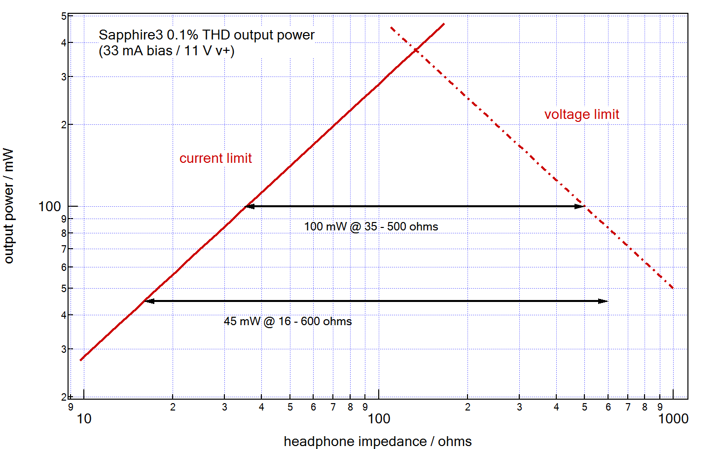

I've posted similar data before, but to recap and with a new graphic:
The output power defined by 0.1% THD (threshold of hard voltage clipping, or the output stage transitioning to class B operation) depends on the headphone impedance. Between 35 and 500 ohms, at least 100 mW is on tap, while the specification must be reduced to 45 mA to cover the full range of headphones between 16 ohms and 600 ohms.
The deeper you are under the red "hat", the lower the distortion will be, with the Sapphire's optimal headphone impedance being about 60-300 ohms.
When listening to music with either my HD600 or K702 cans, I'm not even on this plot. The maximum (source 0dB) output power at my listening volume position (it works out to 95 dB SPL) is 0.6 mW for the HD600 and 1.6 mW for the K702s with the actual average music power about 10 times less. So while 100 or 200 mW output might look nice on paper, it is irrelevant to the problem at hand, which is how good the amp can make <10 mW sound like.

i'm confident that i have tracked the problem down to my power supply causing the ripple.
i removed the daughter boards from the rectifiers and still no joy. i swapped the MK2 boards back in and still no joy. so next up is removing the power switch from the power supply and see what happens if still no joy then its either the transformer or the bridge rectifiers.
removed switch and soldered the transformer wires straight to the euro socket tabs. still no joy. looks like its the rectifiers or transformer. is it possible to over spec rectifiers as they are 400v 35A?

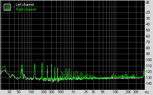

You mean, I guess, the source of the residual noise when the RPi is taken out of the equation. It could be the transformers, but don't you have an external power supply?
To avoid going on a wild goose chase, I suggest double-checking the loop-back noise to make sure it isn't just garbage generated by the soundcard or picked up by the cables. In other words, disconnect the test signal feeding the headphone amp and connect it instead straight into the soundcard and remeasure to get a feel for the baseline sensitivity of the test setup.

thanks Richard, i never even gave that a thought. i looped back the sound card too itself and it was just like the reading i was getting from the Sapphire. i'm charging up the laptop to try that as it should be less noisy.
who's a clever clogs.. Richard is 🙂
recorded on the laptop running on battery power 🙂
dont know what the amplification is as the laptop has a seriously rubbish sound card but i boosted it up just to show there is no ripple.
so the ripple has been my main desktop soundcard all this time.

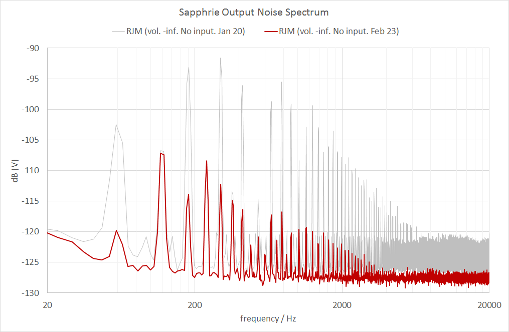

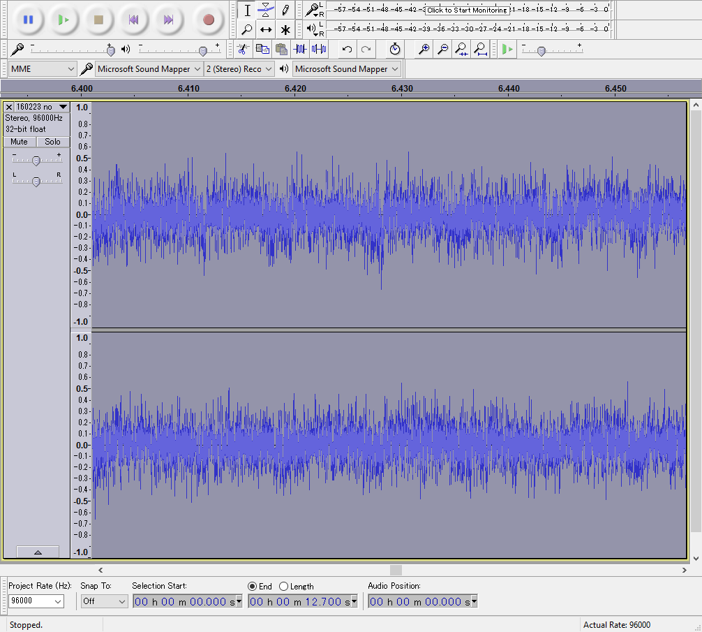

Permalloy sheet (via ebay) cut into strips and wrapped around the transformers.
Effective!
(note: Audacity screencap is displayed at 80dB gain now rather than 70dB, since the noise is so much less.)
Effective!
that looks a loooot better.
i suppose in hindsight i should have got troidy to wrap my trafos with mu-metal instead of just a band. hhhmm there's a thought i wonder if i made up some top/bottom hats out of mu-metal it would work the same due to there already being a band.
Hats, or cans, or chassis dividers. Anything like that should work as far as I can see. Just wrapping mu metal bands around the toroids gave 10 dB reduction of noise spikes in the midrange region.
