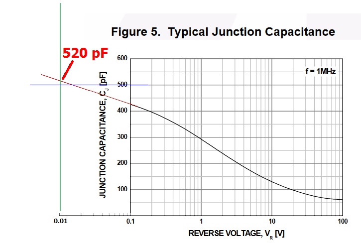

If you use different diodes you'll need to check that their capacitance at zero volts of reverse bias, is far far smaller than Cx (3.3 nanofarads). The FFPF30UP20S diodes in the RingNot Bill Of Materials, are about 0.52 nanofarads according to Fairchild's datasheet: attached. Since 0.52 nF is far far less than 3.3 nF, this diode works fine with the (Cx,Cs,Rs) snubber values shown in the B.O.M.

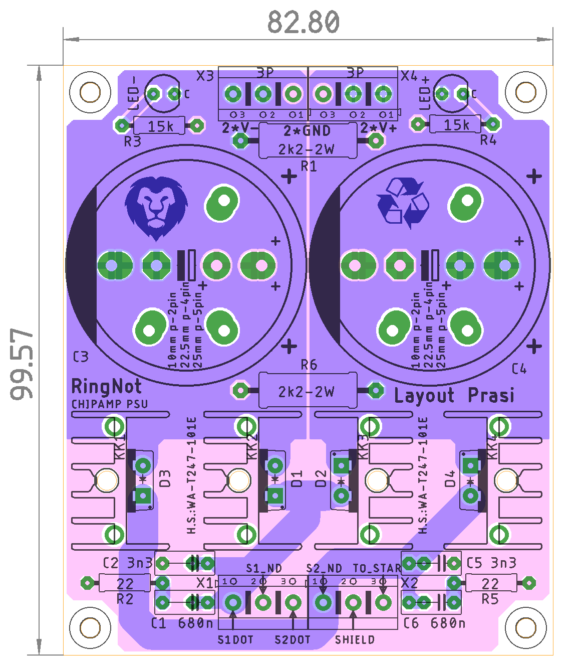

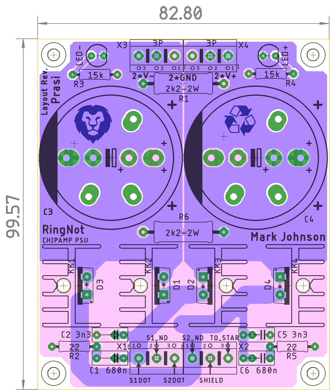

Hello,
Here is a draft clone of ringnot PSU but with some options for components
1. snubber caps
2. Heatsink
3. Bulk Caps
I am also thinking if one could use a SK104 type heatsink with diodes attached on either side..
Mark, a question for you, How well would it work with default snubber components for those who dont have the set up?
150nF-150R-10nF? for a different transformer and may be slightly different voltages.
regards
Prasi

Hi Prasi, very nice board! I request that you remove my name from the silkscreen since I will not be providing "technical support" for your board.
The optimum snubber component values depend upon the particular details of the transformer used. For the Antek AS-2222 and AN-2222 transformers, the values in the RingNot schematic (post #1) are acceptable. For a different transformer, you will need to either (a) measure the transformer secondary leakage inductance and then work through Jim Hagerman's equations; or else (b) connect it up to a bellringer test jig like Cheapomodo and find the optimum component values without doing any math calculations.
I also think people would be grateful if you would type out the exact part number of the heatsink your board design requires, made by Aavid and/or Wakefield and/or Ohmite and/or CTS.
Thanks for your comments Mark. I can only make options available to users in component choices on the PCB, its the end user who has to use components based on is better judgement and /or measurements.

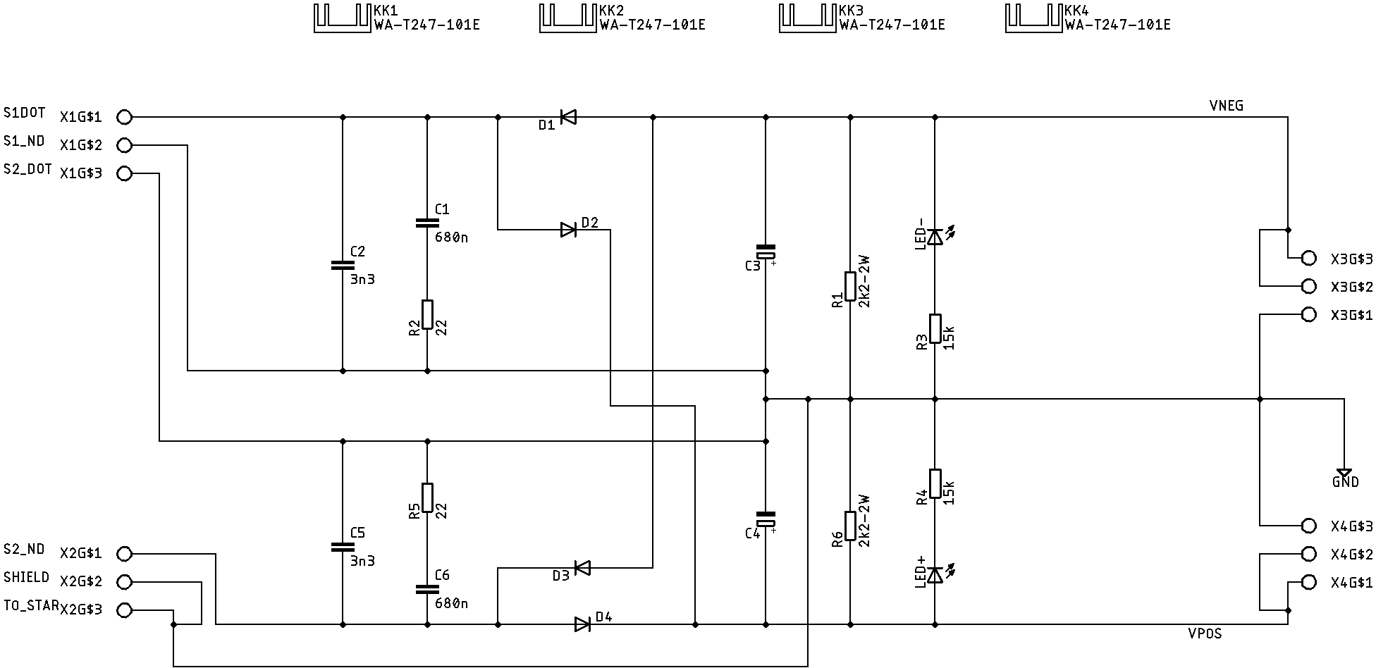

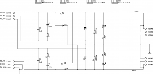

To others interested,
here are the gerbers which could be used on easyeda for 2USD + shipping for 10 PCBs. ALso attached is the schematic and stuffing guide.
There are many heatsinks that could be used on this layout, e.g. http://www.mouser.com/ds/2/303/w-sink-181565.pdf
or cheaper option 5 Pieces 25x23x16mm Radiator Cooling Fins TO 220 TO220 Extrusion Aluminum Heatsink-in Fans from Consumer Electronics on Aliexpress.com | Alibaba Group
here is another cheaper option but cant say about its
and many others.
similarly, the main bulk caps could be 10mm pitch-2 pin, 22.5mm pitch 4-pin or 25mm pitch-5pin.
All the best!
Regards
Prasi

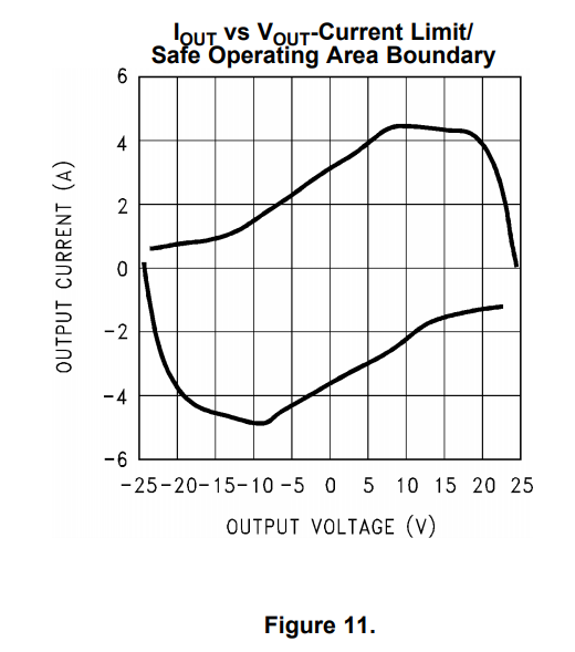

If it was me, if I wanted to drive a stereo pair of LM1875 chips with one RingNot PSU board, I would study Figure 11 of the LM1875 datasheet. It appears to me that a stereo pair of 2xLM1875 might, in the very worst case, draw (2 x 4.5 amps) from the positive supply, and (2 x 4.5 amps) from the negative supply. So I would be inclined to select diodes whose current ratings exceed the very worst case. Other designers might have a different opinion of course.
