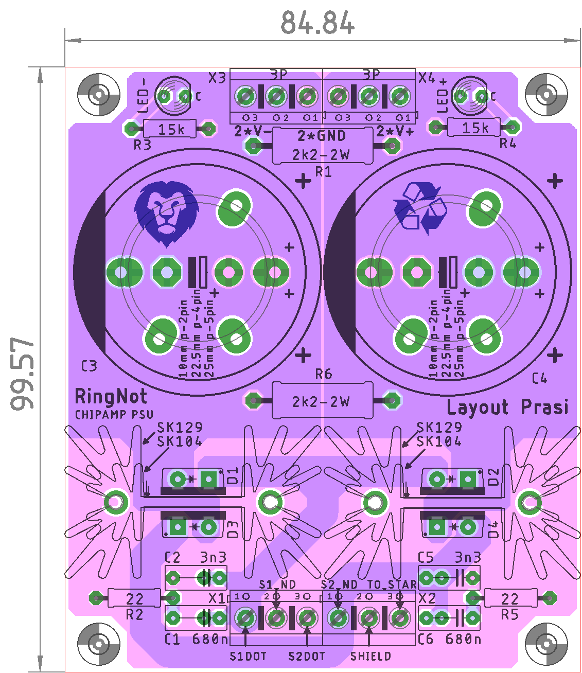

MUR860 is 8A diode so its ok, insulation is ok.
On both diodes cathode is right pin, so i guess its ok to use them instead.
insulation is not ok. You need to use sil pad or kapton + TO-220 bush to isolate mounting screw + the heatsink from the metal tab of MUR860. otherwise its a hazard if heatsink touches any metal part or flesh:scared:.. ..
When I had a bunch of RingNot boards fabbed in China, I specified 1_oz copper. I notice that the USA fab called OSH Park does not charge extra to build boards using 2_oz copper instead of 1_oz, just longer shipping time. You could consider that.
Prasi, that new PCB layout looks nice! Bigger heatsinks would allow the use of Super High Vfwd diodes that were so fashionable and trendy in the 1990s. Big current and high Vfwd means big power dissipation in the diodes, which means you want big heatsinks.
Paranoid builders might want to install a thin rectangular sheet of insulation (e.g. mylar) between the heatsinks and the top of the PCB. Just in case the soldermask rubs away over time. If a short does occur, the well grounded heatsink gives a very low impedance current path, which hopefully causes the fuse(s) to blow very quickly.

Concerning RingNot PCB, the actual topic of the thread you're reading now, there are a few reasons why I recommend ONLY the Antek AN-2222 or its electrostatic shielded brother the AS-2222, with the RingNot PCB:
1. It has the right output voltage and the right VA rating, for a two channel power amp using LM3886's ("chip amps")
2. It's the exact transformer I used during design and testing of RingNot

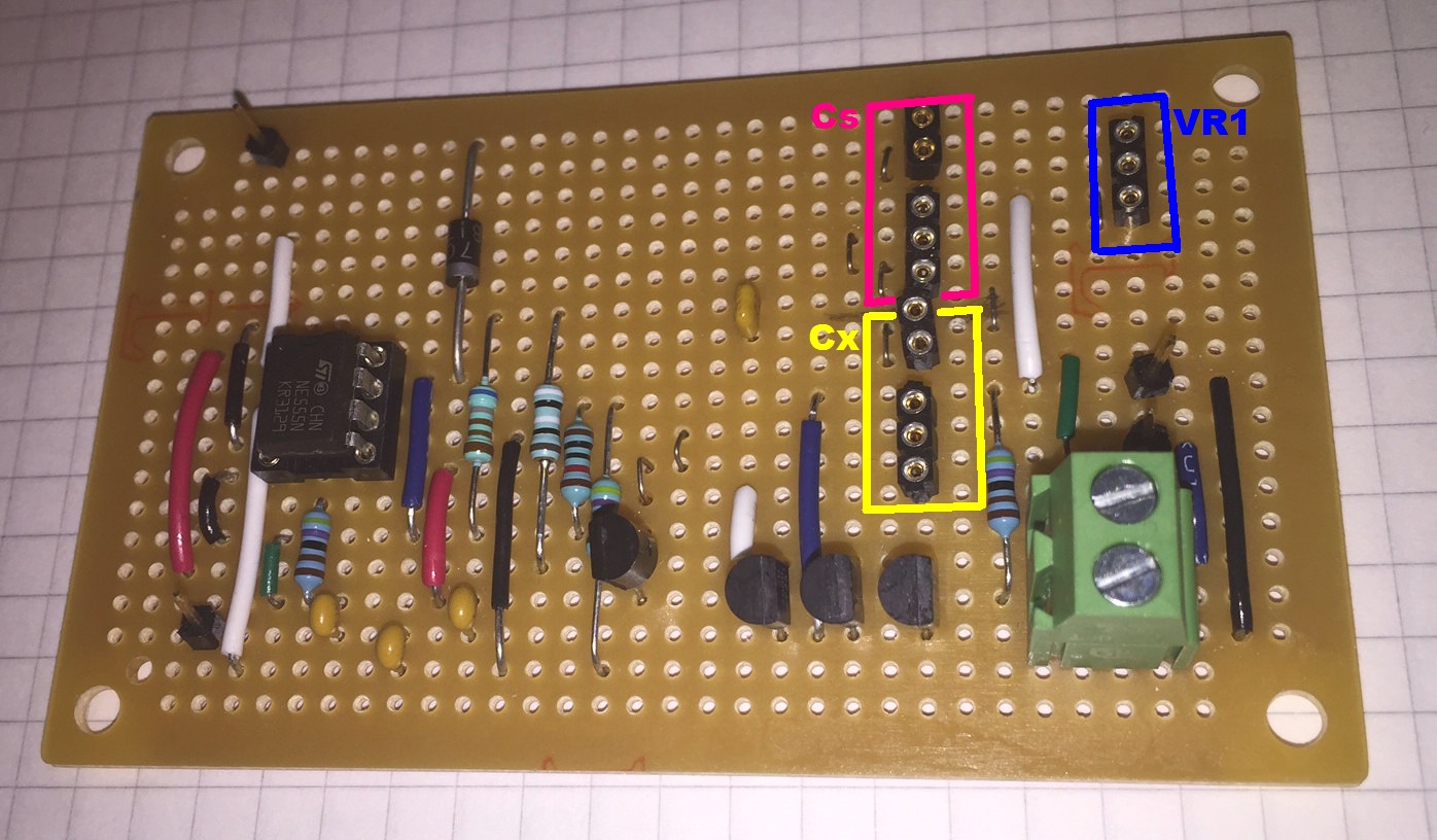

3. The anti-oscillation snubber component values (C1, R2, C2) shown on the RingNot schematic, are tuned & optimized for the AN-2222. They were physically installed and measured and tweaked, in-circuit with an AN-2222, using a DIY "Cheapomodo" test jig. Mine is shown in the attachments below; many dozens of other diyAudio members have built their own Cheapomodo, on PCBs, pluggy-innie solderless breadboards, perfboard scraps, etc.​
To use RingNot with a new, different transformer, your circuit designer will need to optimize the anti-oscillation snubber component values for that new transformer.
