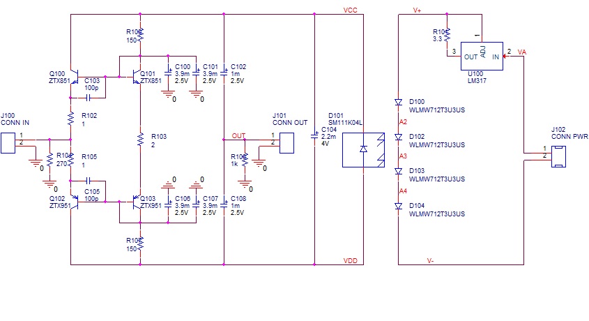

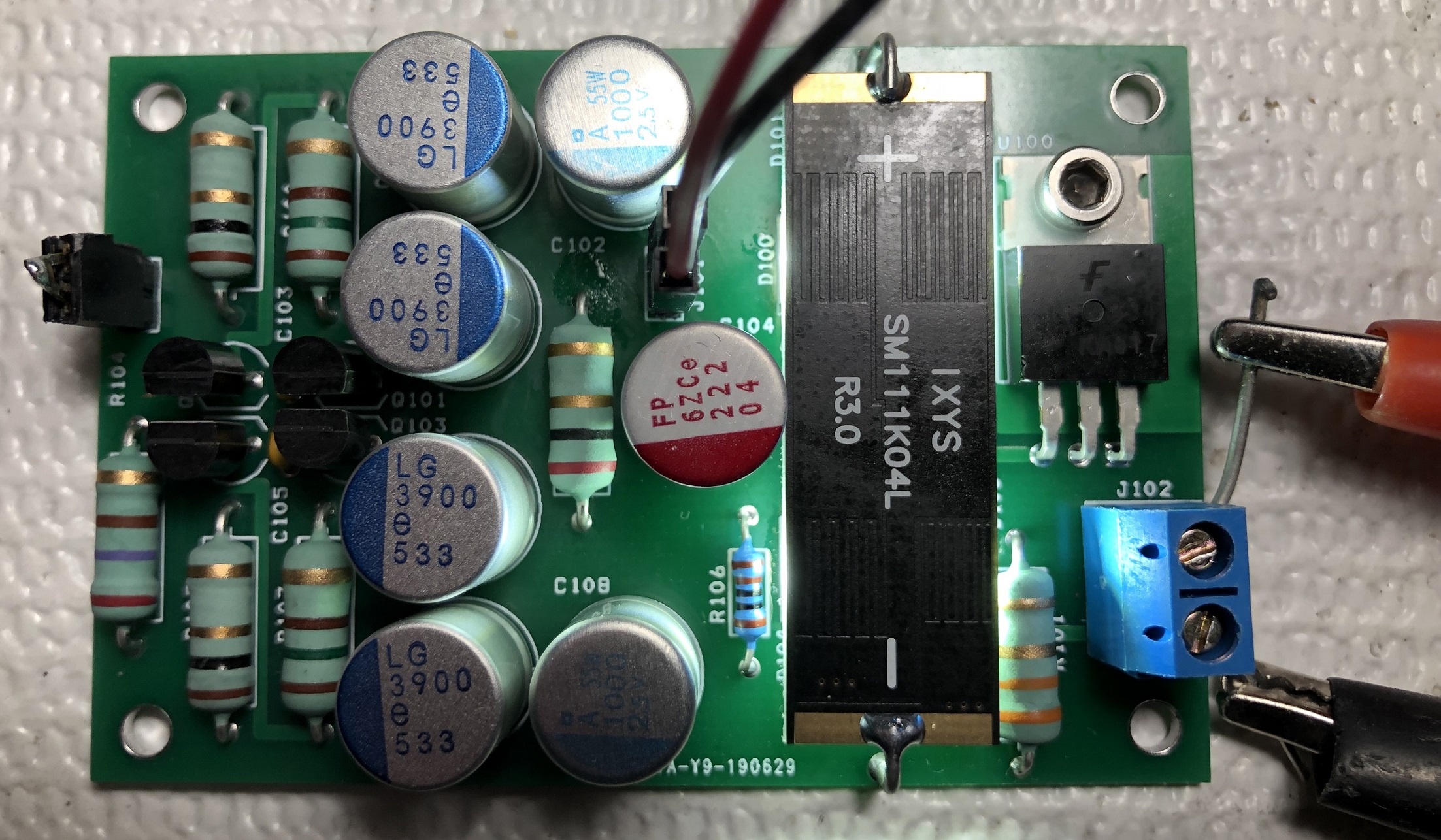

Ok, because it's summer and holiday season in NA, I had the time to put together, out of curiosity, some of the ideas in this topic.
Schematic is attached. It's the adapted current mirrored version of the Leach head amp. Power supply is provided by a solar cell illuminated by four spectral matched white power LEDs, running at 350mA. The constant current is provided by a LM317.
The solar cell has a measured open voltage of 2.7V and a short circuit current of 70mA. Way over what is needed for this pream, so the LED current could probably lowered to 150mA, if not even less. Current through transistors is about 5mA, so the whole setup takes only 10mA out of the solar cell current capability. The rest of the schematic is self explanatory. A photo of the finished and powered circuit is attached. All electrolytics are of the polymer type, for the lowest ESR, all resistors (with the exception of the 1k at the output, which is metal film) are of the wire wound type, for the lowest excess noise.

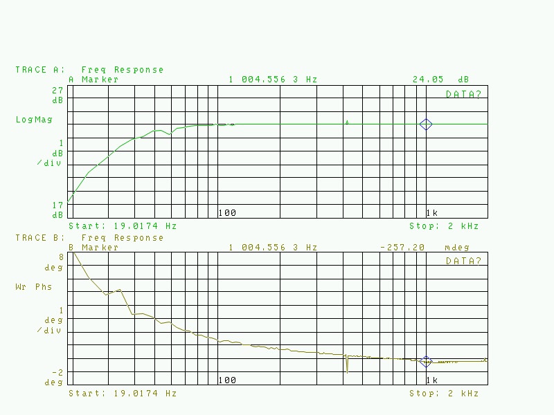

The gain is 24dB @ 1KHz, see attached. Unfortunately one of the issues with this pre is now obvious; the LF frequency response is lacking, for a MC cartridge we would need a drop @20Hz of less than 0.2dB (I'm not saying this is an absolute requirement, but some purists may protest for anything worse). This lack of LF response is obvious from a napkin calculation, 4x3900uF decoupling (a total of 8pcs.) or more would be required. The other option is to increase the supply voltage (use a different solar cell with higher open voltage) and then increase the collector resistors, proportionally.

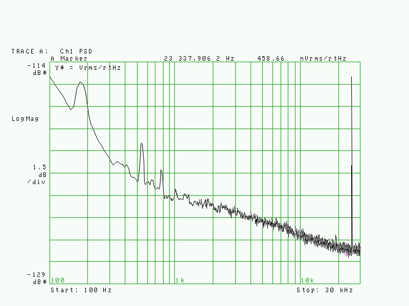

To measure the noise (input shorted) I used my low noise preamp, with a calibrated gain of 60dB, so the total gain is 64 dB. The output noise is attached, 450nV/rtHz, which renders an input referred noise of 280pV/rtHz. That's good, and reasonably close to the simulated value (200pV/rtHz). In fact, is close enough to be happy about the HF noise performance of the solar cell output, filtered by a 2200uF electrolytic.
The not so good part (actually, the really bad part) is the significant amount of LF noise, straight in the audio band. As you can see in the attached, @1KHz the noise is almost 6dB worse, which is 560pV/rtHz. Still good for a MC cartridge, but the whole complication with solar cell, LEDs, etc... is hard to justify at this noise level, you could get it with a much simpler setup. I have no idea why this increase in the LF noise (simulation tells (of course) jack ****) in particular because it does not appear to be 1/f noise, it could be still GR noise from the solar cell, insufficiently filtered out. I'll keep looking at this, I have enough boards and parts to do a few more experiments.

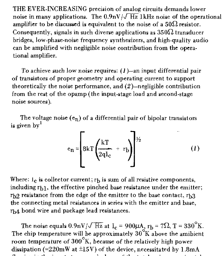

Here are the first few paragraphs of George Erdi's 1986 paper on the LT1028, delivered at ISSCC. In my opinion they are a good introduction.
A Bipolar Opamp with a Noise Resistance of less than 50 Ohms
