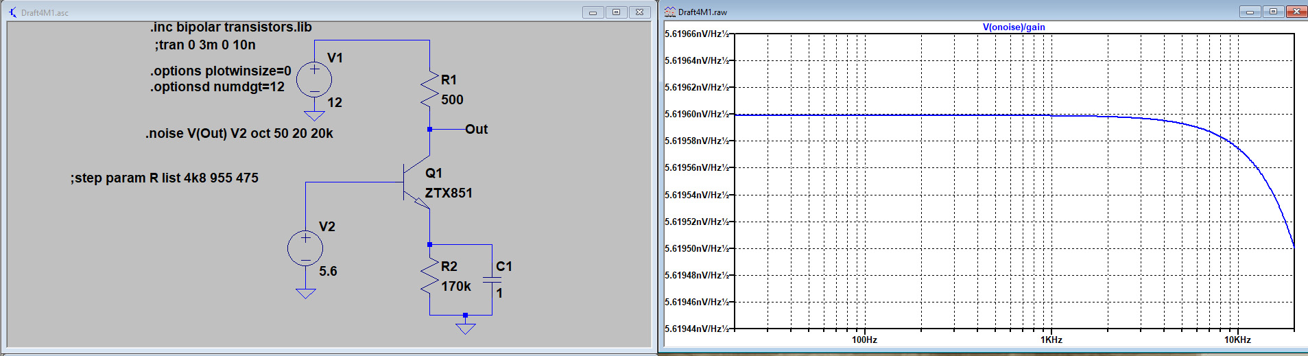

O.K, I have adjusted to Ic=30uA.No Hans I had earlier said Ic, sorry, Ic = 30uA, Rn = 1/2gm. I am looking at an individual device to check the model only and I see no deviations.
This is what I get with the ZTX851, RB set to 1R5.
Measured noise: 5.62nV/rtHz
1/2gm noise: 2.64nV/rtHz
Calculated Rbb: 1478 Ohm
A huge deviation so to see.

Make the collector resistor 50k. At those current values, the resistor current noise matters.
With Rc=50k I get 2.78nV/rtHz which is 480ohm. Real Ic is 28.6uA, 1/2gm is 437ohm, not that bad.
That's a lot better.Make the collector resistor 50k. At those current values, the resistor current noise matters.
I get 2.72nV/rtHz at Ic=30.15uA, that's 444 Ohm versus 1/2gm=397 Ohm.
Quite comparable to your results.
Hans

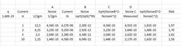

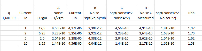

When I saw Hans' first table, I was tempted to do my 1980 Baxandall type analysis but it looks like syn08, Hans & Guru Wurcer have done most of the necessary work.When I increase the collector resistance with my previous measurements from 1mA to 10mA, the table becomes as below.
Rbb now varies between 1R58 and 1R97, quite a lot better as before.
But perhaps I should check if my single brain cell is still working. Hans, can you explain what are
- Current Ib: is that base current?
- sqrt(2qIb)*Rb
- is Rb actually rbb' ?
- Noise C measured: is that Noise Simmed by LTspice?
Ib is base currentHans, can you explain what are
- sqrt(2qIb)*Rb
Sqrt(2qIb)*Rb is part of the input voltage noise caused by Ib and Rb
Rb used was the calculated Rbb, but outcome is neglectable in this case
Noise measured is what LTSpice has calculated
Hans

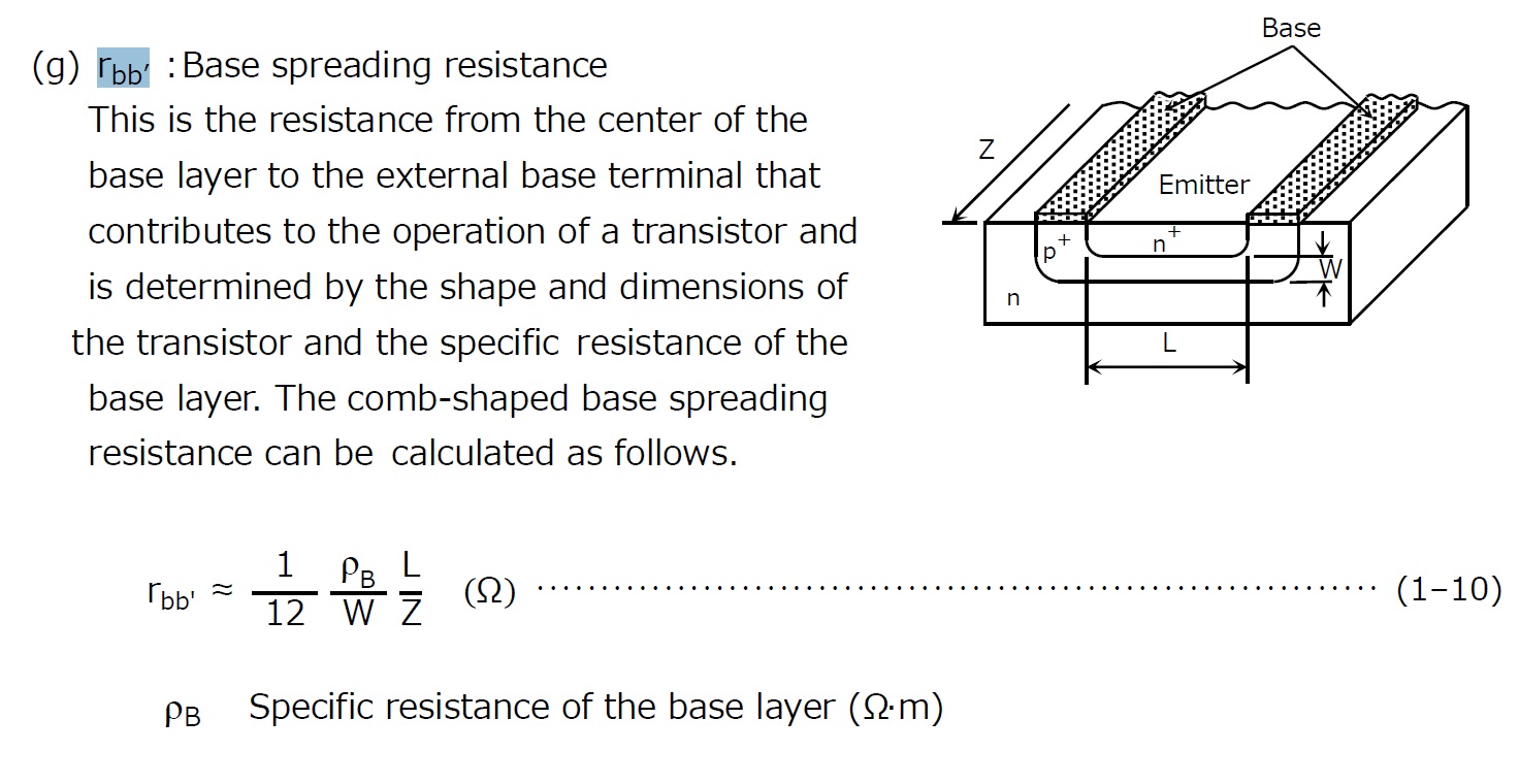

I though rbb' is the whole p/n base resistance, from the mean point in the active base region that acts as an effective base point, to the metal/semiconductor base contact. This is more than the resistance under the emitter.
As you say, the Spice RB is the sum of rbb' and the rest of the extrinsic components (base M/S contact, metallization, wire bonding).
Possibly a fine point, I always though it was the region where the boundary conditions were easily defined so the integral that defined the resistance was simple and tractable. For uniform injection in the emitter it would be the edge of the emitter, after that there is an extrinsic (rbx) component simply computed from the base sheet and geometry.
That's how I was taught, Rbb is the "base spreading resistance". Toshiba in the the application_note_en_20180914.pdf app note (google it, too large to attach here) on p. 8/28 seem to agree.
Yes the formula there covers the 0 to L region. Actually using centroid symmetry it would be -L/2 to L/2. Uniform injection gives a parabolic voltage distribution so that's were the factor of 1/3 comes from and integrating from 0 to L/2 and paralleling the two halves give 1/4 or the 1/12 net in the formula (IIRC). I was just talking about the little piece of p+ going from L to the actual contact, a trivial point.

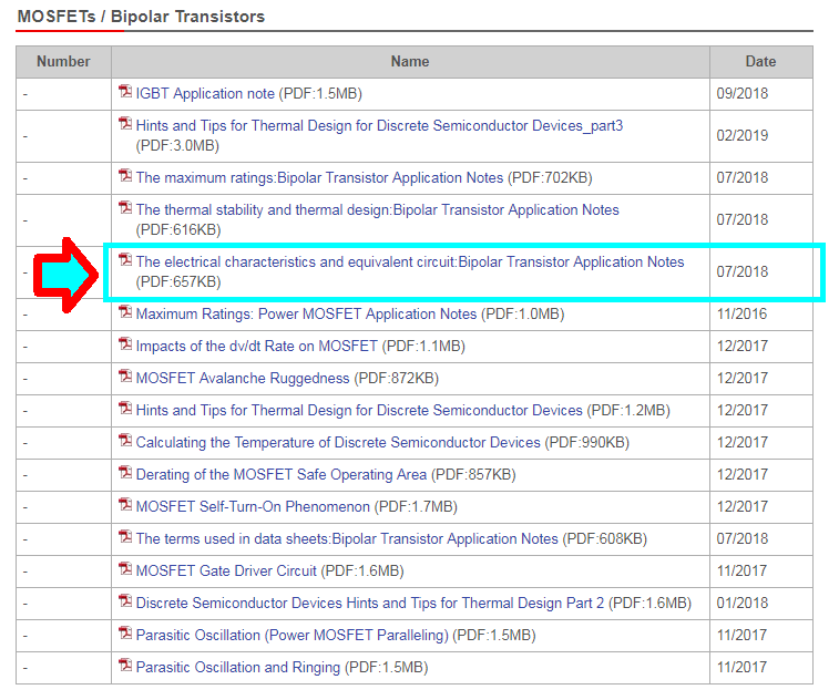

For those playing along at home, the download page is
Application Notes | Toshiba Electronic Devices & Storage Corporation | Americas – United States
and the title you wish to click upon is shown in the image file below
_
