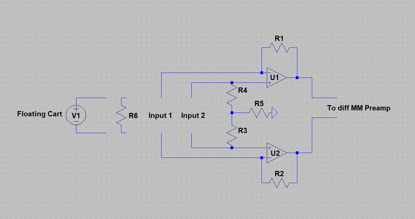

My HH simulation includes power supply noise.
A 60 Ohm resistor delivers 1 nV/rtHz. it is multiplied as needed with a VCVS.
That is added to the clean power supply. A microvolt offset or so is needed
to prevent LTspice from crashing. That is dwarfed by the clean supply.
You can plot the influence of the PS noise with the expression onoise(R60Ohm)/gain
in the usual way. It is demonstrated in the HH amplifier for 2 nV/rt Hz. That's what
an LT3042 / 3045 can deliver. Still OK.

Gerhard how did you insert your 60 Ohm cal noise into the 20 op-amp circuit? The Ib noise would seem to add at least some error, small, and maybe I just missed it.
I've done this for a number of circuits. My exercise with Leach was built, measured and was/is used in a number of real life MC vinyl playback systems from circa 1980Oh, incidentally, before claiming to be able to "throw bits out & get better performance", perhaps it is advisable to build in real life first .....
In real life, that is, not in Spice.
I don't usually post stuff I haven't tried or persuaded someone to try. But I was so impressed by Hans' work on MM cartridges that I thought I should help him out with his hero, JC. That one hasn't been built this Millenium but I might have tried it circa 1980. If I did, there must be some reason why I rejected it so I'm eager that someone builds, measures and tries it in a real life MC vinyl playback system ... compared directly with mine of course 😎
I'll pass on other circuits where I've thrown bits out & got better performance as I'm conscious I'm already waving rude bits around 🙂 The reason I throw bits out is cos my small brain has difficulty understanding stuff with loadsa bits 😀
Yes. For this, the Leach topology is a lot better than JC's or anything with grounded PS. ... which is why I still recommend my Duraglit battery special. 😎syn08 said:To my experience, power supply noise injection is the largest contributor to excess noise (on top of what an accurate simulation of the signal path predicts).

No, there is nothing wrong; you need twice the number of transistors to go from single ended to differential and then double that again to make up for the 2 BE junctions in series, so 4 times the number of transistors all in all. Win Hill is a regular in the usenet group sci.electronics.design and we have discussed my amputated version of his amplifier there shortly. We still are friends. 🙂
google groups is a clumsy back door to s.e.d.
Scott: The 60 Ohm cal resistor at the input still works quite OK for the 10*2*ADA4898. It still delivers the expected voltage noise levels. Maybe the the 4898 is even better so it can afford the slight handicap. 😀
For the H&H amplifier, one definitely cannot ignore the noise current. I think I used ~0R6 there. It should be visible in the simulation if set up so.
snip here, put this in a file and call it 16xZTX851.asc and use it with LTspice: (May need a larger Rbb or so to conform better to reality)
green: all in all performance
red: noise of transistors
grey: contribution of VCC noise.
m=16 means 16 of these thingies in parallel.

Gerhard,Scott: The 60 Ohm cal resistor at the input still works quite OK for the 10*2*ADA4898. It still delivers the expected voltage noise levels. Maybe the the 4898 is even better so it can afford the slight handicap. 😀
Very elegant way to add calibrated noise to a line as you did with the 60R resistor and a VDVS.
Thanks for the idea.
Hans
