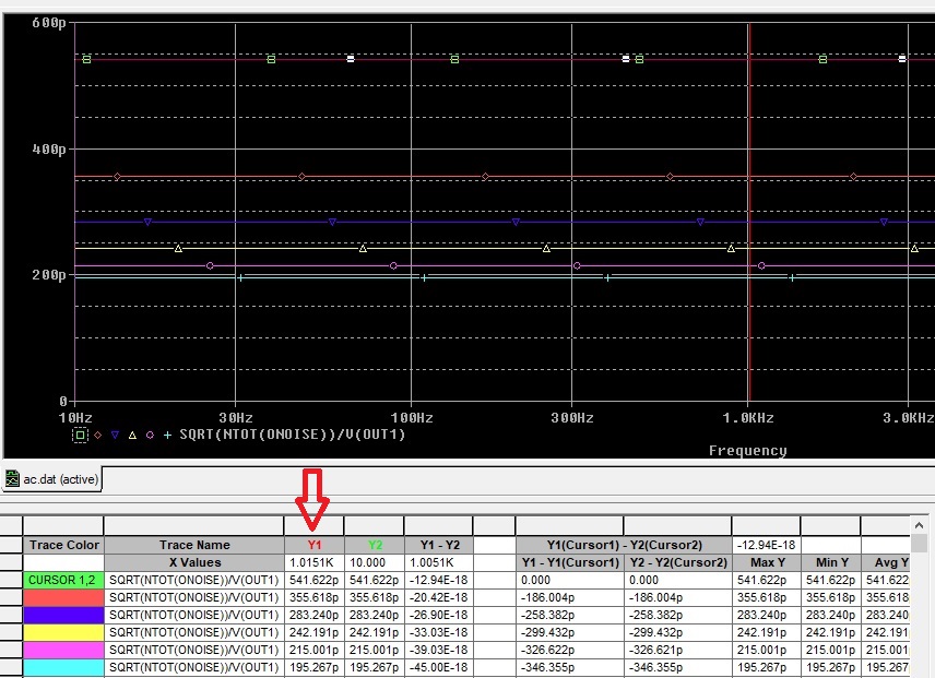

In LTSpice using the same layout and calculation and the same Rb=1R5 as you did, I get resp. for Rbb:I wonder why nobody had the patience to do a trivial spice exercise and identify the noise properties of the transistor model. Here's what you get in PSpice, it LTSpice provides the same, then the discrepancies are elsewhere in the schematics.
noise-schematic.jpg, schematic for the test
noise-default-model.jpg, result for ZTX851 default model @ Ic=5mA. Flat noise (as expected) 211pV/rtHz. gm=5*40=200mS, rendering a noise source of 1/(2*gm)=200pV/rtHz. 211pV/rtHz simulated vs. 200pV/rtHz quick pen and paper calculation, couldn't get closer.
noise-with-RB.jpg, result for ZTX851 with RB=1.5ohm same Ic=5mA. Same flat noise (as expected) with 263pV/rtHz. This is 4.3ohm equivalent. Now subtract the SQRT(2*q*Ib)*RB noise and the 1/(2*gm) we get the noise calculated Rbb=1.8 ohm, pretty good fit, if you ask me, with RB=1.5ohm used in the model.
noise-with-ic.jpg, results for ZTX861 with RB=1.5ohm and variable Ic, 1mA to 7mA top-down in the table. Checking for extremes, @1mA we get a noise calculated Rbb=3ohm and @7mA we get Rbb=1.75ohm
Conclusion is that the noise equivalent Rn=RB+1/(2*gm) approximation for the noise holds only for larger collector currents. At low collector currents, this approximation is optimistic. I'll check again the bipolar model template and the default values in PSpice to understand this discrepancy at low collector currents (1mA or lower).

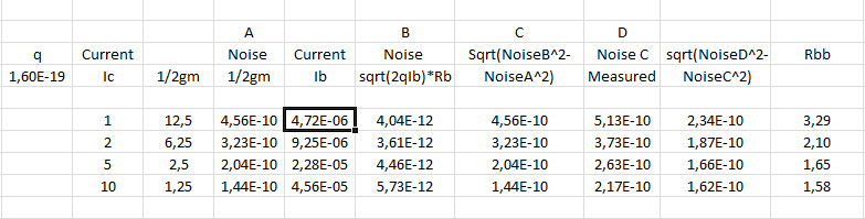

1mA Rbb=3R27
5mA Rbb=1R65
10mA Rbb=1R58
So LTSpice is returning more or less the same results as a pro version of Spice. That's encouraging for setting up a common baseline. It would be interesting to figure out why the 1/(2gm) approximation doesn't hold below Ic=1-2mA.

I'm not sure this is a problem in practice. Taking Hans' LTspice numbers ..
At 1mA, 1/2gm = 12R5
So Rnv = (1/2gm) + rbb' is either
12R5 + 1R58 = 14R08 using the 10mA 'measured' value
or
12R5 + 3R27 = 15R77 using the 1mA 'measured' value.
This is a difference in Rnv of 15.77/14.08 = 1.12 which is less than 0.5dB
If you are running 1mA, you will be matching a source of 25R or more so the total noise 'error' will be much less.
I'm not sure, even in da 21st century, you can reliably measure a noise difference less than 0.5dB so I'm happy to take the SPICE numbers as a guide to potential noise performance.
But like Hans & syn08, I'm interested in what Guru Wurcer has to say about these EVIL SPICE errors 🙂
Guru Wurcer?

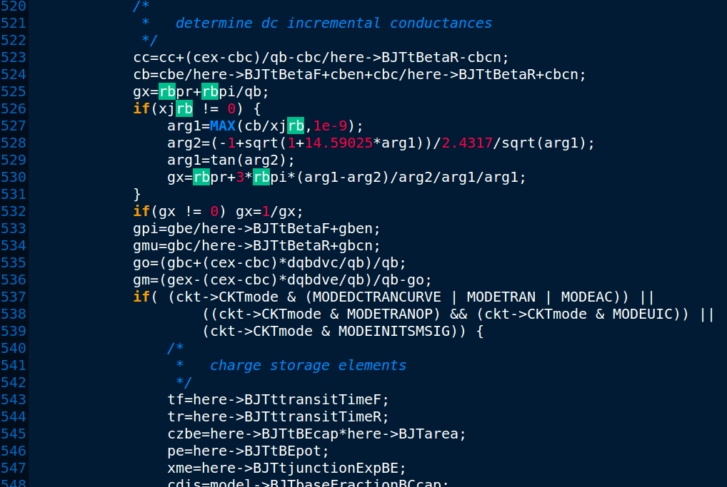

Source code has nothing to do with, it must be related to the bipolar transistor model.
What circuit is everyone using, if looking at lumped together noise alone the collector shot noise has to dominate at the output?
EDIT - At 50uA Ic I get exactly 2.05nV the right answer.
Of course, the source code has everything to do with it.
What you call model are just some parameters.
The real bjt model is in the source code - and where the rubber hits the road,
the transistor must be plugged into the conduction matrix. From there,
you can trace back and see how the parameters are mangled.
For ngspice, it seems to be in ...../ngspice/src/spicelib/devices/bjt/bjtload.c
Cloning the source repository to my local disk took less than 5 minutes.
I simply searched for rb in the obvious place.
No, I won't dig there. I have enough uncompleted things.

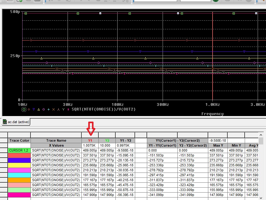

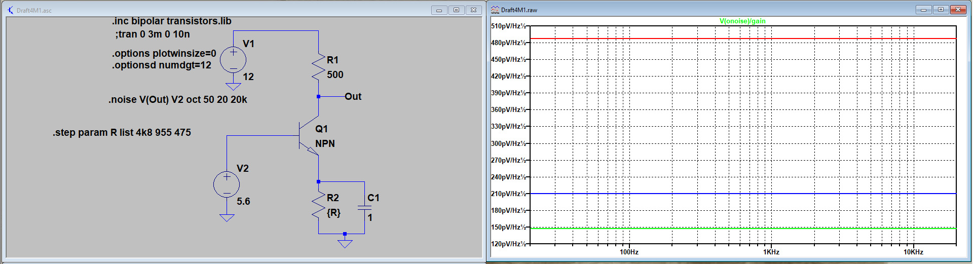

With LTSpice and a generic NPN transistor:
Ic=1mA Noise=488pV/rtHz Noise 1/2gm=456pV/rtHz
Ic=5mA Noise=210pV/rtHz Noise 1/2gm=204pV/rtHz
Ic=10mA Noise=147pV/rtHz Noise 1/2gm=144pV/rtHz
Hans

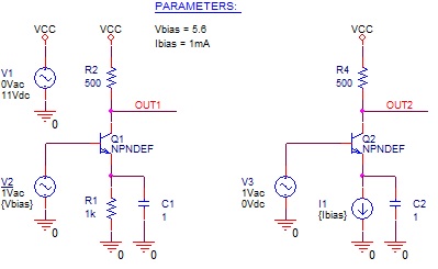

Strange. Care to post the schematic you are using?
If I bias the NPN with a current source in the emitter, I get much closer to the 1/2gm values, at all IE current values. And a monotonic behavior, as expected.
@1mA 15ohm vs. 1/2gm 12.5ohm
@6mA 2.3ohm vs. 1/2gm=2.1ohm
@10mA 1.37ohm vs. 1/2gm=1.25ohm
Here it isStrange. Care to post the schematic you are using?
If I bias the NPN with a current source in the emitter, I get almost exactly the 1/2gm values, at all IE current values.
Hans
Here it is
Hans
So, with this schematic you get the theoretical values for noise, with the default NPN model, correct?
Then this boils down again to some differences in how simulators are handling the noise calculation.
The difference could be on how the simulator calculates gm with constant IE vs. constant VB.
This is what I get @ constant IE, 1...10mA step 1mA
For comparison, I'm attaching the results @ constant VB, 1...6mA step 1mA
Schematics for const. VB and const. IE are also attached.
