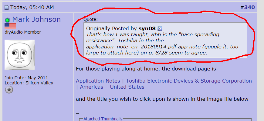

For those playing along at home, the download page is
Application Notes | Toshiba Electronic Devices & Storage Corporation | Americas – United States
and the title you wish to click upon is shown in the image file below
_
That's the app note I quoted from, a few posts up https://www.diyaudio.com/forums/ana...tra-low-noise-mc-head-amp-34.html#post5839291
Gratifying that you have cleared things up.

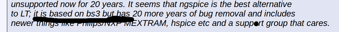

I would not spend any more time on Berkley Spice. It had its time but it is
unsupported now for 20 years. It seems that ngspice is the best alternative
to LT; it is based on bs3 but has 20 more years of bug removal and includes
newer things like Philips/NXP MEXTRAM, hspice etc and a suppert group that cares.
IIRC you wrote that you wanted to migrate to KICAD; that would be a natural
eco system for graphical circuit entry.
QUCS or QUCS-Studio seems also interesting, but it is not spice, only similar.
At least it can import spice models.
Once again, I beg to differ; 90% of code in all spice distros today is from the Berkeley original Spice. Everything coming in the last 30 years were only icings on the cake. All bugfix that I am aware of were not really bugs, but adjustments to the newer CPU architectures (larger FP precision, etc...).
KiCAD integration with ngspice would be a great thing, but is currently at the very beginning. Last time I tried, earlier this year, it was so hard to simulate even a one transistor gain stage that I ended giving up. Not even me, a hobbyist, can afford to spend that much time to complete an almost trivial job, with any degree of confidence.
how can you tell?That's the app note I quoted from, a few posts up
I don't think that I was easy to misinterpret regarding the heritage of today's spices.
And it is forgotten too soon how useless spice3 was for board design as soon as p-spice prospered. All manufacturers delivered only models that contained p-spice extensions. It was the start of the LTspice success story that Mike Engelhard re-implemented all of that.
It is not as if all work was done an no further progress necessary. For example, you cannot get LDMOS models that really work (if at all) and you cannot simulate a pin diode. Carrier lifetime is an unknown concept. Or if Spice3 maxes out just _one_ core of your new 16 core computer with CUDA.
And I would not call mextram, Verilog-AMS models, harmonic balance, event-based cosimulation etc only icings. And with regard to word length: we had version 2G6 on a 48 bit Telefunken TR4 with OC604 transistors and tons of AA112 Ge-diode microprogram store, or later TR440 and CDC Cyber 176 with 60 bits. These were fun in comparison to 32 bit VM/370 WRT convergence etc. All that was not much more than a recompile. OK, the compile experiment on my Bullet Speedboard 286 running Interactive UNIX in large memory mode was a complete failure. (2G6)
I won't argue this past this point. We seem to have a fundamental difference in what "core code" and what data manipulation and I/O "cake icing code" are.
BTW, spice3 was never intended for "board design". For it's scope, it is as good and performing as any other "advanced" spice distros today, provided it is adjusted and compiled for the target platform.
Models are not part of the core spice code, in fact adding new models is a rather easy programming exercise, given the source code, and this is mainly because of the clever layered and structured core code.
Why are more advanced models not added to the generic spice platforms, that's because it is not worth of. Where it is worth of (and I know at least two examples, one proprietary) they are in, including the transit time, etc... Check the EESoft (currently Keysight) ADS (which is in part still built on top of spice) and I don't think you will miss much to simulate your RF/Microwave stuff. Ah, yes, it's expensive, I know 😀.
