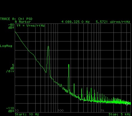

To add insult to injury, something like the DeBroglie will not work at all on the bench; I am surprised it works even in simulation. The LT1028 op amp is open loop at DC; the drop of the input bias current (25nA) on the 22k resistor (about 0.5mV) multiplied by the open loop gain of 30*10^6 is large enough to bang the opamp output in the power supply rails. And the feedback loop is not compensated, C2=1nF is not good enough, for a closed loop gain of about 20dB this thing can be stable only by pure coincidence.
Same comment applies to the Heisenberg II and others, out of the versions with op amps only the JJ Thompson looks like a sensible design that has any resemblance to something that could work on the bench.
I have no idea why this increase in the LF noise (simulation tells (of course) jack ****) in particular because it does not appear to be 1/f noise, it could be still GR noise from the solar cell, insufficiently filtered out. I'll keep looking at this, I have enough boards and parts to do a few more experiments.
It turned out it is simpler than expected; indeed the root cause for this strange LF noise is the GR noise in the solar cell. It is likely obvious for somebody with more experience in solar cell power generation, but experimentally I observed that the noise goes up with the illumination (no idea of the law).
Lowering the LED current from 350mA to 50mA cured the solar cell noise problem (350mA was indeed uselessly high); I assembled last night another board with the old Rohm 2SB737/2SD786, the lowest noise transistors I have ever seen (designed for low noise, of course) for a fair comparison to the ZTX devices. Results are attached. This time the overall gain (DUT 24dB + measurement amp 60dB) is 84dB (or about 16,000).

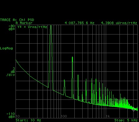

While the ZTX devices have a slightly lower noise (280pV/rtHz, consistent with the reported lower Rbb) they suffer by having a much higher noise corner frequency. The Rohm devices (Rbb=2...4ohm for the pnp and 4...6ohm for the npn according to the data sheet) delivered 350pV/rtHz but are almost perfect in this respect. Very little on top of the expected 1/f noise. And actually the square ratio of Rohm/ZTX noise (1.56) matches pretty well the ratio of Rbb in these devices.
The y axis is different ! (ZTX -80 ... -110 dB, 3dB/div - Rohm -60 ... -110dB, 5dB/div).
If plotted at the same scale, ZTX is clearly superior.
At 100 Hz, ZTX is at -102 dB while Rohm is at -95 dB

Noise at flat is in the upper right corner, in uV/rtHz. Divide the numbers by the overall gain and you'll get the input referred noise (at flat). 1/f noise is higher for the Rohm, but the noise corner frequency is much lower. At 500Hz the noise is about the same in both, at 1KHz the Rohm is slightly better. Expectation is to have the lower flat noise (the ZTX) to have lower noise at all frequencies compared to the Rohm.

The ZTX is lower for all frequencies! Yes, at 1 kHz and up the graphs are both quite flat and the cursor sitting at 5 kHz displays the corresponding level with lower noise for the ZTX and wich fits perfectly the lower base resistance.
For the lower frequencies where the graphs starts to climb up, it only looks higher as both your graphs on the Y-axis start at -110dB but ZTX goes up to -80dB while the graph for Rohm goes up to -60 dB. So, there is a different span: 30 dB for the ZTX and 50 dB for the Rohm resulting in different dBs per division on your analyzer. If you determine the output levels for various frequencies you will see that ZTX is significantly better. As said, at 100 Hz ZTX has about 7dB less noise level and at 10 Hz the difference is already more than 20 dB (about -90dB noise level versus -65 dB)
Not at 1-2KHz. I'll redo the measurements at the same scale for a more visually entertaining version. Meantime, see the noise corner frequencies for the two, the intercept does not depend on the chart scale (or the absolute values of the noise), the ZTX is clearly higher (also more difficult to interpolate a straight line, denoting some contribution of another noise source, likely some G-R).
At 100 Hz (mostly 1/f noise) or lower the ZTX appears indeed better, no debate here. The only comment is that the 1/f noise absolute level is hardly a good way to characterize bipolar devices, since it can be highly variable, from device to device and batch to batch (it's mostly related to process cleanliness, as much as the G-R noise). I would be very surprised if the shape at LF would be consistent for both the ZTX and the Rohm. The flat noise is relevant, and yes, I was expecting the ZTX to be slightly better.
Let me put it this way: the ZTX (1 sample) looks overall as having slightly lower noise (280pV/rtHz vs. 350pV/rtHz), but the Rohm (1 sample) is closer to what I would expect for the noise shape and noise corner frequency from a low noise bipolar transistor. But most likely, none of these would matter for audio, although the lowish beta of the ZTX would make it not recommended for all medium and high output MC cartridges (having higher impedances compared to a low output MC cartridge), since the input current noise is significantly higher.
