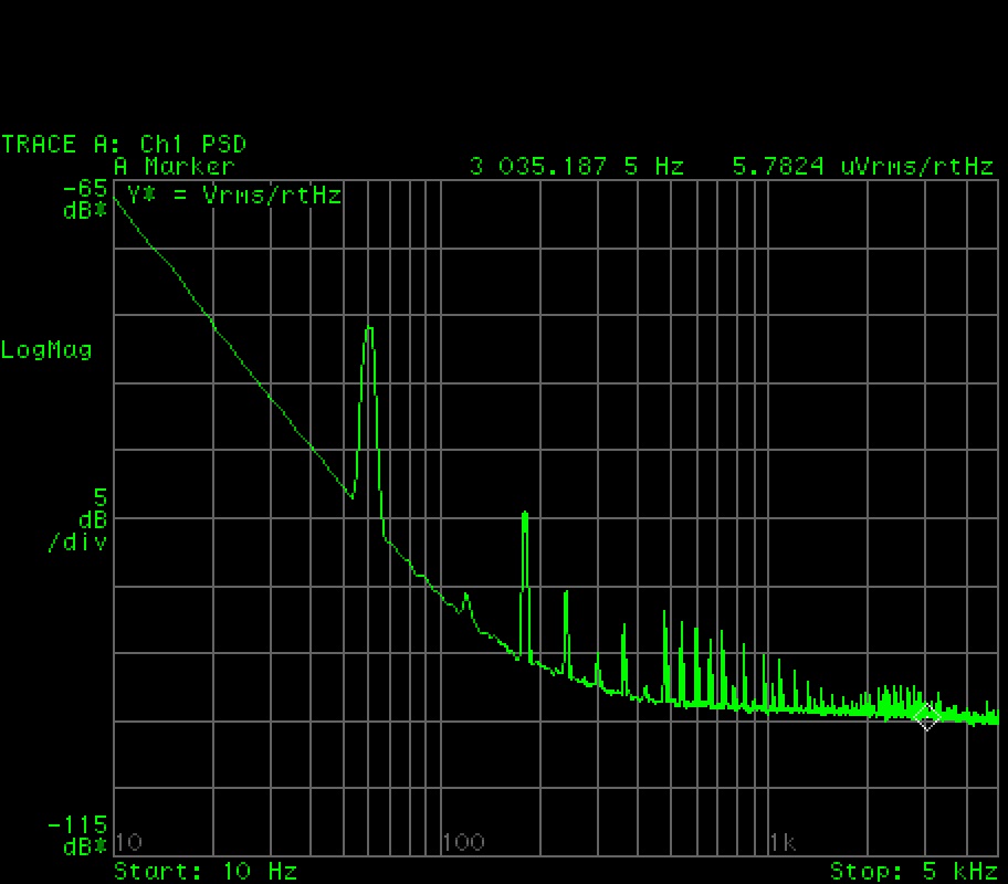

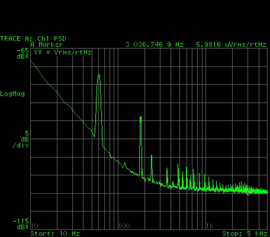

Intriguing and I'm possibly misreading something but your measurements seem closer to the ones linked earlier in this thread than H&H results which, at 10mA seems to put the 1/f knee around 50Hz whereas at 25mA its IIRO 150Hz. At the 5mA you are using the Rohm should be slightly quieter or at least neck and neck, but the 1/f shouldn't be like that.
Certainly if obtanium (of if you have a stash) the 2SD786 is the choice.But for those of us without and a fetish for bipolar MC stages (and some daft low Z MCs)...
Ok, so this is illustrating what I said above, about variability in such devices. I got another set of ZTX devices, and another set of Rohm's devices and re-measured, both setups in exactly the same conditions, the same scale, the same LED current (50mA). This time the noise results are virtually identical (360pV/rtHz), only the Rohm devices at 10Hz is a few dB lower, also the noise corner frequency is almost the same, and with a value that makes sense (100...200Hz). No more G-R noise for the ZTX.
Not sure if the previous set of ZTX devices were an accident, or the variability is that big, resulting in some sort of gambling when using them for low noise, but for audio purposes I would think the ZTX and the Rohm devices are virtually identical. I would still use devices intended and characterized as low noise (the Rohm devices) but, being unobtanium today, the ZTX devices seem to be at least as good (with a little bit of luck 😀).
I'm sure Winfield said on here he tested 100 of each device when characterising them, but don't know if he tried to get different batches.
But for me and given the Halcyon days of low noise bipolars is long gone buying a few extra just in case doesn't seem to be a big worry.
And thank you for doing and posting the measurements.
