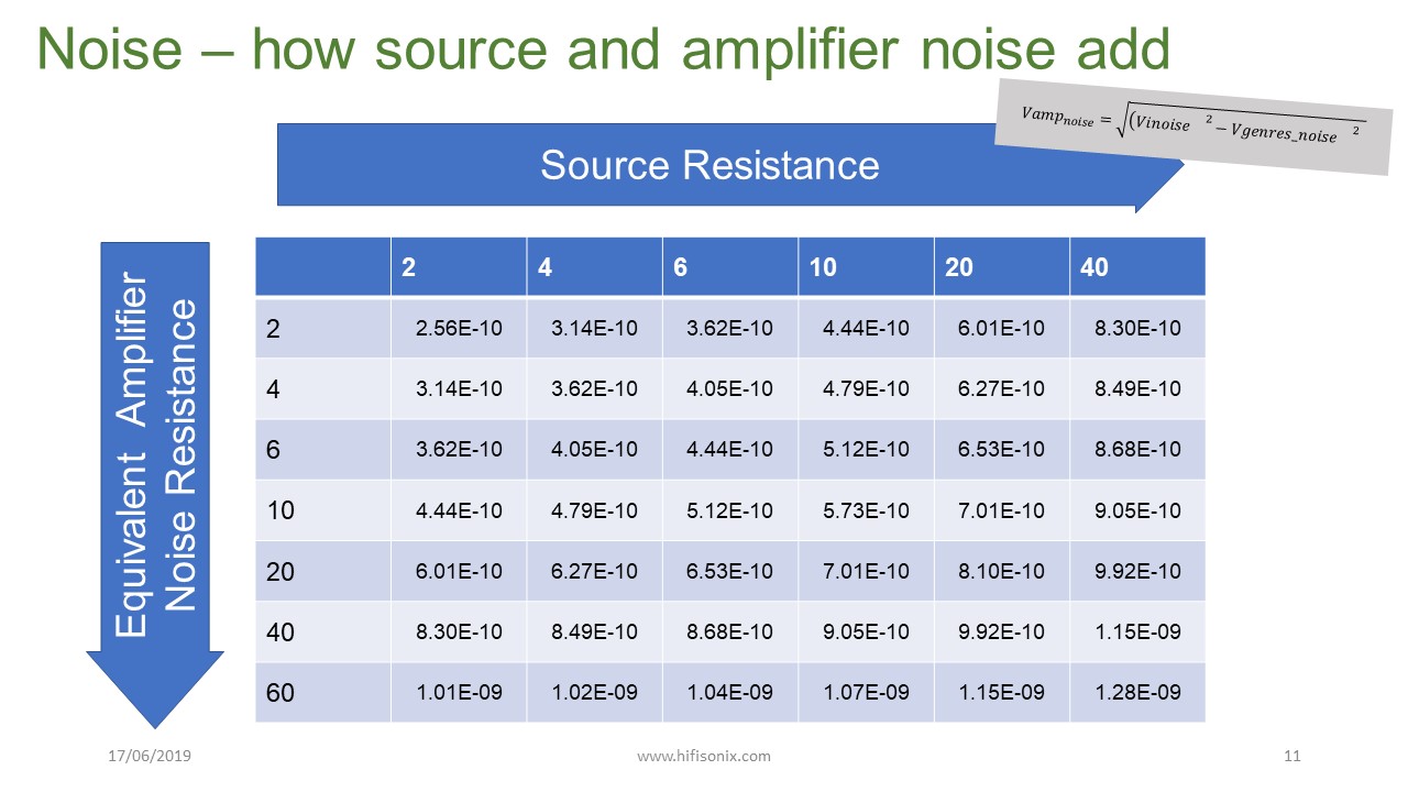

Here is a table of amplifier noise and source resistance noise. It shows the combines amplifier vs source resistance noise.
Select your source resistance on the x axis and your amplifier equivalent noise resistance on the y axis. The intercept is the total input referred noise.

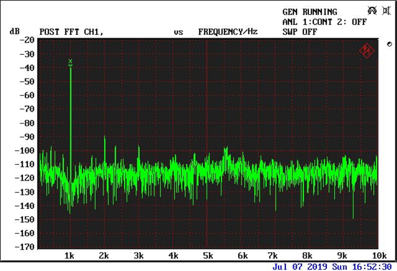

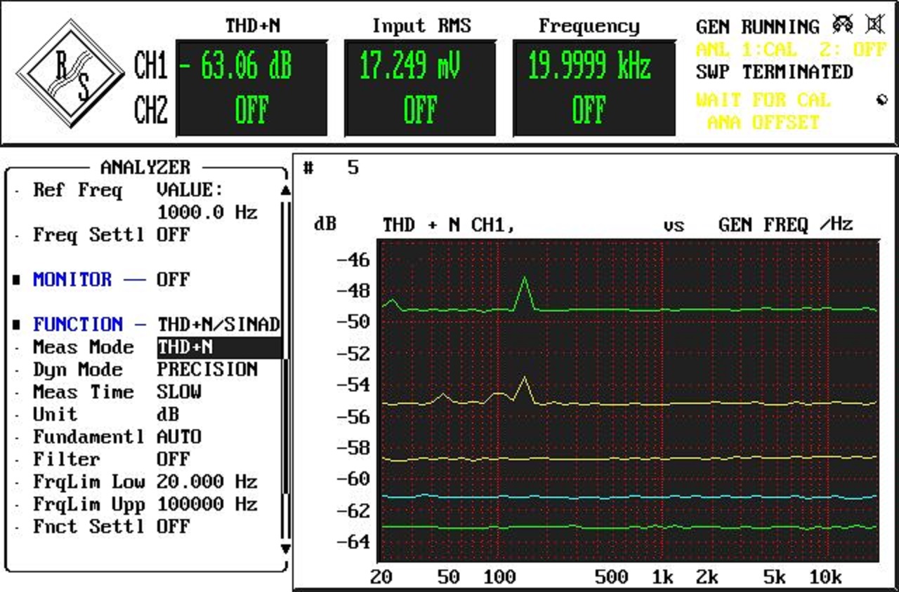

- Distortions for the circuit shown in https://www.diyaudio.com/forums/ana...tra-low-noise-mc-head-amp-38.html#post5841706 From bottom up, Vin=0.5mVeff to 2.5mVeff in 0.5mVeff steps. 0.007% for a typical MC cartridge input. Can't get better than this with bipolars, open loop, unless some heavy degeneration is used (at the price of noise). Mr. Duraglit will of course note that other than the topology, the circuit is different from the Leach mirror circuit; degenerations are 1ohm and the circuit runs at 5mA rather than 125uA. Hence, the Leach comments about a higher noise in the current mirror circuit does not apply.
- Distortion spectrum @1KHz and 2.5mVeff, fundamental notched. A little of 2nd and 3rd harmonic, everything else is in the noise floor.
To my own experience, rather than hunting down the last drop of noise, it is much useful to invest in shielding the head amp from stray magnetic fields. Down from .5nV/rtHz it's the mains 50/60Hz that dominates the audible artifacts with the idle TT. I used a 12mm thick aluminum enclosure and got the 60Hz component (input referred) down to about 50nV, about 20dB down from the unshielded version, which makes it almost tolerable for a MC gain of 67dB plus 28dB in the power amplifier (a few mV at the speaker terminal, can hear it ears on but not in any far field). I'm pondering about a head amp close to the cartridge, much like electrostatic microphones use, but it's an idea in very early stages.
You can of course rapidly end up at the point where the cartridge itself is picking up more noise than the preamp. Shielding that becomes more challenging. As I discovered helping a friend out recently, ethernet over the mains boxes are evil and put out all sorts of grot that the cartridge will happily pick up.
100 times less that the best case distortion from the vinyl. Personally would mark that as transparent.
I find the noise price perfectly acceptable with degeneration if you are prepared to use enough current (and I never use less than about 60 volts with phono stages).
You need to account for current noise effects for some extreme designs.
