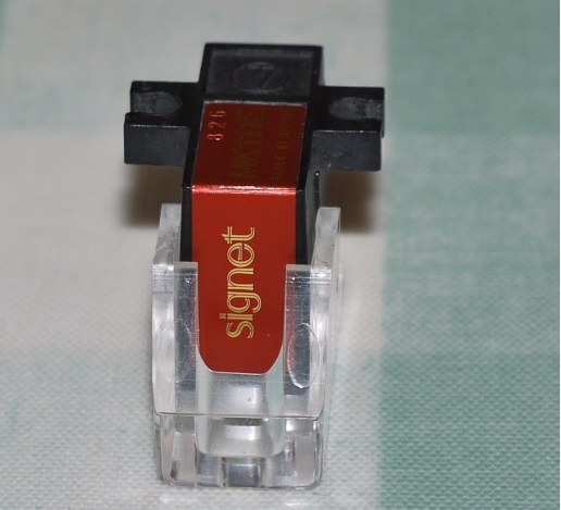

I can blame someone else for my recent aquisition of this, honest. 4.8g of Audio Technicas finest circa 1980. As a new old stock sony XL-MC5 is some £400 these days this is likely to remain my lightest MC for a long time.

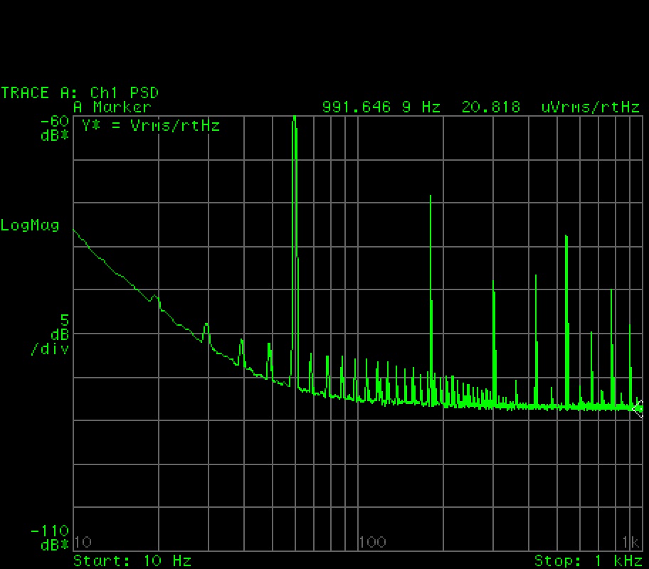

Funny you mentioned this, since I just finished measuring #375 at 200uA collector current. Since 1/2gm=62ohm, RB and the (local) emitter degeneration (now 15ohm) noise contribution can be safely ignored. I got 0.93nV/rtHz, simulation says 0.83nV/rtHz once again the solar cell noise contribution is very small. Overall gain (DUT plus LNA) is 87dB (was 84dB for Ic=5mA). Interesting enough, the noise corner frequency goes down significantly in this consiguration, it is around 60-70Hz vs. 100-200Hz @ Ic=5mA.
So 25 times lower collector current makes the noise about only 3 times larger, not too bad. Something around 1.5nV/rtHz could be fed from one of those isolated gate controller ICs like http://www.vishay.com/docs/84639/vo1263aa.pdf and good bye batteries, solar cells, rechargeables.
P.S. What I mentioned above, for #375 the gain is practically independent on anything but the power supply voltage Gain=(Vcc-Vbe)/Vt Vt=kt/q. For 25 times lower transconductance, the gain actually goes up by 3dB!
