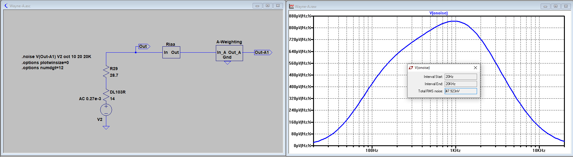

A matched load for Riaa Amps is rather pointless.
More important is to keep in mind that A-weighted noise after Riaa above 75dB-A doesn't make any sense.
For a Denon DL103R with 0.27mV@5cmsec/1KHz, this means an equivalent RTI of 48nV after Riaa and A weighting, corresponding to 119nV flat.
119nV@20Khz flat is 0.84nV/rtHz or 42R7.
Subtracting the 14R from the Denon leaves 28R7 or 0.69nV/rtHz RTI for the MC Amp.
Everything below 0.69nV/rtHz without the DL103R Cart is rather over the top.

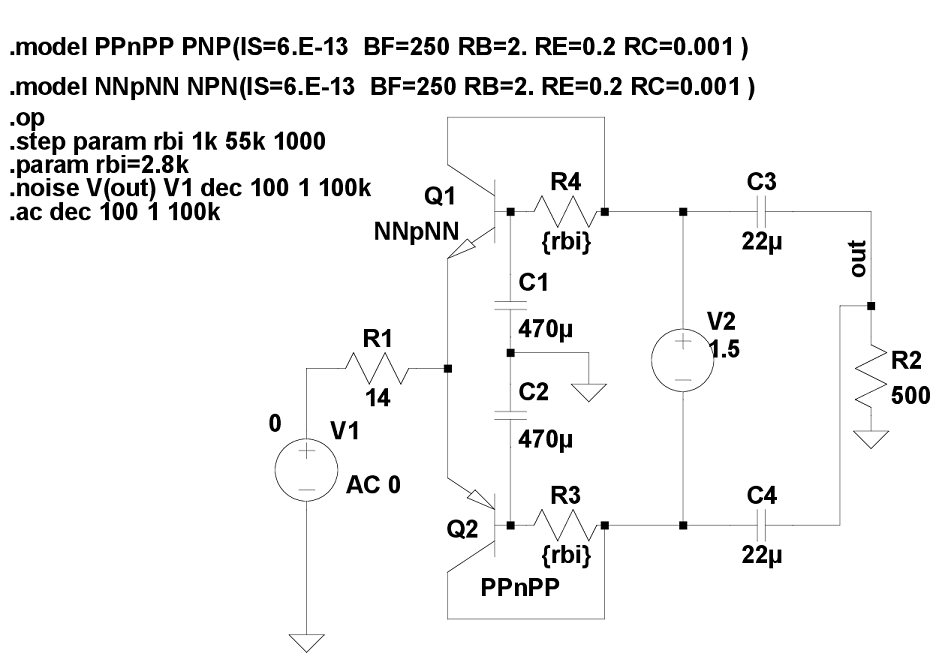

My analysis of the simple complementary common-base head amp follows. There are more subtle complications than one might think including some that might not be intuitive. For this exercise the standard low frequency instrumentation concepts of referred to input and referred to output error are used.
I started with the simplest form and used idealized transistor models to avoid confounders, only the Vbe equation (Is), RB, RE, RC, and beta were used.
Tabulated bias conditions from the LTSpice log (gain from simulation);
Gain @ 1kHz – 27.7dB
gm - 0.463 S
RB – 2 Ohms
Ic – 12mA
Referred to input noise contributions;
Total output noise (RTI) - 0.525nV rt-Hz
Contribution from cartridge (14 Ohms) – 0.48nV rt-Hz
Q1 and Q2 – 0.13nV !!!
The load resistor – 0.09nV (the rest of the resistors are trivial)
The first takeaway is that lowering the Ic on the transistors to match 1/gm to the source resistance only makes the noise worse and the noise at the output is almost equal to the thermal noise of the cartridge series resistance (14 Ohms) at 1/2gm of ~1 Ohm without much room for improvement.
The question is why do the transistors contribute so little noise. At this level of Ic and input resistance the cartridge acts as a degeneration resistance so currents and voltages divide at the input into common mode and differential components. Using probes to compute the noise gain from voltage at the base of each transistor and the noise gain of the collector shot noise referred to the input current gave interesting results. The noise gain for voltage injected at the base was ½ to the output, which means the effective noise is from RB/4, while the collector shot noise is a factor of 10 lower or the shot noise of Ic/100. These numbers seemed somewhat non-intuitive but plugging in all the numbers gave almost exactly the answer from LTSpice. I think this is a hidden benefit of the floating Leach circuit that I have never seen pointed out.
In the current mirrored circuit in #375, the funniest property I observed in this common base circuit is that the gain does depend only on the power supply voltage (For Rs=0)
Gain=(Vcc-Vbe)/Vt where Vt=kT/q so is independent on transistor beta, collector current, load resistor, etc...
that's because Gain=gm*RL but in turn gm=(Vcc-Vbe)/(RL*Vt)
Kind of the ultimate zero PSRR 😀.
I am not surprised. Warning, napkin calculation ahead:
Transistors appear to work at some 12mA a pop, so gm=480mA/V and 1/2gm~1ohm
These 1ohms plus 2ohms RB makes 3 ohm, divided by two for the pair is 1.5ohm noise equivalent. 1.5ohm is 0.15nV/rtHz transistors contribution, which is not far from what the simulator is telling you.
What I find interesting in the common base circuit is that increasing the collector current decreases 1/2gm (so the noise), also increases the gain, proportional to gm, so the output noise should stay constant. However, increasing the collector current also decreases the input impedance, so the signal gain decreases wit 1/(1+Rs*gm) Rs is the source (cartridge) impedance. Therefore the signal gain is gm*RL/(1+gm*Rs) or ~RL/Rs also about constant. So the signal/noise ratio powers at the output is independent on the transistor bias!
That was 0.13nV each from the simulator still small. It is six of one half dozen of the other 2||2 is the same as 2/4 + 2/4.

75dB-A as a sensible upper limit applies to all Riaa amps, MM or MC.Hans
I don't see the point with the RIAA or A weighting they apply to all setups assuming all noise is flat levels the playing field.
In the example I used a Denon DL103R to show that the Carts output voltage is the important parameter.
To achieve f.i. a 75dB-A S/N for a 0.27mVolt cart, Rcart + Req amp should be ca. 43 R.
This will determine the Amps RTI, matching loads does not apply.
As an intellectual challenge it's nice to see how deep you can go and what factors are playing a role, but the practical use for a low output MC Cart is limited IMO.
Hans

Bonsai asked me to publish the Riaa and the A-Weighting models that I used.
Here they are.
Gain for both is 0dB@1KHz and to prevent additional noise to be added inside the model, input is magnified by 1e6 and output attenuated by 1e-6.
Hans
