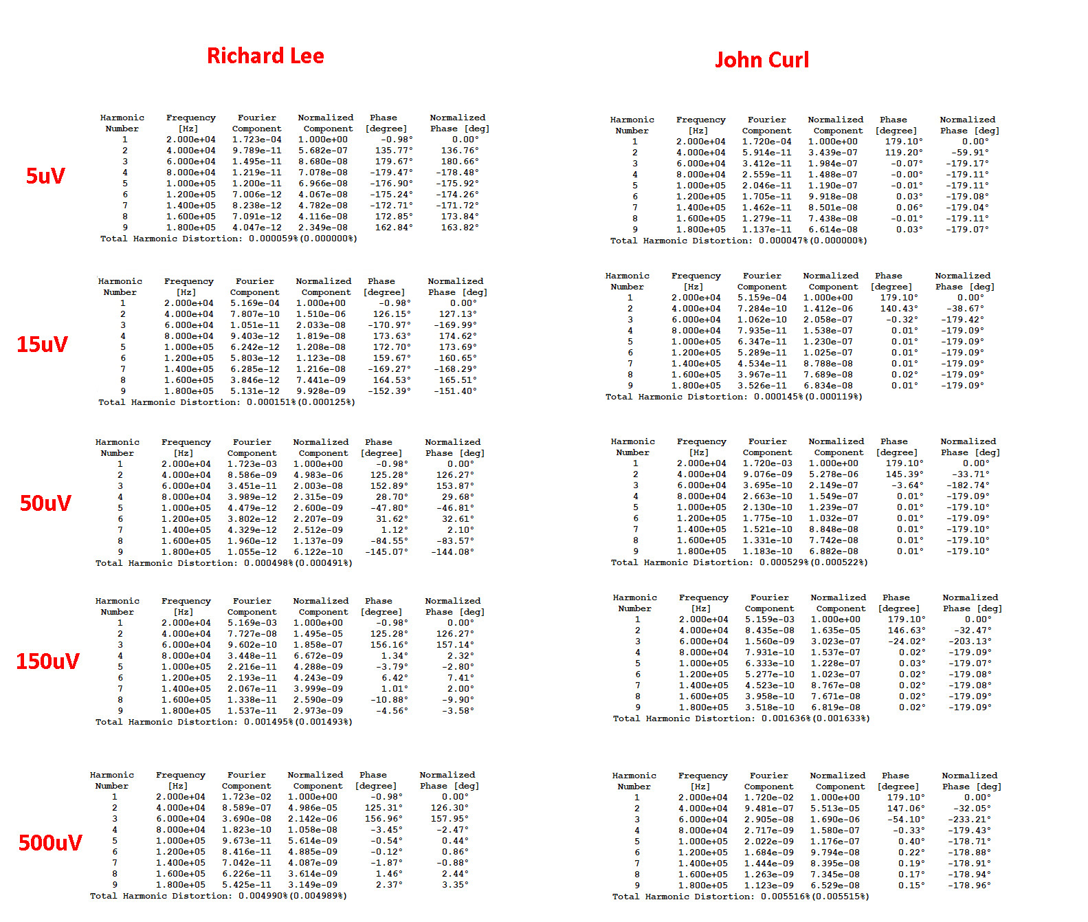

Hans, may I ask you label your JC results 'JC modded by Lee'. Guru Wurcer will insist my circuit be labelled 'Leach modded by Lee'. I only improved JC's noise by 4.4dB while I got more than 10dB with Leach
Hans
Here it is:
Thanks for the sim.
The 15 µV sims seem to be incorrect as both tables are exactely the JC 5µV values.

Thank you for noticing this silly error, no idea what happened.Thanks for the sim.
Anyhow, here is the correct table, all values have been checked now.
Hans

Damn!! I've improved JC until it has 0.8 to 0.5dB better THD than mineThank you for noticing this silly error, no idea what happened.
Should have kept my mouth shut

Don't worry too much - for the higher input amplitudes you are the winner and also when looking onto the higher harmonics
So it would be nice to see real circuit measurements for both circuit topologies side by side using same measurement setup and equipment (and maybe even using the same transistor pair). Spice sims are nice and helpful but real life might be a different story.
