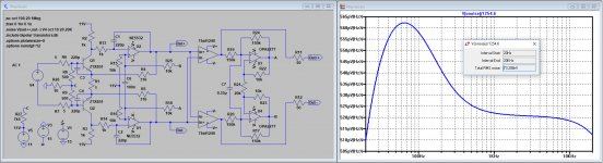

Here again the results of my sim
A Low Noise Balanced Input Moving Coil Preamp Using the ZTX851 - Page 44 - Pro Audio Design Forum
And below Wayne's exact circuit diagram, including the simmed noise results, -142.7dBV or -140.5dBu.
This is even 0.56dBu below -141.06dBu from Wayne measurements.
Hans

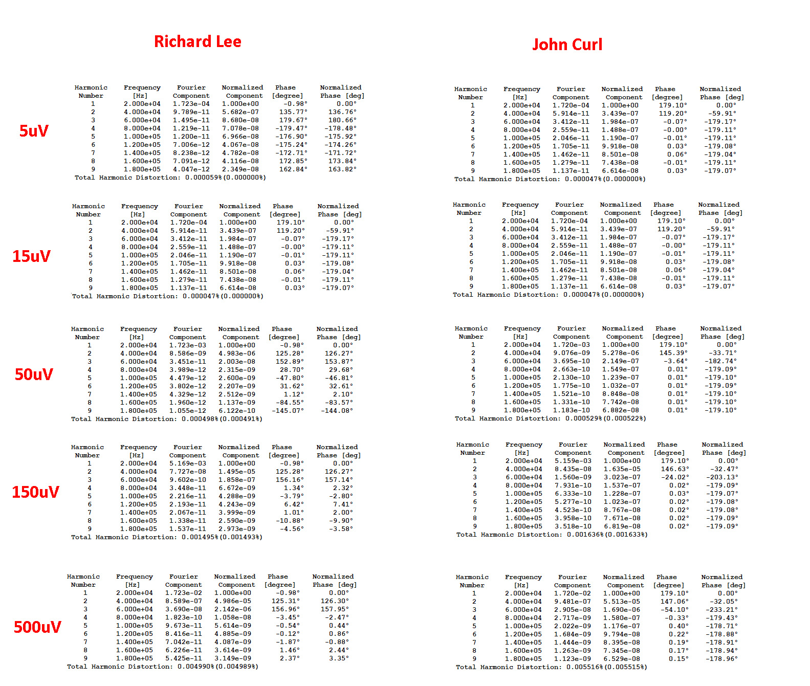

Hans, can you do THD on both circuits at 150uV, 50uV, 15uV & 5uV in addition to Bonsai's 500uV? Same 4R3 & currents please.

This is exactly what I expect.
The 4R3 and 3mA point is just below the point where increasing current doesn't improve Env. The difference becomes more marked at higher currents where real life will see Env levelling off .. eg as measured by H&H and Wayne.
Here it is:

So you are relying on other people measurements. Ok, I'm confused. Too many schematics, measurements and simulations. Somebody has to put these ducks in a row.
https://www.diyaudio.com/forums/ana...tra-low-noise-mc-head-amp-18.html#post5834677

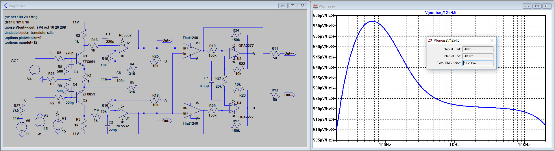

As Scott already mentioned, something stinks in these simulations; the ZTX devices bias is not obvious, but the minimum noise of a bipolar transistor should be 1/gm thermal noise. For a device biased at 5mA, this is about 5ohm, or 2.5ohm for a pair, 3ohm if you add the emitter resistor.
You got 0.52nV/rtHz flat, subtracting the input 10ohm that is 6.2ohm equivalent left. Which leaves a noise of 3.2 ohm (or 6.4ohm per halve) equivalent unaccounted (since RB=0 in your model).
These things are way to slippery to be treated casually...
0.52nV/rtHz minus 10R is 6.2R, agreed, minus 1R/2 between the emitters is 5.7R.You got 0.52nV/rtHz flat, subtracting the input 10ohm that is 6.2ohm equivalent left. Which leaves a noise of 3.2 ohm (or 6.4ohm per halve) equivalent unaccounted (since RB=0 in your model).
To be divided between the two ZTX devices gives 2R85 per transistor, of which 2R25 to be accounted to Re with 5.5mA.
When changing Rb to 1R5 as suggested by Richard, noise becomes 0.57nV/rtHz flat, leaving 9R or 4R5 per transistor afters subtracting 10R + 1R/2.
The problem is though that measurement and simulation are drifting 0.8dB farther apart to 1.36dB in favour of the measurements !
So in fact when having to suspect Waynes figures, means that we have to take his measurements with a corn of salt, not a very elegant statement.
Hans

I am assuming that RB shown in the model is WRONG at 0.025 and should be 1.5 and for RE an error of similar magnitude.
I propose we change the model to reflect H&H AoE figures then.
