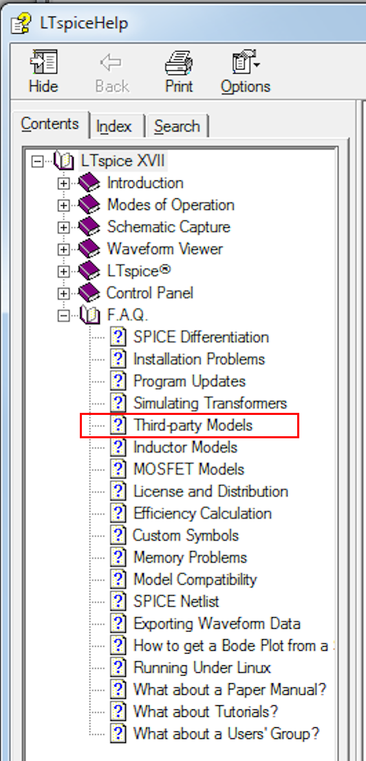

The online help system gives the file name and its location. You can find it in the section of the Help tree named Third Party Models (red box in screen image below)

Drop a transistor down and right click, it asks if you want to pick a model. The model file is all strung out on the line for each built-in model.

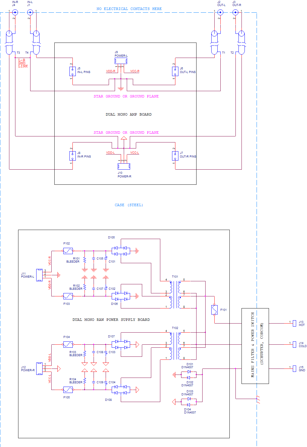

Wiring schematic is attached. There is an optional 1nF cap from each channel input ground to the case ground, not figured. The link between the channels signal grounds is also optional.

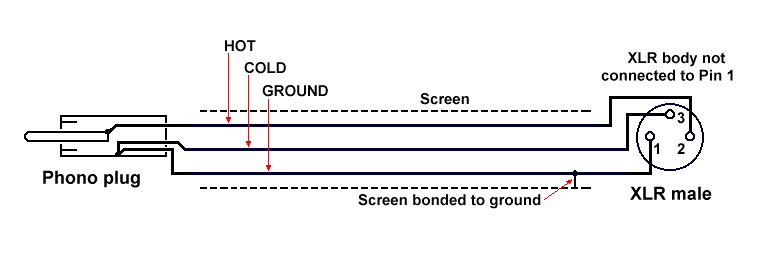

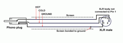

The cable schematic is also attached (from Self). Here, GROUND at pin 1 is the tone arm metal shell, pins 2 and 3 are the cartridge.

Thanks for this syn08. This is indeed how you should wire unbalanced for very low noise & long leads.Wiring schematic is attached. There is an optional 1nF cap from each channel input ground to the case ground, not figured. The link between the channels signal grounds is also optional.
In da old days, many Old World tone arms and preamps used 5p DIN connectors which allowed you to do this (4 cores & screen) right up to the cartridge. Not sure about da rebel colonies.
It was SME which made this unfashionable cos they introduced their EVIL Gold Plated (but crap 😱) RCA phono cables which became sorta standard in high quality tone arms.
