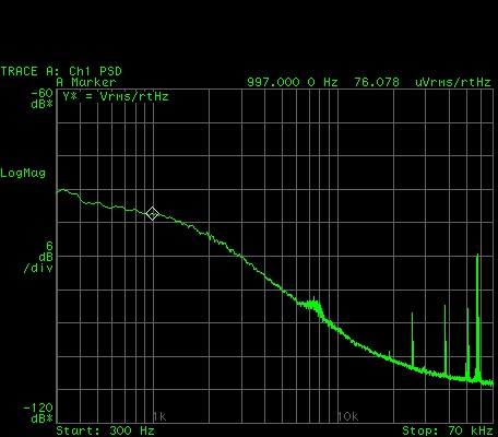

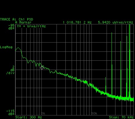

Because we are at it, here's something you guys may find interesting. Since I decided to give it a shot when I'll get a chance to receive the ZTX devices, I thought it makes sense to evaluate the noise of a floating power supply.
A common 3V open/100mA short 2x2" mono crystalline solar cell is illuminated by 4 high power white LEDs (total of 12.7V/350mA in series) at about 1/2" distance. The solar cell had measured about 70mA short current when exposed to sun, with the four LEDs the short current is only about 20mA (due to the non uniform illumination and mismatch between the cell sensitivity and the "cool white" LED emission spectra, "warm white" would be much more appropriated) but anyway much more than required to feed a ZXT Leach style preamp. Therefore, the internal resistance of the solar cell source is estimated to about 150ohm. Open voltage noise measurements are via a 60dB low noise (0.35nV/rtHz) instrumentation FET preamp (self made).
Without any filtering the open voltage noise is rather large and reaches about 2nV/rtHz at 50KHz and up. We can assume that the flat noise of the solar cell is essentially the internal source resistance thermal noise, which accounts of 1.5nV/rtHz out of the measured flat noise @50KHz.
However, @1KHz the unfiltered noise is about 76nV/rtHz, which I cannot explain on top of my head by anything but some sort of G-R noise (need to check the literature about noise in solar cells). The lower frequency noise is not 1/f, since it does not have the 10dB/decade slope (but close to 20dB/decade), it appears that solar cells have their particular LF noise mechanisms. Something that looks like to a "noise corner frequency" is around 25KHz!
Filtering the solar cell output solves the gross noise problem. A 1000uF/6.3V of the aluminum polymer very low ESR electrolytic capacitor filters out the noise, now the noise @1KHz is about 6nV/rtHz, not too shabby, but still needs careful consideration when targeting a deep sub nV/rtHz preamp with not much PSRR (if at all). The 50KHz flat noise is about the same as for the unfiltered example (2.5nV/rtHz) and the "noise corner frequency" is slightly lower, about 20KHz. The slope is now about 5dB/decade, which shows this is still no 1/f noise, but probably remnants of the original G-R noise.
Bottom line, although feeding a MC Leach type preamp using one or more photocells seems straightforward, it still needs lots of attention with filtering, to avoid power supply noise injection.
P.S. Yep, the first reference I found on line confirms the very G-R noise origin of an illuminated solar cell open voltage. It also confirms the rather high frequencies (for audio) where the G-R noise rises over the thermal noise (tens of KHz).
