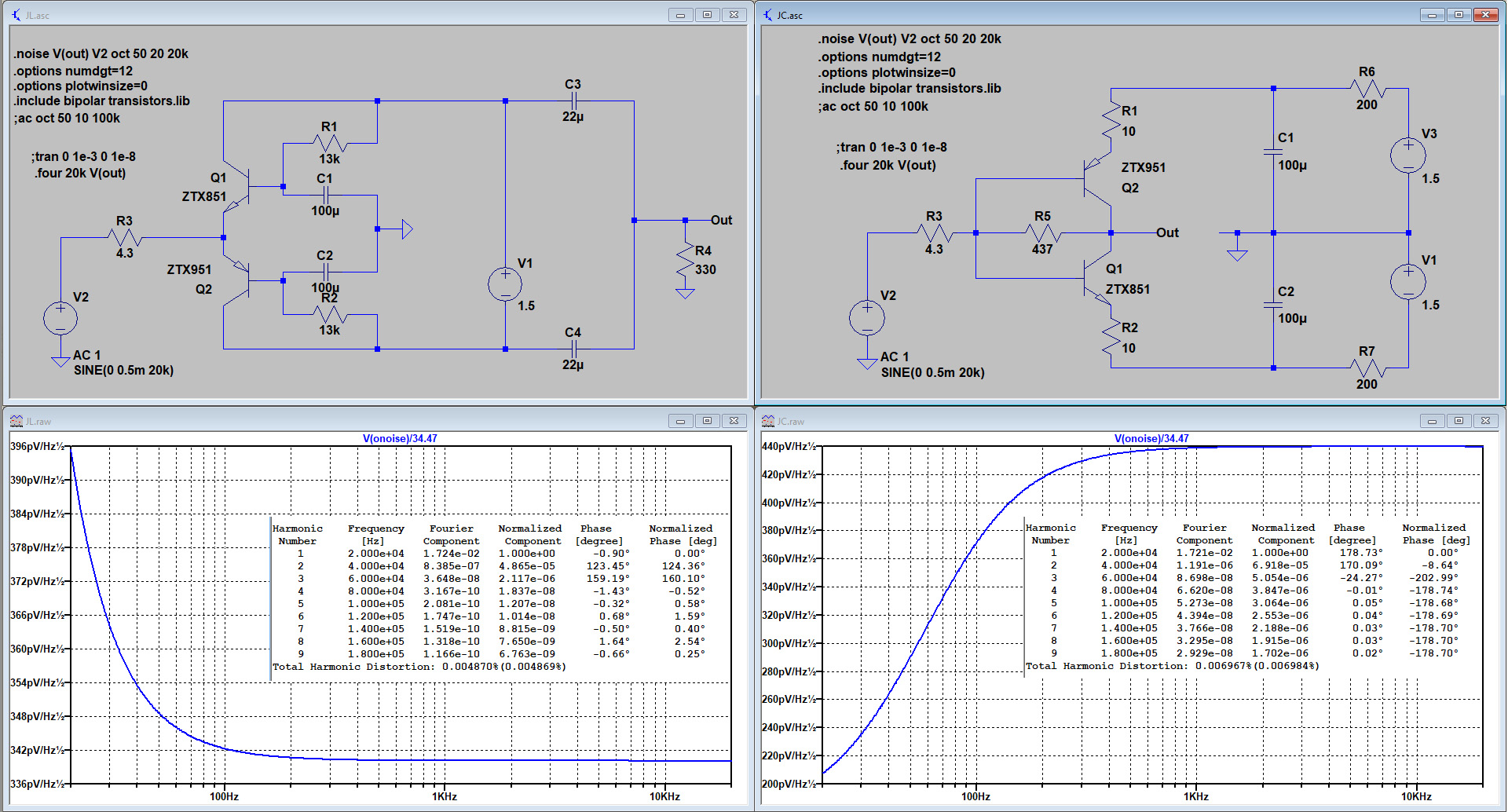

I have simmed both circuits below.JC’s circuit with single ZTX devices is siming at 340 pico Volt/rt Hz and 0.09% 20 k THD.
First is exactly nr 21 from your documentation, called JL and the other one is the single transistor John Curl called JL in the sim.
Gain for the JL circuit is 34.47, so I matched JC to exactly this same gain.
Noise for JL including the 4R3 input resistor is 340pV/rtHz.
When subtracting the noise from the 4R3, noise for the amp is 209pV/rtHz.
There are a few differences though, current supply is a bit higher at 2.78mA but distortion is notably lower at 0.005% (your doc says 0.07%)
With the same gain, JC has 439pV/rthz including the 4R3. Without the 4R3 it becomes 347pVrthz, or 4.4dB more as JL.
Distortion is 0.007%, or 3dB more as JL.
So our noise results are spot on the same !
But THD for both circuits differs more than a factor 10 in both cases, any idea why ?
Hans

Thanks for this Hans.Hans Polak said:I have simmed both circuits below.
Your original post #100 circuits show wonky versions of a wonky Leach variant. But that isn't JC's 1977 patent which is a wonky Virtual Earth. The collector-base resistor is important. That's why THD isn't as bad as I expected.
We can certainly get the noise performace to match my circuit. Just get rid of the 10R emitter resistors. BTW, your C1,2 need to be 1000uF or response will be wonky. 100uF also makes it seem as though your noise improves at LF 🙂
Similarly but in an opposite fashion, C1,2 on my circuit should be 470uF.
If you do all this and run the same current, I expect both to have the same noise performance with the same cartridge. Not sure if THD will improve or get worse. It's very late here in Cooktown.
Standing back as far as I can, I think the factor that will prevent 'real life' production from emulating the sims in JC's will be the 1000uF caps. The differences in noise & THD are really moot except for 'my **** is bigger' issues 😀
No I can't explain the differences in THD between your sims & Bonsai but I'm too tired to think straight.

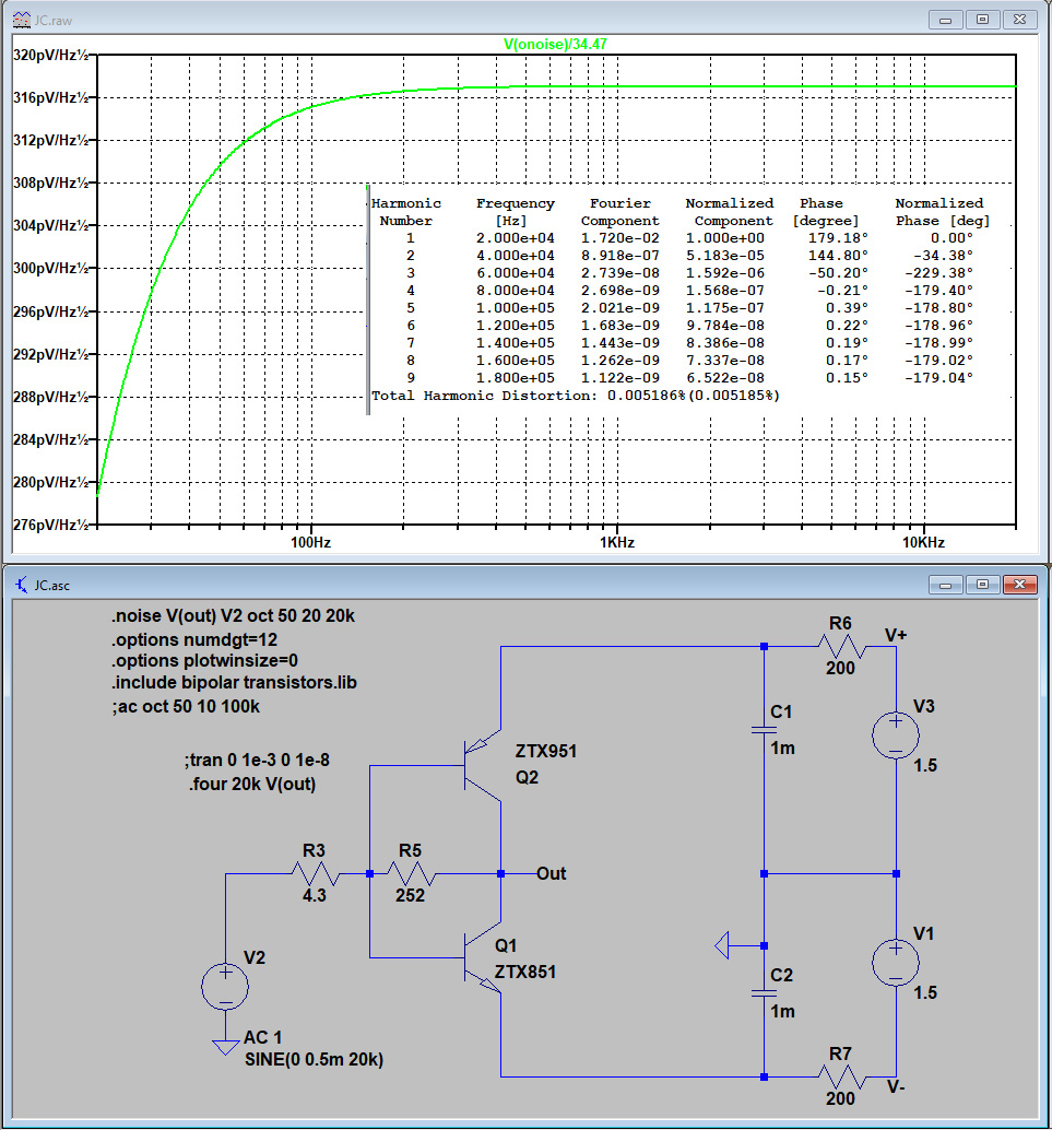

Hans
I probably have not turned compression off Hans - I will redo and check. Your distortion #'s look good ans I believe probably reflect reality a bit better than mine. Thanks for confirming the #'s BTW.
I should have used 1mF instead of 100uF caps, an error that fortunately had no effect on noise and THD.We can certainly get the noise performace to match my circuit. Just get rid of the 10R emitter resistors. BTW, your C1,2 need to be 1000uF or response will be wonky. 100uF also makes it seem as though your noise improves at LF 🙂
When removing the 10R resistors, but still with the Diode spice model, with gain again adjusted to 34.47, noise at 1Khz becomes 317pV/rtHz with the 4R3 and 169 pV/rtHz without.
THD goes even to 0.005%.
So indeed, both topologies have roughly the same performance.
See sim below.
When changing both RB values to the numbers you supplied, noise at 1Khz increases from 317 to 335 pV/rthz, or just 0.5 dB.Hans, can you post your *.ASC files? If you rename them *.TXT, diyaudio will allow them to be uploaded.
