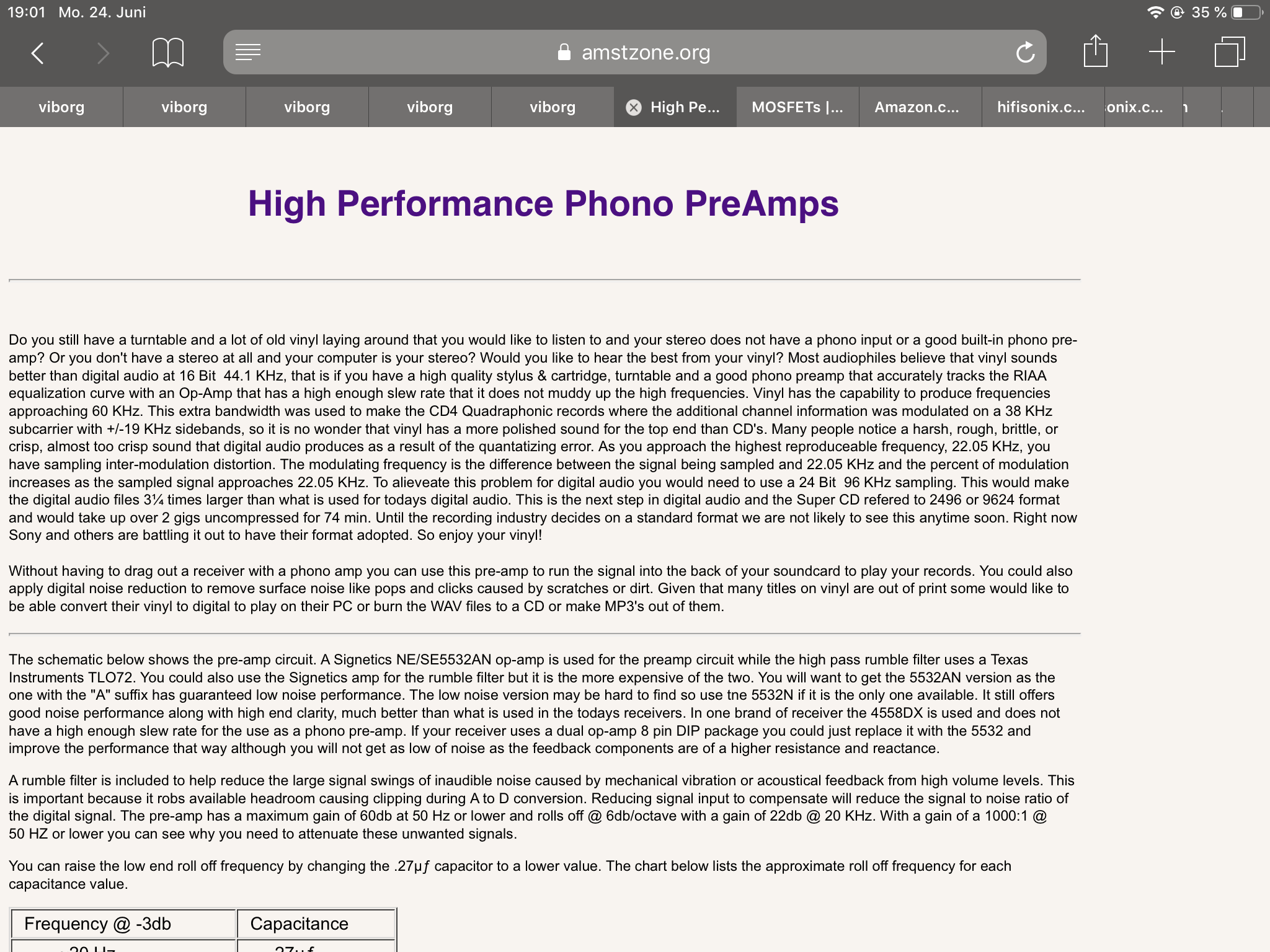

Thanks for this Joachim. The actual link isHere is the link. There are other phono circuits too.
High Performance Phono PreAmps
There he says, "[FONT=Arial,Helvetica][SIZE=-1]In the 3 previous circuits the power supplies for the head amps could be replaced with a 9V battery for each channel for extra low noise operation."
I'm not sure he has even tried out these circuits as he presents 3 versions and has no measurements or recommendations. 😱
