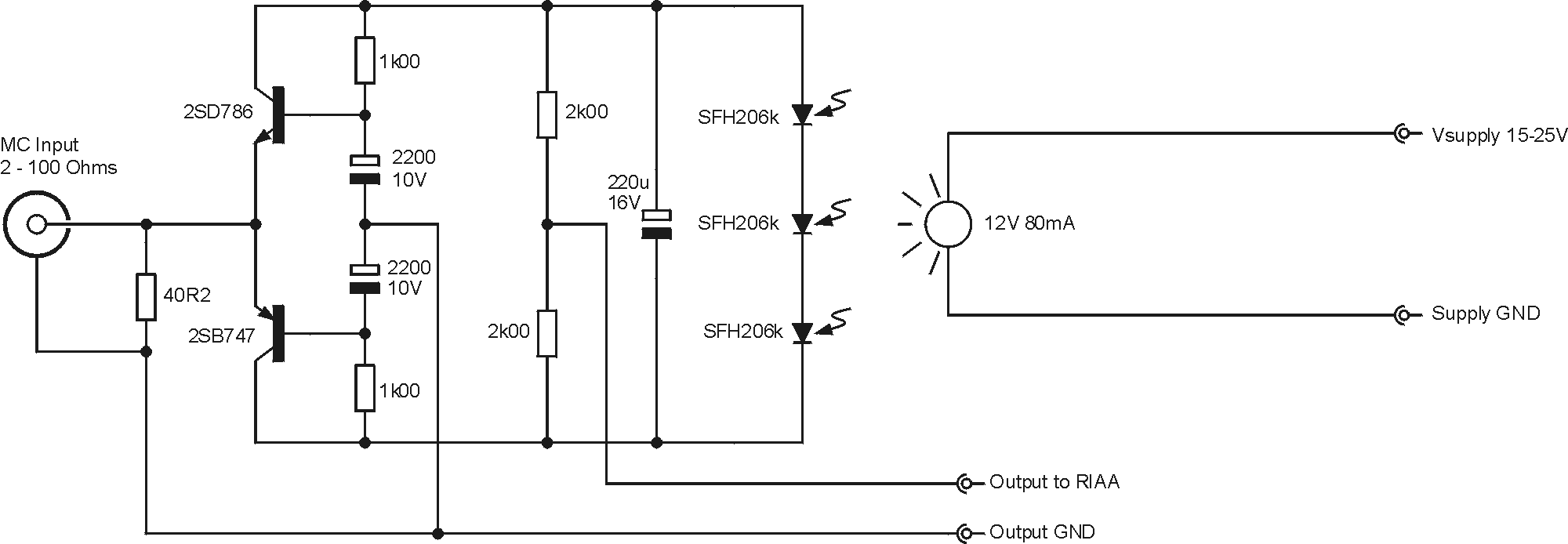

The reason I don't recommend the powered version is cos getting rid of PSU noise is a REAL PITA. It's MUCH easier for a DIYer (or indeed a true guru) to get SOTA noise with the battery version. The power version probably needs evil 1000uF caps. & other yucky stuff and the extra bits make the layout much larger & yuckier.
If I was doing a powered version again, I would look at doing it like this.
L C Audio Technology / RIAA/MC Amplifier
1000uF caps etc are really trying to float the PSU and the opto sources looks like a better way to do this. This implementation isn't the very best but better than most. If you want something off-the-shelf and single supply based, its definitely worth trying.
If you do buy one, please post on this thread. Us gurus & pseudo gurus will bug you for DC voltage measurements
