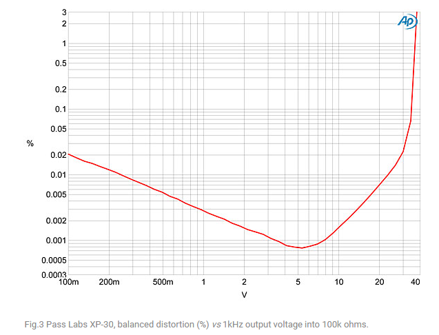

Here's a linestage preamp that outputs about 33V rms before clipping; test result published by Stereophile magazine.
To understand why they did this, free your mind from the assumption that all power amps have the same 1kHz gain as a Blameless amplifier from Douglas Self's books. Have a glance at the power amplifier designs whose PCBs are offered for sale here on this website, at the diyAudio Store. It's more diverse than you might first suspect.

I wish there were more discussions of gain structure and overload margin, folks still complain when they use a miniDSP in front of their 106dB sensitivity speakers and find it noisy. They are running everything throwing away bits to get the output level low.

I'm noodling with a high output preamp design myself. Plus and minus 55V supply rails, about 33V rms output, single ended. Double that if balanced. Curiously the first stumbling block to appear has been the power transformer. It isn't easy to find 25VA or 50VA transformers with 2 x 40VAC secondaries, not easy for me anyway.
