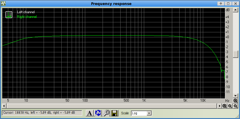

That is a definite improvement. Still about 6dB down at 20KHz which seems a lot.
I was thinking on this all this morning. Why HF rolls off too early? Quality of parts? Oversized caps? Measurement artifacts? I keep Bass and Treble controls of soundcard to 50%. Is it correct? That is how it is when I start my system. I tried to find this info in EM-U 0404 docs but nothing is there, it looks like this is controlled solely by software and they describe only their proprietary software. I use Linux ALSA and JACK. ALSA driver sets Bass and Treble to 50% both.
When you listen the record, do you hear that it has this early HF rolloff?
So, from yours and DF96 exchange I've got that in my case Zout is somewhat 250. Is it correct? Then, should be high Zout as a possible cause of early rollof be ruled out?
You should do a loop back test of youe measuring software. Jsut connect the source direct to the inputs and measure the response. SHould be completely flat.
The recording does not sound like it rolls of that much.
A high output Z would affect the bass response not the HF response.

And, oops, I've published only the last part with PS (1:10) input tranny configuration. It has most significant rolloff. SS (1:5) has much better FR, almost same as BP (bypass), as you can see on FR graph.

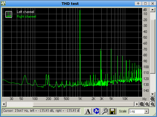

I've made loopback test for EMU 0404 soundcard.
FR curve matches very closely with what was captured from the MuMu preamp. Conclusion - RF of the preamp is flat.
Here is sound for all input configs, and loopback test metrics.
I suggest that FR and THD of the preamp are very good. Noise level (currently 78dB) and accordingly dynamic diapason may be improved.
Yes, it looks like the HF response of the amp is OK. Strange that the EMU should have such a poor response in loop back test. It suggests there is either something wrong with the card or with its software set up.
Cheers
Ian
Yes, I also disappointed why my EMU shows this FR.
As described here Emu 0404 the card should have close to perfect linear FR.
Can it be because of age, wear and tear of caps, or because 5ft loopback cable?
The card itself supports quite complex equalization effects: 1 band para EQ, 1 band shelf EQ, 2,3,and 4 band EQs.
I do not know what ALSA driver uses when the Bass and Treble controls are turned on. Normally they are turned off - no equalization.
All previous recordings were made with equalization turned off.

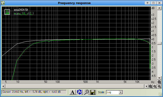

Actually, I've got the reason of poor FR. It was my loopback cable! It is Fender 5ft, new guitar cable. Most likely it has too high capacitance for input and output impedances of the emu0404 (Zi 3.3k, Zo 560).
When I plugged in 1ft cable (that is to link effect pedals), everything has been improved. FR is -0.2dB at 10Hz and +0.2 at 20kHz, SNR -97.5, THD 0.0016%.
Question. Should I use this short cables when I measure the preamp?
Its theoretical impedances are Zi=1M, Zo~=150.
Can I use 5ft cables? At least for input?

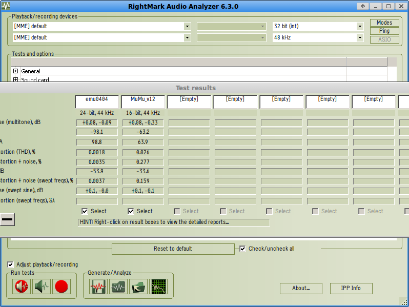

I've measured metrics of MuMu preamp in different input transformer configurations and different volumes.
I think that transformer in SS configuration (1:5) with volume around 12 clicks (50%) will be most usable config.
SP (1:2.5) gives same FR and THD with a little bit more noise. PS (1:10) gives significant LF and HF rolloff and less noise.
Here are metrics and charts for E-Mu0404 and MuMu in SS with 12 click volume.
I assume MuMu metrics include according metrics of e-mu0404 card, so should be a little bit better.
But I do not know how to subtract e-mu0404 metric to get pure MuMu preamp metrics. Could you please advise?
FR 20Hz - 20kHz: +0.08dB, -0.79dB (includes +0.11dB, -0.21 dB from emu);
Noise Level: -63.2dBA (includes 98.1 from emu);
THD: 0.026% (includes 0.0018% from emu);
