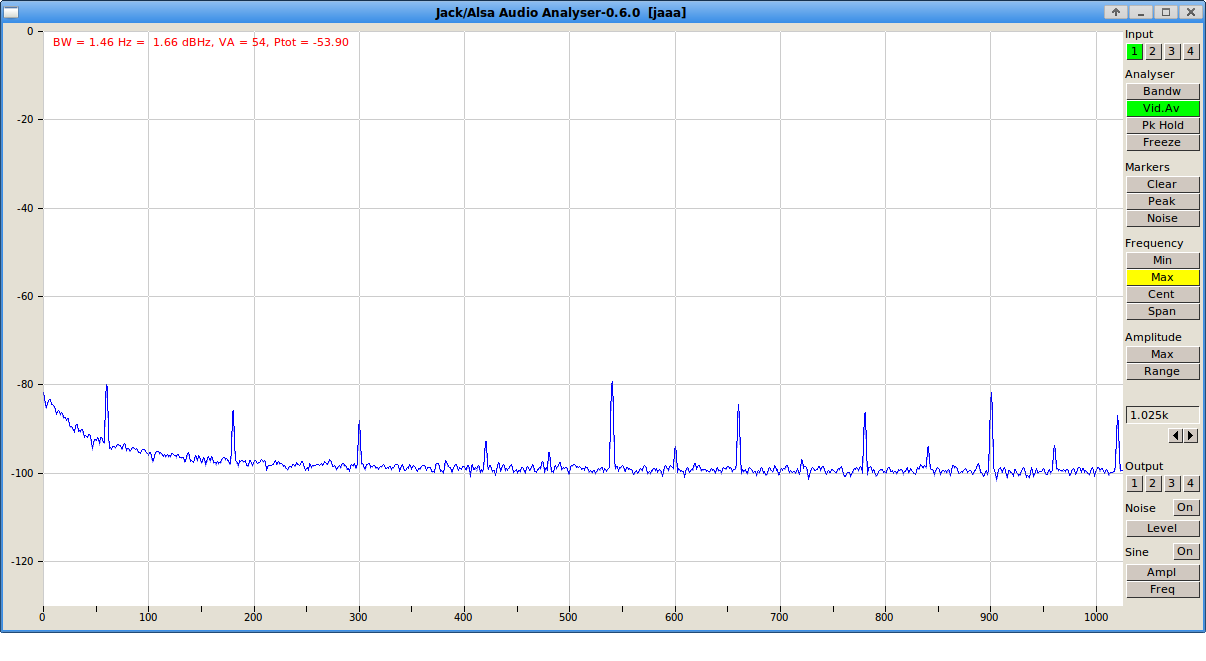

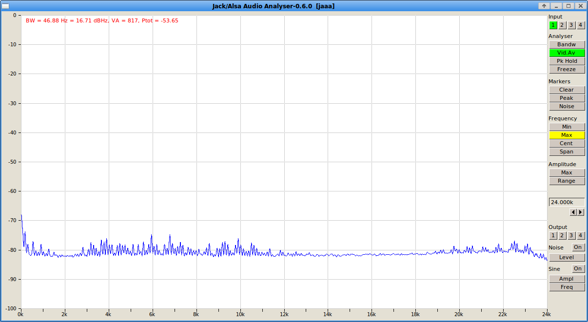

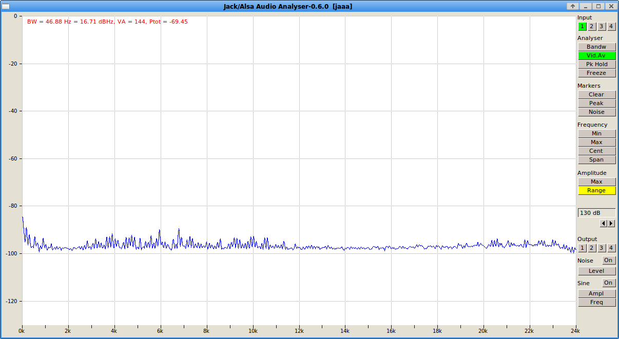

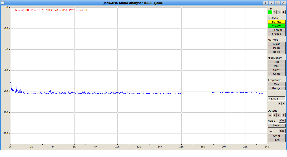

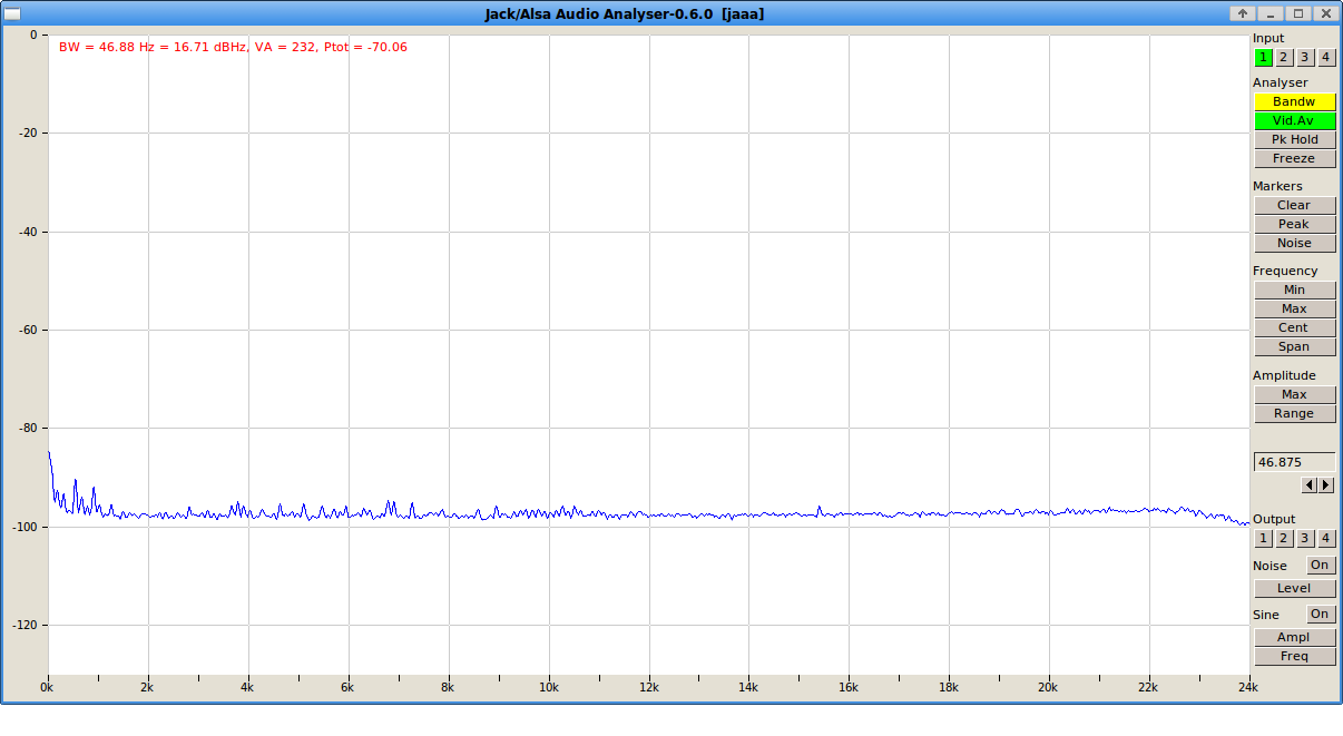

I've added snubbers to rectifier bridge - 0.1mF serial with 100R for each shoulder of the bridge. However it looks like it does not help. Even worse. I see some 60Hz harmonics where they were not seen before.
Please take a look at charts. It is noise from 150R pluggend into input XLR.
I am puzzled why there is the buzz. It is clear that this buzz (quite little, but still) comes from HT, because when I turn off mains transformer there is no buzz.
Also there is less buzz when bottom part of aluminum box is removed. I think that mains transformer induces some currents in the box when it is closed, so loop through the box is established. Last three pictures are noise with box open, no bottom part. V in file name is volume (clicks) on volume attenuator, 22 clicks - is full volume.

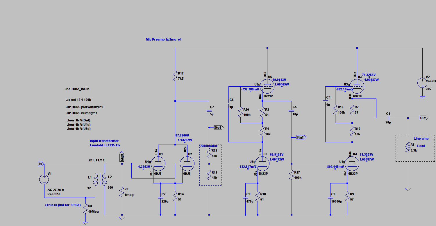

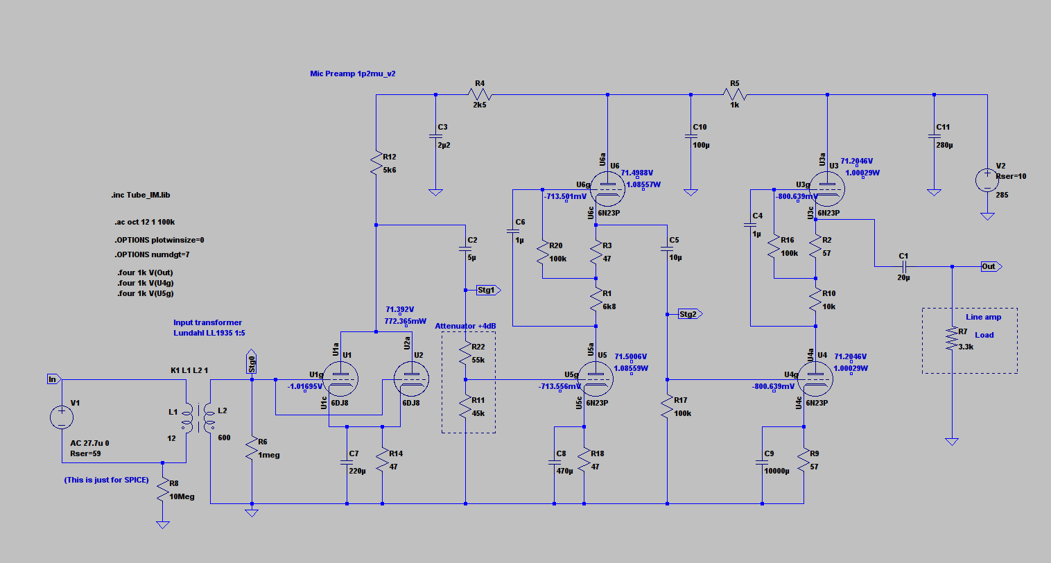

How about following schema? The input stage is done as two parallel 6922. What do you think how many dB it would reduce noise (comparing to 12AX7 mu-follower)?

The fact that the whole noise spectrum, including the hum goes up and down with the gain implies the hum is entering the first stage. To make sure it is not getting into the XLR socket itself, repeat the tests with the input short circuited.
Looking at the schematic I notice the first stage rune from the same supply as the later stages. You would normaly need to inlcude some extra decoupling for the first stage to ensure HT noise to not get in. As your first stage is a simple CC one it has absolutely no power supply rejection at all so it badly need decoupling.
I notice also that all the stages are being run at relatively high current - the second seems to be at 13mA. There is not need for the second stage to run at such a high current and if my esticmates are right, you are droppoing 130 volts across the 10K resistor which is about 1.7 watts. My standard go to mu follower for a 6922 uses 220R cathode resostors and a 4K7 resistor between the tubes.

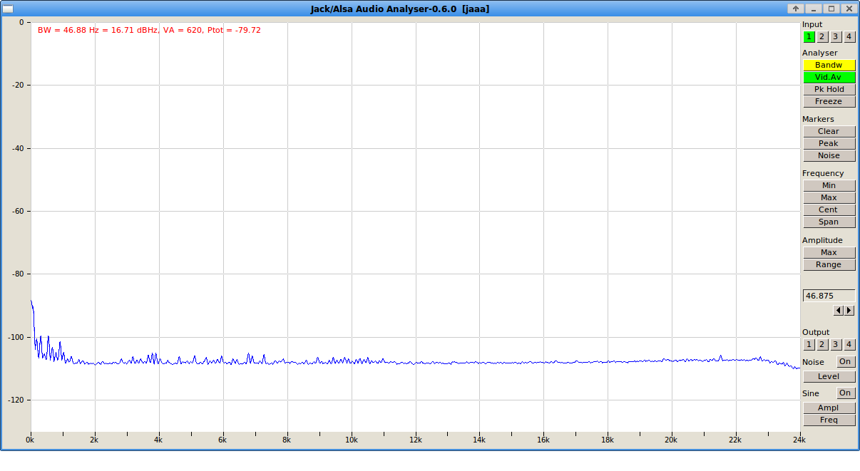

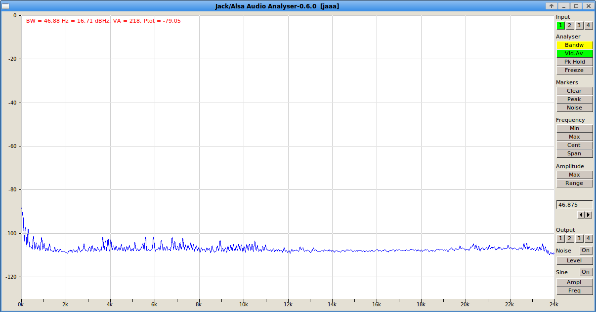

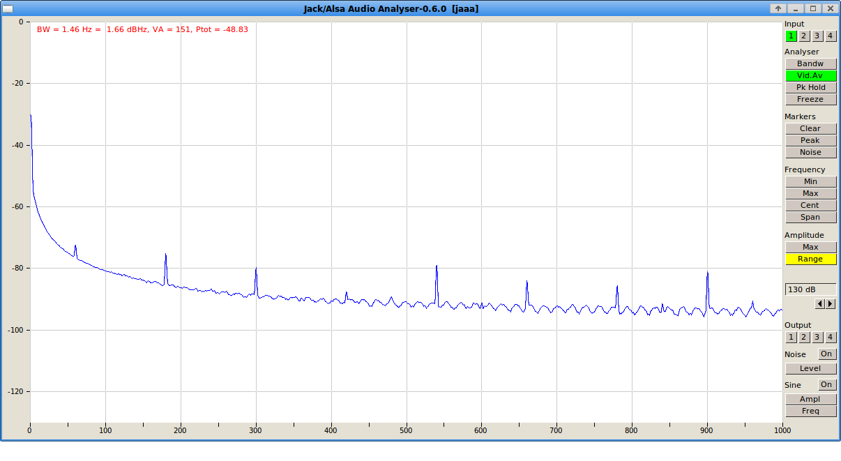

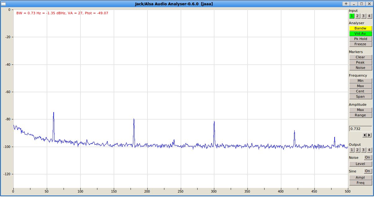

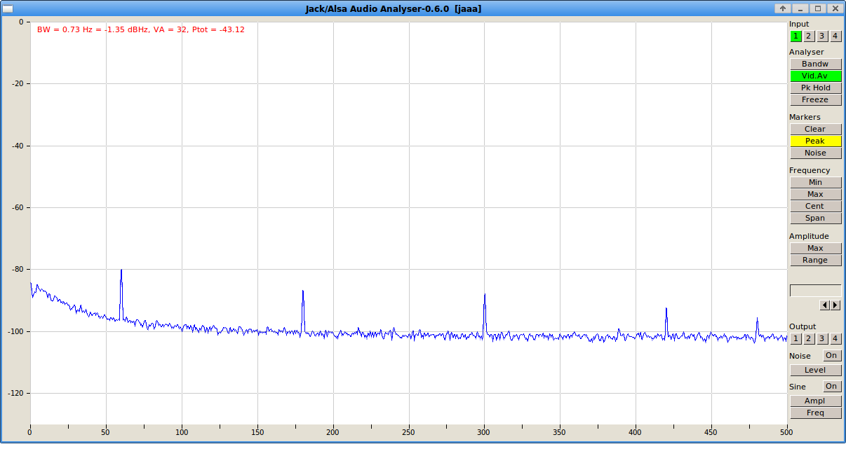

I've got snapshots of 150R up to 100Hz and up to 500Hz with higher resolution.
Same with input short circuited. Pic 3 and 4.
This values are selected during multiple trials - target was to achieve minimal THD. If I set Rc higher it makes THD worse.
I assume because operating point shifts to more curve segment of tube characteristic.
What is your B+?
I've added decoupling RCs. I did not expect that their capacitors impact linearity some tricky way - LF rolls off if I increase capacitance. That is why C3 is 2.2uF.
BTW, what topology would be better for the first stage, this with paralleled 6922 or mu-follower? From noise and other perspectives?
Thanks for the extra hi res plots. These seem to show 60Hz and 180Hz as the first two peaks. The 60Hz implies this is not an HT problem but rather a transformer coupling problem which would also go away when the mains is turned off.

I would not rely on simulations to set operating points for absolute minimum distortion. They are very unreliable. The absolute levels and the relationship between harmonics are never achieved in the real circuit. My B+ is 300V.
The other problem with running at high plate currents is that the grid bias voltage becomes very low - less than one volt in both your mu follower stages. This means you will run into grid current distortion much earlier than a stage biased at a lower current. I don't know of any spice model that accurately models grid current.
You are seeing the increase in gain of the CC stage due to the increase in the effective plate resistance as the decoupling loses its effectiveness at low frequencies. Once again you are running at a rather high current. The problem with that in a CC stage is it means you use a lower plate resistance which lowers the stage gain and in this stage you want all the gain you can get.
The paralleled 6922s should be better from the noise point of view but the the mu follower has better power supply rejection ratio an lower distortion.
Ian thank you for looking into all of this and helpful advises.
Yes, when I disconnect mains, the preamp runs on power accumulated in reservoir caps, there is no buzz. I tried to put thick soft steel ring over the mains transformer (toroidal one), hoping that it will gather magnetic field into it. It does not help.
So I do not know. Snubbers do not help, shielding does not, iron ring does not. I think the only option is left - to separate PSU from preamp.
I do not think that distortion can be an issue in first stage where greed voltages are so low. supply rejection ratio yes.
I've put decoupling RC, should it help?
Here is next version with increased Rc. What do you think?
How much dB of noise improvement can be achieved with paralleled CC versus mu-follower?

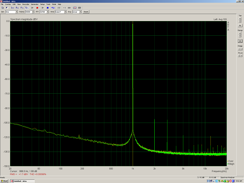

I've made loopback test for EMU 0404 soundcard.
FR curve matches very closely with what was captured from the MuMu preamp. Conclusion - RF of the preamp is flat.
Here is sound for all input configs, and loopback test metrics.
I suggest that FR and THD of the preamp are very good. Noise level (currently 78dB) and accordingly dynamic diapason may be improved.
Sorry to butt in... but comparing your loopback result with this one - they look very different... May be the settings were different? (can that happen in a loopback test?)
Yes in my loopback test there is more harmonics. I do not know why. I used simple settings: no effects, volume to the level that produces same amplitude as the original RMAA test file is. Then RMAA compared the original test file and file I've recorded.
Everything may impact sound - computer PSU, Wi-Fi router ...
