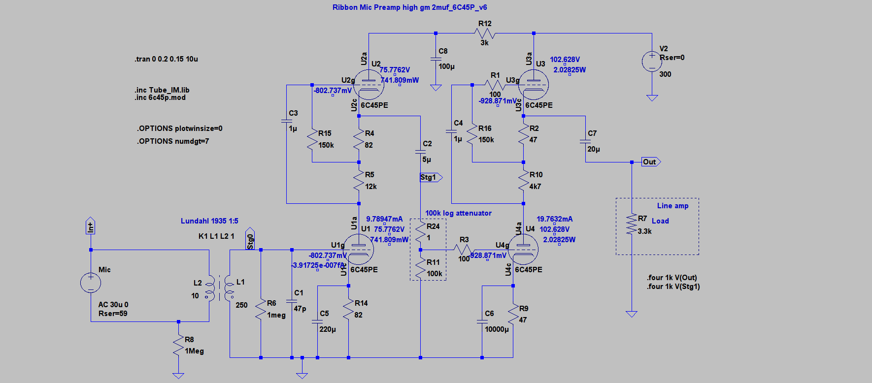

What would you say about following schema. Here are two Mu follower stages on 6C45P-E that give approximately same amount of gain ~87dB with input tranny.
Will this power fressing beast be more quiet than the previous one based on 12AX7 6N23P?
Would it make sense to reduce current through 1-st stage?
It is difficult to say if it will be quieter and if so by how much. As I said before, you probably have no more than a 6dB improvement available before you hit the laws of physics. If you believe the high mu equals less noise myth then it may well improve the noise. Certainly the 12AX7 is not the quietest tube nor is the 6922 but we are only talking a few dBs to be gained.
As I may have mentioned before, I have achieved a measured -125.5dBu EIN with a 6CG7 and my measurements indicate the 6922 is slightly quieter. There are quite a few single hi mu triodes including the relatively cheap Russian 6C3N which has a mu of 50 and a gm of 20. I recently purchased a few of these with the intention of trying them in place of a 12AX7 in one of my current preamp designs to see it there was any noise improvement but I had not yet had chance to do that.
The only way to know for sure is to get a couple of tubes and try it yourself. There is no point in doing it other than in the first stage.

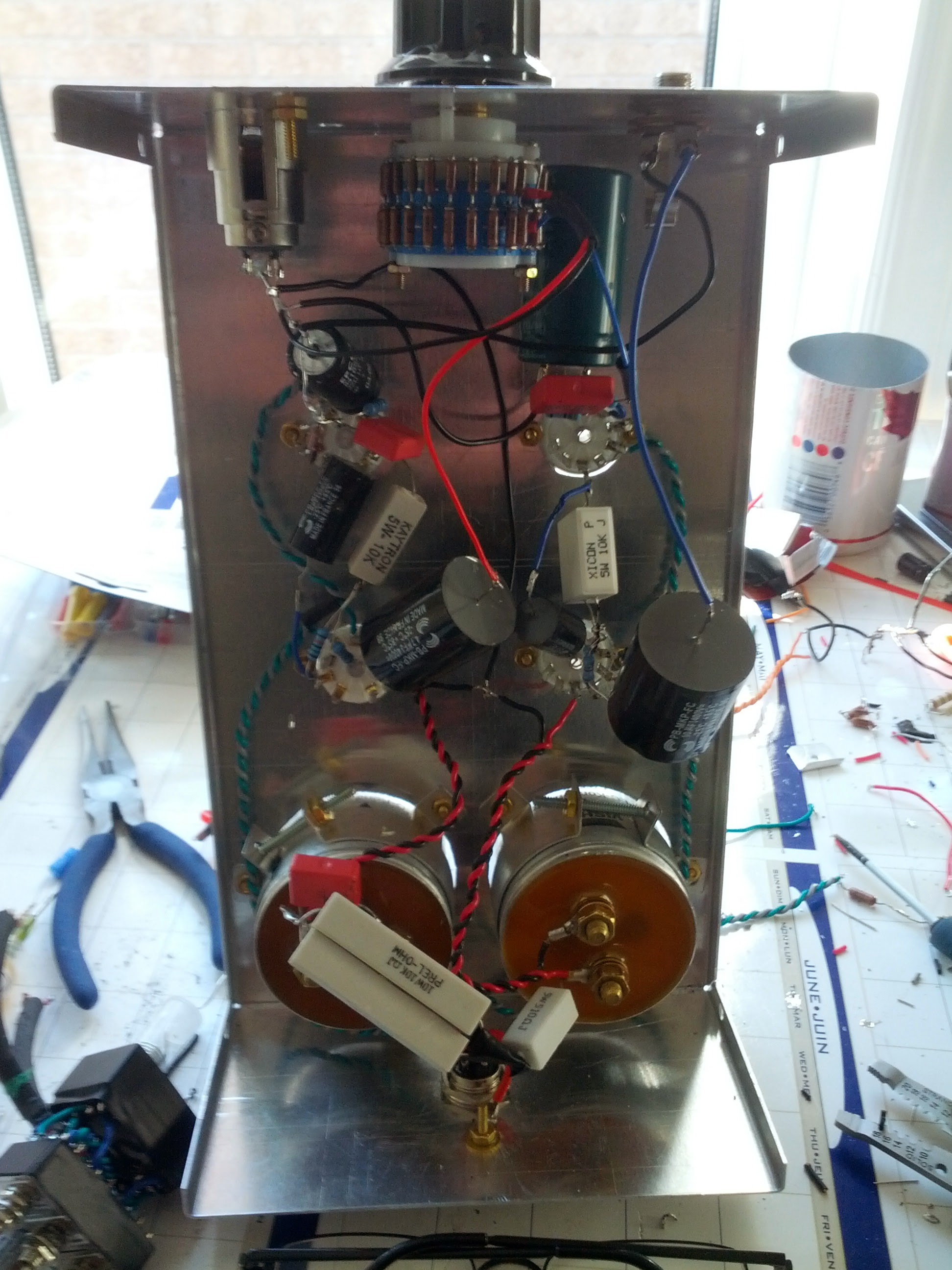

Last weeks I've got a set of 6S45P tubes and passive parts to make new preamp based on these tubes.
This time I've separated PSU and signal units. Regarding to this separation I have question. I prefer to keep electrical things safe and connected both aluminum boxes with Earth wire. So umbilical cable includes: B+, heater+, heater-, Ground and Earth.
The Earth is connected to the Earth prong of power connector, and another end is bolted to aluminum PSU chassis to its rear panel, then from this bolt, via the umbilical cable it runs to Preamp aluminum chassis, where it is bolted too to its rear panel.
Ground wires are connected star-wise with the star center attached to Ground pin of input XLR that is located on front panel of chassis. One ground "beam" wire goes back via umbilical cable into PSU, but Ground of PSU is not connected to its chassis.
I hope this is correct and should not cause buzz and hum. Am I right? Is it OK to have the Ground center on front panel and Earth on rear panel? Will it create a ground loop?

here the layout is. blue/green wires is heater, red is H+ (except attenuator), black is ground. Blue is signal.

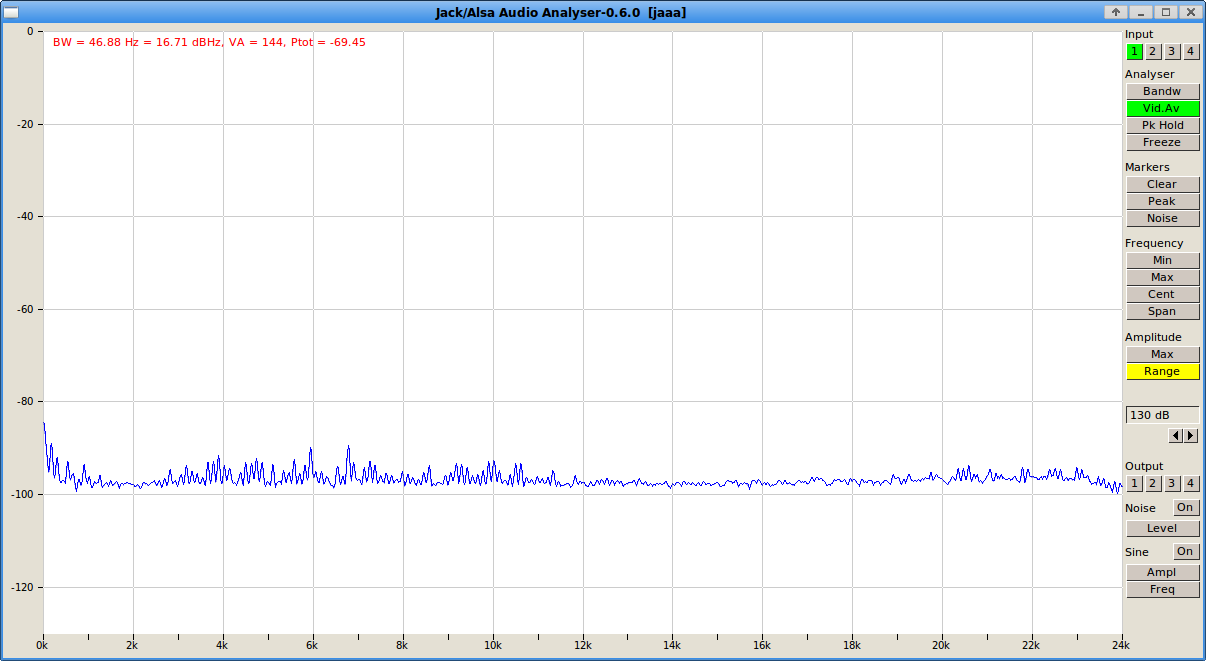

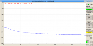

I've took noise measurements. Inserted 150R MF resistor into input XLR and measured output at different volumes.
It shows noise is less by 5 - 10dB, but is not that linear as it was with previous preamp based on 12AX7.
Here are the pictures, first is previous preamp based on 12AX7 and 6N23P. Second is this preamp based on 6S45P-E.
Is this pinkish non-linearity of noise caused by ferrite beads?

What is a risk in reducing Ia too low? Let say if it is documented that 6S45P-E min Ia is 28mA, what will happen if I set it to be 10mA, or 1mA or even less. Grid signal amplitude is very tiny in my case - +-150uV, so not much distortion is expected. I tried to reduce Ia down to 135uA in LTSpice, the simulation works perfectly well. What should happen in reality?
LOL, that web page is mine!. I had forgotten I had done that. You will have gathered from that article that as you reduce plate current, shot noise gets higher and flicker noise gets lower. In the tubes I tested , they were about equal at around 1mA. If you reduce it any further, shot noise starts to become bigger than flicker noise and the total noise increases. So there is an optimum plate current for minimum noise for a given tube.
In general there is no such thing as a minimum current for a tube and I see no reason not to run the 6S45 at 1mA. Best thing to do is build it and measure the noise at different currents. Try 1mA, 5mA and 10mA for starters.
Cheers
Ian
Cheers
Ian
