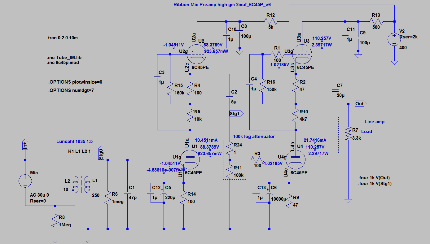

I use Lundahl LL1935 input transformer in 1:5 configuration. First tube is set to have 1Meg impedance. I tried LL1935 in 1:10 but it impacts LF and HF response.

Frank, yes the LL1935 is step down, but it can be used as SUT. This is recommend to me by Per Lundahl himself after I informed him about my setup and target.
There is already 1:37 SUT in the ribbon mic. Then from secondary of this ribbon SUT it comes to secondary of LL1935, so it works as 1:5 SUT.
Yes 1M is grid leak resistor. I read that it determines input impedance for tubes.
If it is not, could you please advise how to calculate an actual impedance.
I do not rely on numbers in data sheet, because it is most likely oriented for UHF/RF use. I just read good feedback about this tube as a low noise one.
However in my case this produces quite significant pink noise that I am trying to find how to reduce.
Here is my current schematic.

"""Then from secondary of this ribbon SUT it comes to secondary of LL1935, so it works as 1:5 SUT."""
This is wrong!
if the signal comes from a trafo ( how much is the nominal output signal?) it is balanced.
So the use of a double triode as 6922 is fine
The schematic you post is too complicated for this job, in my opinion.
Walter
Not to mention all the unnecessarily high value caps, cathode bypasses where there's little point having them, why the 3K3 load at the output, etc., etc.
Also, if the mic already contains a SET, why the second one?
The secondary windings will also need proper loading (which the manufacturer can tell you).
The log pot has a frequency dependant Zout as well and, I don't know what this will be connected to on the output end but IMO, that's where a SE OTP comes in handy.
There's work to be done, flicker noise would be the least of my worries here. Sorry Mm7.🙁

high value caps are calculated in LTSpice. Lower values shrink LF.
3K3 load at the output is impedance of my sound card (EMU0404) that this preamp will be used with.
At time when I've built the ribbon mic, I had information that 1:37 should be enough to bring ribbon level to level of dynamic mic. Then I've built preamp based on 12AX7 and found high white noise level, so I've added input SUT.
I would agree that 1:150 transformer would be better. But existing schematic works well sound-wise, except the pink noise. BTW previous one, same topology, but built on 12AX7 and 6N23P tubes did not have flicker noise.
Regarding the use of two trafo it is wrong because each one must have a proper optimal Z load.
With the configuration you are trying this aspect is not satisfied.
About the nominal output voltage is 30 microvolt at the output of ribbon?
With ratio of 37 you will have 1,1 mV at the output of the trafo.
In this case you need absolutely a Fet stage (balanced configured and battery powered) to increase minumum of 26 db (20 times ) the signal. In this case you get about 25 mV that is enough to drive a tube stage with a proper s/n.
No way to have a good results, as quality sound and s/n ratio, with a very little voltage on input of a tube stage and more is the gain more you can get a "wind" noise (white noise) at the output
With a additional fet stage ( as Schoeps and others manufact.) you will find a right solution
Walter

Anode voltages are about 100V. How to check if there is grid current? If I put 1uF on grid, it should stop grid current. So if noise will disappear it means it was caused by grid current?
Again, this traffo was recommended by Lundahl - manufacturer of both traffos 1:37 and 1:5. I've described him what I need, he recommended LL1935 in SUT config.
Even worse. 30uV is after 1:37. Ribbon itself produces 1-2uV at 60dB volume.
My challenge was to built a preamp purely on tubes.
But I probably will have to opt to this fet stage, if all other "silicone-less" methods wont help.
