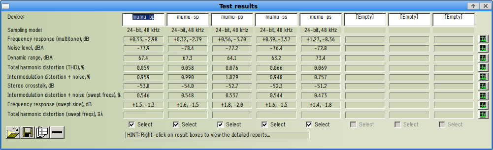

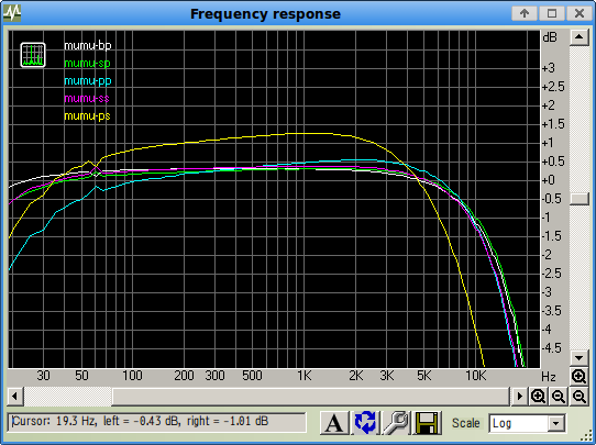

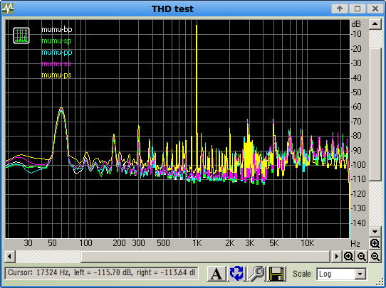

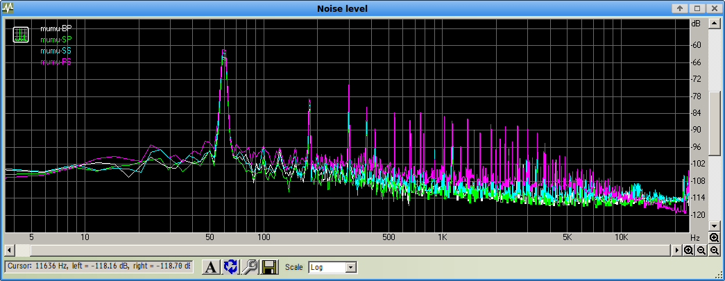

I've analyzed metrics with RightMark Audio Analyzer.
Here are metrics and graphs for different input transformer configurations.
BP - bypass transformer
SP - primary coils serial, secondary coils parallel - 1:2.5
PP - primary coils parallel, secondary coils parallel - 1:5
SS - primary coils serial, secondary coils serial - 1:5
PS - primary coils parallel, secondary coils serial - 1:10
Conclusions:
- THD 0.06% is not bad.
- Frequency Response is mediocre, and for 1:10 is poor.
- PP 1:5 should not be used. Use SS instead.
- Increasing ratio does not significantly help to reduce noise. Though I hear it reduced.
Question. Why Frequency Response rolls off after 10KHz?
Poor capacitors?
Though, wait, I did not test my sound card....

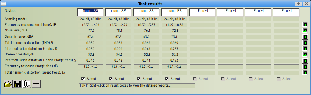

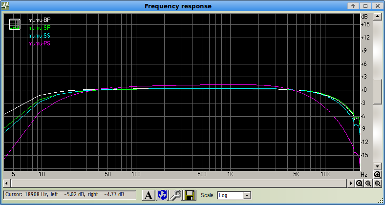

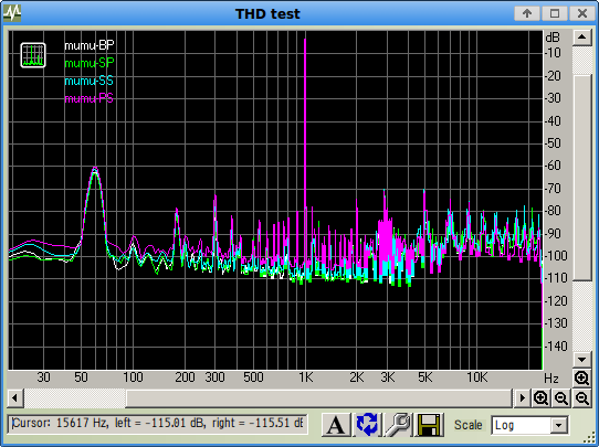

Conclusions:
Poor capacitors?
Poor capacitors?
It is called the 'Miller Effect'. Look it up on line and I think you will understand.
Cheers
Ian
I used Improved Tube models by Norman Koren.
For 12AX7 there is GP capacitance specified 2.4pF.
CGP multiplied by 100 is 240pF.
Plus CCG, 2.3P should give ~ 243pF of Miller capacitance.
If I put such cap between grid and anode of first lower tube and run analysis, HF rolls off 3dB starting from 800Hz! Given serial R of LL1935 secondary is 1300.
But without this "additional Miller" cap, HF drops 3dB at 60kHz!
Does it mean LTSpice/model calculates wrong?

Spice gets it right. The 243pF is between grid and ground not plate and grid. Basically the Miller effect multiplies the Cgp by the open loop gain (which in your case is pretty close to mu = 100) and connects it from grid to ground. I seem to remember you already have 47pF from grid to ground so you have about 300pF across the input.
However, this should not be a problem because it forms an RC network with the source impedance whic, even with a 1:10 transformer, should be no more than 15K ohms. This would have a -3dB point at about 35KHz so that does not explain the problem. For the roll off to start at 10KHz impies a much bigger source impedance or input capacitance. Are you sure the 47pF you fittted is not 470pF?

Thanks Ian! You've saved me from remodeling it to a cascode. 🙂
I am not sure today what that is, 47 or 470. It well can be. In Sayal they often misplace stuff. I'll double check.
It is mica dipped, not too big size, like 1/4". should be around 50pF.
I'll double check.
If this cap is correct one, do you have other ideas?
May be it is measuring artefact?
Did you listen recording attached previosly? Does it sound dull, or like it rolls off from 6kHz?
Thanks!
I'll double check.
Thanks!

The 3.3K input impedance of your soudn card might be an issue. The output impedance of the 6n23 stage is probably around 1.5K so 3.3K is quite a load for it. Distortion could be quite high but should be OK with a normal 10K load. Might be an idea to test it with a 10K resistor in series with the input The 10Uf output cap and the 3.3K turnover at about 5Hz (-3dB) so you will probably be 1 dB down at 10Hz. Not a problem but the phase shift might cause bass muddiness.
Any easy way to check if the 47pF is the problem is to remove it and test again.
I have not listened to the recording. I'll do that now.

I just listened to the recordings. To my ears BP sounds very dull, too much bass and not enough top. The others all sound much crisper. They certainly do NOT sound like the response drops off at 6KHz.

I've removed grid "47p" cap. I think HF improved dramatically. So it was higher capacitance. (Some issues (pf-pf) appear because of it in tranny bypass mode.)
Here are new metrics and sound.
