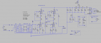

Thanks, Ian.
Is it normal? Or here is a way for improvement?
All resistors (except those in PSU) are metal film Dale, including stepped attenuator.
Tube is 12AX7 Tung Sol.
I suggest that a good input transformer 1:5 or may be 1:10 (though it is risky to loose bandwidth) should bring signal above noise.
Do you see any other measures that could be taken?

The overall noise performance is usually determined by the noise performance of the first amplifying stage. If you do not have a transformer then the first stage is the first tube. Tubes do not make good low noise first stages for this type of application. A good 1:10 input transformer will have a noise figure of about 1dB and increase your output level by 20dB without introducing much noise. Your overall S/N ratio will be much improved.

Added input transformer LL1935.
It picks up lots of buzz from PSU. When I turn off power, amp still works form reservoir caps for a minute or another. No buzz.
I've put three 4P2T switches to switch input into following configurations:
BP - bypass transformer, input goes directly to grid.
SP - transformer 1:2.5. Primary windings serial, secondary parallel.
PP - transformer 1:5. Primary windings parallel, secondary parallel.
SS - transformer 1:5. Primary windings serial, secondary serial.
PS - transformer 1:10. Primary windings parallel, secondary serial.
I compared sound in all configs with PSU turned off, to remove buzz.
Of course, BP sounds most natural, but weak and has barely audible Pf-Pf noises from cable/environment, masked by white/pink noise.
SP sounds very natural, no Pf-Pf noise.
PP and SS, sounds a little bit dry.
PS is hot, but sounds more dry. LF is impacted, but still can be used for some applications, where bass should be suppressed.
Each config allowed me to reduce volume 2 clicks (my log attenuator has 22 clicks), that audible reduced noise.
Conclusion - transformer helps but most likely will require to separate PSU from preamp completely, because input transformer and switches pick up buzz from mains transformer. I'll try to wrap input transformer and switches into aluminum box, but have little hope that it will help.

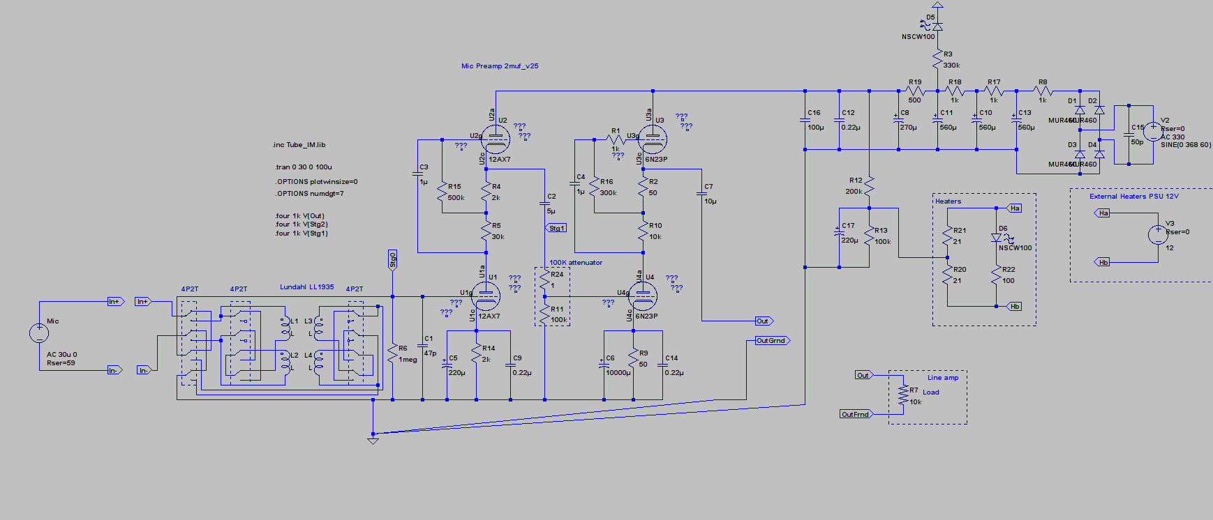

I've measured resistance of coils of the LL1935. That was a mistake. Mu-metal core has permanently magnetized. I need to demagnetize it now.
Actually, after reviewing the wiring, I've found that I've wired wrong polarity for coils so they worked counter-phase. LL1935 has unusual pinout for coils: +- -+. I've wired it as +-+- by mistake.
That is why sound was so dry, LF was simply cancelled.
Now there is lots of LF. And buzz has disappeared as well. I think now buzz is cancelled.

Oh wow, these are great findings. That sounded so much more amazing now that the problem has been rooted.
How do you know that you saturated the core though? Also, how would you degauss a delicate one like this
Also, do you have an updated schematic?

I have couple of schematics with and without PSU, with and without the input transformer.
I'll update one and publish soon. But there are no major changes in preamp core.

Here is the current schematic.
It shows ~ -105 dB noise when volume is on 16 click of 22-click log attenuator.
With mic plugged in noise is around -80 dB - I think these are environmental acoustic noises, mainly from my computer.
Some notes:
All resistors are metal film 0.25W, except
R10, R8 - 10W
R19,R18,R17 - 5W
R20,R21 - are tube heaters.
All capacitors must be at least 400V except C5,C9,C6,C14.
C3,C2,C4,C7,C9,C14,C12 - film caps
C16 - I use PP motor run capacitor to bypass reservoir electrolitics.
PSU for heaters is external. It can be any type, 12V, >=2A. I use switching mode one.
Feeding heaters from same transformer as H+ pollutes H+ with buzz.
Placing a second transformer for heaters inside preamp box radiates buzz as well.
So I decided to make it completely external and remote.
Turn On procedure: turn heaters on first, wait 10 sec, turn B+ on.
Turn Off procedure: turn B+ off, wait until D5 becomes dull, turn heaters off.
WARNING!
RESERVOIR CAPACITORS KEEP VERY HIGH VOLTAGE FOR DOSENS OF MINUTES AFTER THE DEVICE IS TURNED OFF.
C3, C4, C2 AND C5 CAPACITORS CAN KEEP HIGH VOLTAGE FOR MANY HOURS.
DO NOT TOUCH PARTS UNLESS YOU KNOW WHAT YOU ARE DOING!
Elevation voltage 100V goes into the external heaters PSU.
TREAT HEATERS PSU, ITS CABLE AND CONNECTOR AS HIGH VOLTAGE - IT DOES CARRY HIGH VOLTAGE!
LED D5 lits when high voltage is in reservoir capacitors.
DO NOT TOUCH HEATERS CONNECTOR UNTIL THIS LED IS COMPLETELY OFF!
The amplifier is designed specifically for ribbon microphones.
It has very high input impedance - 1M Ohm (set by R6).
This allows to decrease damping of the ribbon in microphone.
But dynamic mics work well with it too.
R10, R8 - 10W
R19,R18,R17 - 5W
WARNING!
