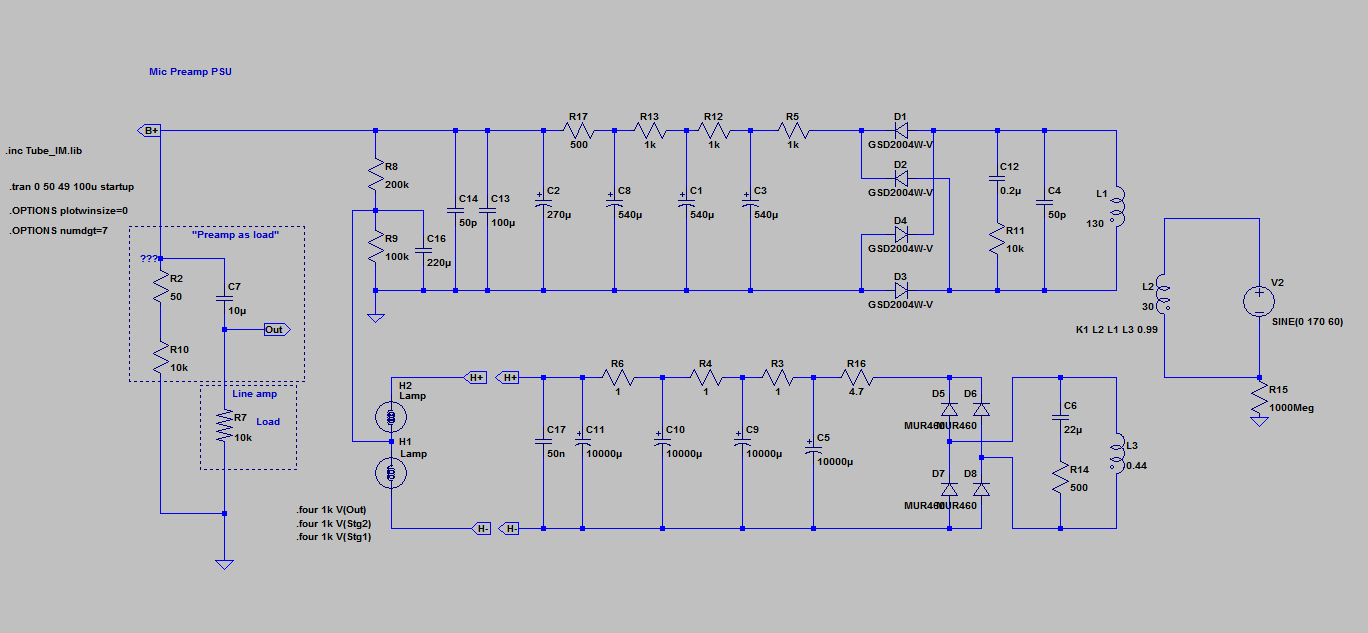

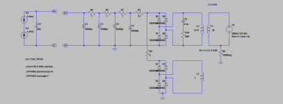

Why? What is wrong with following schematic?
If buzz occurs as soon as the DC heater supply has a load attached then you have coupling between the heater supply and the main circuit. This could be via wiring or via the mains transformer. You could try a choke input heater supply, as this will reduce charging pulses. The choke may be big, though!
There is coupling of course - heaters are elevated +90V from B+ via voltage divider 200K -- ( 100K || 220uF). BTW before I added that 220uF cap there was lots of buzz. But adding more capacitance here does not reduce it anymore.

If that circuit is what you have built, then one of the secondaries does no work as the other secondary will always present a higher voltage and so reverse bias the diodes from the first secondary.
You may have actually built it with R6 connected to the other end of R2 (top of C5). In this case R2 and R6 acts as current steering resistors or ballasts so both secondaries may contribute provided their voltage difference is not too great.
You may be injecting buzz into a ground. DC PSUs should always be grounded (i.e. connected to circuit ground) at their output end, not partway through as your diagram shows. That is, ground should be at C2, not C9.
That ground at C9 is just for LTSpice.
Actually in real heaters circuit there is no ground anywhere. It is somewhat floating being elevated.
Though it is couples with ground indirectly via elevation chain (voltage divider), via lower R9 and C16 of the voltage divider. Look at following schematic that reflects current state.

OK. If you apply a DC load to the heater supply, but with the heater supply disconnected from the potential divider do you still get buzz? You need to find what the coupling mechanism is: common ground currents, wiring magnetic induction, transformer interwinding capacitance etc.
A power transformer will make a poor choke because it cannot handle DC. You could rebuild it with an air gap.

... DC PSUs should always be grounded (i.e. connected to circuit ground) at their output end, not partway through as your diagram shows. That is, ground should be at C2, not C9.
This is right. Two comments.
1) is the ground is just to make Spice happy then place a 100M or even 1G resister in series with the ground. That will tell everyone to ignore the ground.
2) As said above the physical layout really does matter and I suspect some of the noise may be a result of things we just can NOT see in a schematic diagram. In fact coupling almost by definition takes place via paths that are not shown in the schematic.

DF96>OK. If you apply a DC load to the heater supply, but with the heater supply disconnected from the potential divider do you still get buzz?
The elevator was connected to heaters.
When I've tested with battery heating, the elevator was connected through heaters to battery. No touch with heater supply.
When I've test with PS heating, the elevator was connected through heaters to PS. If I disconnect it, buzz gets loud.
DF96>You need to find what the coupling mechanism is: common ground currents, wiring magnetic induction, transformer interwinding capacitance etc.

But what affects buzz is a load in heater circuit. If there is no load - no buzz. If there is load - buzz, even when heaters feed from a battery.
I've measured there is 300mA current between rectifier and first resistor. It is less than specified 1.5A.

This is good information. It seems that if the diodes in the heater DC supply are switching then you get the buzz. Even if the supply is not supplying the heaters.
The only way I can think the heater supply rectifier can be causing this is if the coupling is via the power transformer. The switching noise is coupling either magnetically or capastivily through the PT.
I heard of people having trouble with DC heaters. The DC current is AVERAGE only 300ma but the diodes conduct for only (lets just say 1/100th of the time because your resivour cap is so huge) This means that while the average is 300ma the current goes for zero to 30 amps then back to zero. Yes is might be that large, you need an o'scope to see the conduction angle.
Had you tried an AC heater the current would be drawn from the transformer in much smoother way, certainly not as huge 30A spikes.
What to do? I'm guessing here but a smaller resfilter cap, perhaps 10uf or 22uf would cause the diodes to conduct over much of the AC cycle and stretch out the current spikes. Filter the DC with a second RC stage. I bet you'd get the same effect with a larger size (1K ??) resister in series with the transformer's heater secondary. Anything so the diodes will stay "on" for most of the AC cycle.
Or what the heck, just try using 6.3V AC heaters and see what happens. Yes, elevate it up a few volts with the voltage dividers. Just mack sure the rectifier is disconnected. If going AC helps you have found the problem.
One very good solution is to get a separate heater transformer then there is no way for the heater an B+ supplies to couple.
That is why I put 8.4R before the first capacitor. This reduces current to 0.5A pikes. And the more resistance I put the less buzz is. But I cannot put here to high R because voltage will drop too much.

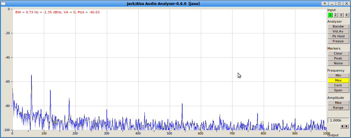

Here is AC buzz/hum spectrum.
60Hz is louder, but higher harmonics are quieter, which sounds better for ears.
I think now it is absolutely certain what the cause of this buzz is.

What I've got from the AC experiment that even a large "ripple", which the 12V AC is, does not cause very loud hum when applied to upper tube's heaters that are 40V negatively "elevated". So DC with some mV ripple should be fine.
What creates buzz is some internal inductive coupling in the transformer. Or EMI from (over)loaded transformer? Not too much sure. I know if it is unloaded it does not buzz.

Tried with wall wart 12V. Buzz/hum is not audible.
On spectrogram it does not go higher then hiss.

I plugged output into sound card E-MU 0404. And analyzed captured signal with Jack Audio Analyzer.
If you take a look at above post #351 you will see screenshot of the tool.
Currently I do not have buzz spikes. Hiss is on same place.
If I speak loudly or yell signal goes up to -20dB.

OK, that signal is the noise spectrum. It is not easy to work out the noise over the entire bandwidth from that spectrum. Just about all it is safe to say is that the noise level is not -90 to -100dB. If and its a big if, that spectrum show the noise per root Hertz, then to find the noise level over the entire bandwidth (such as you might read on a meter connected to the output) you need to multiply by the square root of the bandwidth. The square root of 20,000 is 141 which, converted to dB is 43dB. So, given the above assumption about the spectrum, then if the noise bumps along at -100dBu then the actaul noise over the whole 20KHz bandwidth is 43dB higher than this i.e. -57dBu
